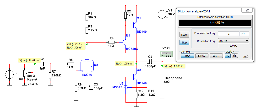

Tube voltage amp + Transistor buffer at 30V supply

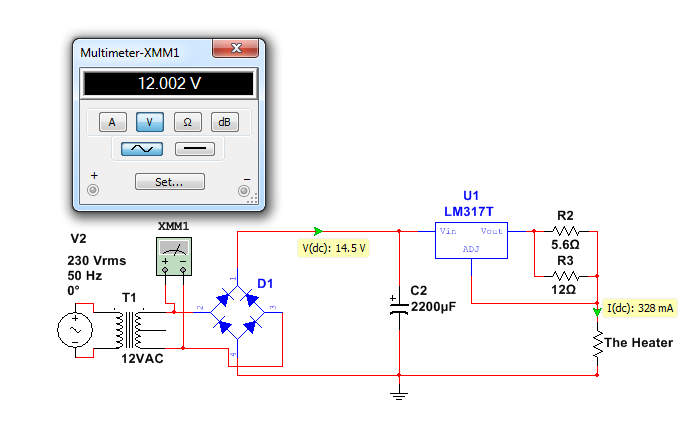

Supply.
Transformator 30VAC or 2x15VAC.
Voltage regulator LM317T (see image) for 30VDC output.

The circuit.
The tube can be ECC86 or 6GM8 or 6N27P.
The voltage gain is like x11.6.
The output buffer is providing like 105mA.
This is done by using a LM334Z current source.
The input and output capacitors should be of good quality.
This circuit is done for 32 Ohms headphone.
Can be used of other headphones, but I have 32 Ohm headphone.

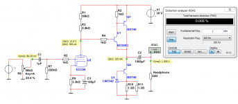

The circuit.
Can this circuit works as a preamplifier ?
