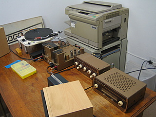

I called myself a "Tube Virgin" but it's not quite that bad😉 Here's some of my Leak things, set up for a "do" last weekend when my engineering society had an "open day" for the general public.
