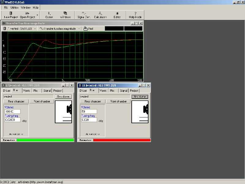

I'm thinking of migrating my Peerless 10" XLS woofer and plate amp currently in a Formatube (sonatube) ported "box" into a nicely veneered standard MDF cabinet. Volume about 59 litres with single port tuned to 28 Hz
Heres the plots from WinISD, obviously the 28 Hx is offset because it's a higher feq than current. Can anyone cast futher wisdom/meaning on these plots as I'm afraid my knowledge in reading them is Zero.

Basically, if you keep the same enclosure volume and tuning the sub should sound the same in either enclosure. That is assuming that both enclosures are built with the same quality of construction. Looking at the plots, the higher they go on the y axis, the higher the SPL. The farther left they go on the X axis, the lower in frequency, the farther right, the higher the frequency. WinISD gives anechoic FR response. This means that it is a predicted response of the speaker in a completely non reflective sound environment. An example of this would be, if outer space were air, then the sub would be positioned in the middle of nowhere in outer space such that the sound would only travel away from the speaker and never back to it from reflection. In room response gives a boost of low frequencys due to there being reflections. Car cabin gain is an even higher boost. I'm assuming your using the sub for home audio correct? Looking at the response curves on WinISD I'd say your box is too big for the sub. I'm using the pre-entered WinISD specs for the sub, but an EBS alignment uses 23.9L@ 31.7hz for -3db shelf and 35.24L@ 22.3hz for the -6db shelf. I'd go with one of those two alignments. The 59L @ 28hz will give you a rather large dip at 45hz and a peak at 28hz. That might be rather boomy
BassAwdyO said:Basically, if you keep the same enclosure volume and tuning the sub should sound the same in either enclosure. That is assuming that both enclosures are built with the same quality of construction. Looking at the plots, the higher they go on the y axis,....................or the sub. I'm using the pre-entered WinISD specs for the sub, but an EBS alignment uses 23.9L@ 31.7hz for -3db shelf and 35.24L@ 22.3hz for the -6db shelf. I'd go with one of those two alignments. The 59L @ 28hz will give you a rather large dip at 45hz and a peak at 28hz. That might be rather boomy

When you talk about a "shelf" I'm assuming thats the leveling out of the curve after the main incline?
I think I'll go for the 35.24L @ 22.3Hz as this new set up is to augment my new Thor TL and so do not need vast SPL's.

Yes, the EBS (extended bass shelf) alignment is defined by the leveling of the curve before the rolloff below enclosure tuning. The older versions of WinISD didnt come with standard preset alignments, but the newer versions will automatically calculate 5 popular alignments. Two of these are EBS alignments, one being a -3db shelf and the other a -6db shelf. You can achieve a shelf at any level if you change the box volume and tuning frequency to the right values. How do you wish to augment the Thor?

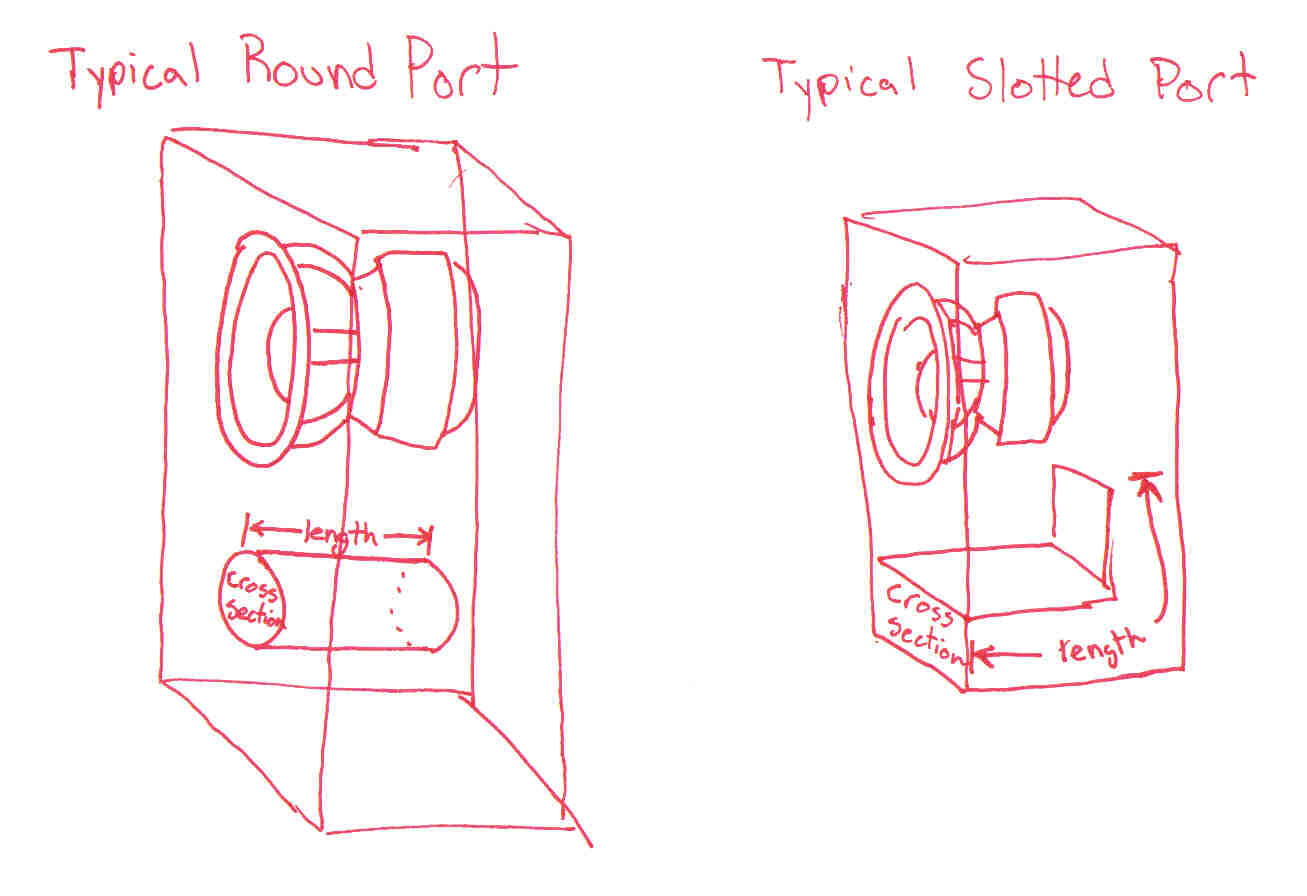

No problem, the sub looks good. I took a look at the pictures of it and the formatube sub and I was wondering where the port exits were on the formatube sub? The port you used on the MDF sub seems to be pretty small in diameter. Port chuffing near resonance might occur if the ends arent rounded and flanged. Because port length gets so long for small boxes when an appropriate cross section is used typically slotted type ports are used and the port wraps around the box.
Yes, see what you mean .. the fabric cover hides 2 port outlets on bottem to one edge of the woofer on the Formatube version.
Yes I was a bit worried re port diameter of 50mm and possible air velocity noise - but haven't noticed anything on current brief listening. That was a consequence of me keeping the footprint probably too small.
Could you give me an example of "slotted type" ports??
I've attached a picture showing the difference. Basically the tuning of the box is dependant on 3 measures.
1. Box volume - AIR volume in the box (doen't include port volume)
2. Port cross section - Area of cross section
3. Port length - Length of port (including end correction)
When I started in DIY audio I though tuning had something to do with the driver, but this is wrong. The box is tuned to a specific frequency regardless of what driver is used. The curves you see on WinISD represent how the driver does in a specific box size and tuning frequency. With different box sizes and tuning frequencys the driver is damped more/less to achieve a specific response curve. The relationship of the 3 factors are as follows.
If box volume and tuning frequency are constant then:
If cross section increses, port length increases
If cross section decreses, port length decreses
If port cross section and length are constant then:
If box volume increses, tuning frequeny decreses
If box volume decreases, tuning frequency increases
Other relationships can be made, but those should give you the basic idea how the enclosure works. The difference between slot ports and round ports are only shape. They both have a specific cross section and length which along with enclosure volume determine tuning frequency. The advantage to slot ports is simply the ability to build a long slot port that bends to fit inside the box. This allows a smaller enclosure to have a low tuning frequency without comprimising the cross section of the port. The only other alternative, Passive radiators...
