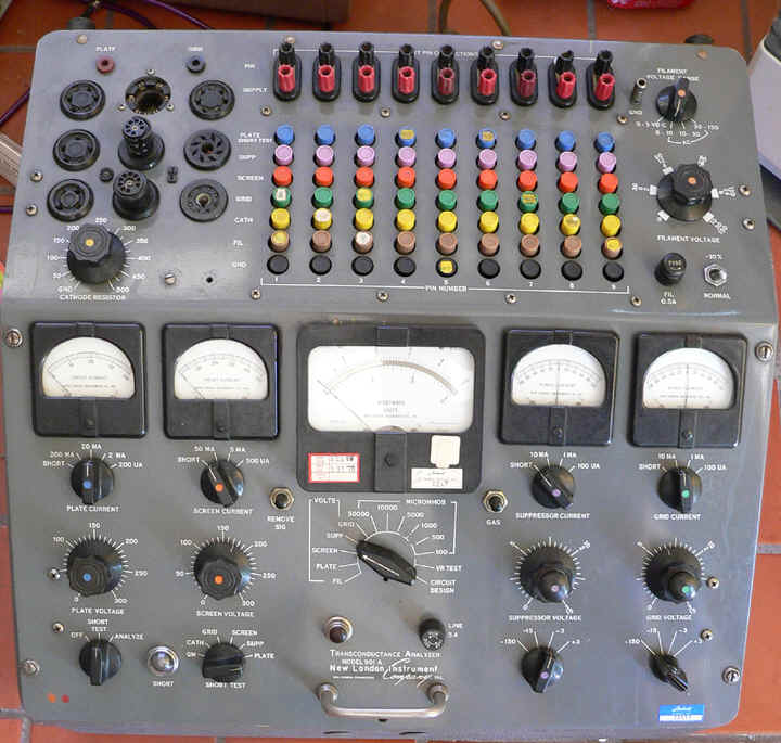

This is true, but they're not supposed to. They're designed as a screen to weed out the probably good from the definitely bad. To test under more stringent real working conditions, you need what's generally refered to as a tube analyzer. These include the RCA WT-100A, Daystrom/Weston CA-1630 and the New London 901A seen below. Hickok also made one but I forget the model.
The TV-7 is certainly not in this category, and is one of my least favorite testers. I've owned and used many different testers over the years. For some dumb reason the TV-7 has obtained cult status. Probably because it's small and military. My personal favorite is the Hickok USM-118B military cardmatic because it's very fast, durable and stays in cal for a long time.

Hi Hollowstate,
That New London 901A looks very interesting. I imagine it is pretty rare. I'll have to keep my eyes open at the next few hamfests I attend. Who Knows? Thanks for posting it. 😀
