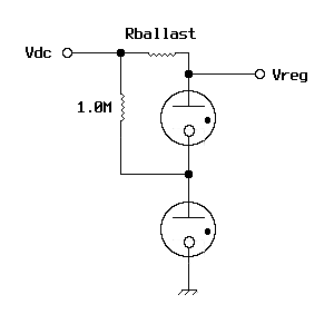

When putting gas regulators in series you may have to think about how to provide the starting voltage. Until one fires, each is effectively open circuit so the other sees little or no voltage. You can do clever things with a silicon diode and a couple of high value resistors so the regs are effectively in parallel before firing and in series after firing. I saw this on the web somewhere some years ago, but I can't remember where.

1. You will need a shunt resistance in parallel with one of a series pair, to ensure the other one starts, which will then start the shunted one.
Agreed, this was addressed in the schematic above with a high value resistor across one of the regs. Consistent and reliable striking.

No, not at all. Just make sure you include a 1.0M resistor between the DC rail and the bottom VRT. This will ensure that both strike.

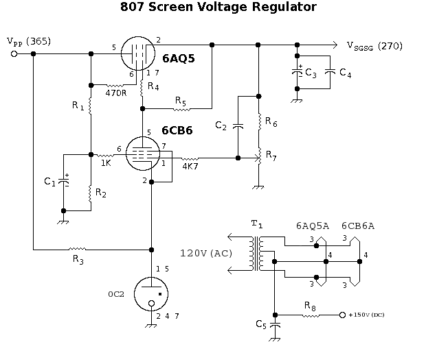

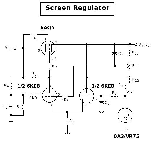

I've used hollow state active regulators as screen supplies, in two different topologies. Both are excellent performers.
I have read other discussions on how the gas regulators can be noisy, probably not the best idea when making a phono preamp. I see ZigZagflux you have been using them in a power amp so the noise isn't going to be as much of an issue. I will make note that a high value resistor is needed to strike one of the gas regulators when using them in series. I also noted that you have one .047uF cap across both regulators, datasheet says .1uF max. Makes sense, a .1uF cap across each regulator in series equals .05uF per. Maybe my next power amp i can use some for screen regulation.
I will most likely just use a SS regulator. Really the only reason for using the OD3 was because I thought they look cool.
