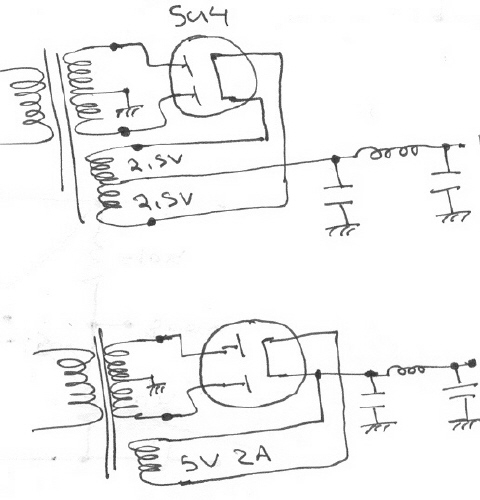

The cathode in the 5U4 and similar rectifier tubes is a resistor end to end. If you pull the DC output from the tube out of one end of the cathode the most cathode emission will be concentrated on the end of the cathode you are using as the output. Over time the cathode will wear out faster because the other end of it will not be stressed as highly and the emissive layer coating will still be fresher than the side that was connected to the load. By using a center tapped filament transformer more equal cathode loading is achieved and longer tube life is the result. The center tapped filament winding costs more money to make the transformer so it is seen less often in consumer gear.

thank you for detailed explanation.So go with CT filament winding!
Is there any voltage dropped at the filament winding?It's like a choke.
But with 5 - 10 turns of wire (I guess) there's not too much resistance,right?

Voltage drop in the filament transformer winding to the B+ will be so small as to be almost immeasureable in any practical sense of the term.
I'm building a preamp and a phono right,now.I like to use tube rectifiers and Shindo style filtering.So, I'll try this CT technique.

Hi Resident,
I like CT shematics but have some douts here. DC current
will flow through the trans coil and it will not be substituted.
Power trans does not have a gap, you know. So. with big current
you can get distortions which hardly smoothing in filter.
Igor.

Konnichiwa,
The current will flow equally but it will flow in opposite directions through the heater winding halves, so it is cancelled

Directions opposite - thats right. But phases different.
Current flows by pulses one polarity in different time intervals.
Would they be different polarity you'd be right.
May be (even sure that not) it is not so important, but I have
some doubts about it. 🙂 It was such a question.
Konnichiwa,
Look at it again. No matter how you resolve it, averaged over one full cycle of the mains the net of all currents is zero, nothing remains, so no problem.
