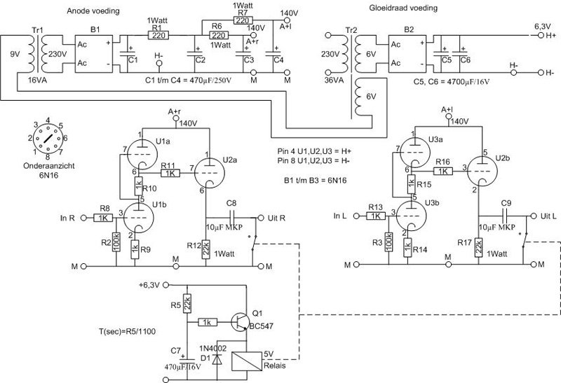

Tube preamps will have a difficult time driving 3k with low distortion. The preamp's output impedance should
be under 500R,and also the output capacitor will have to be at least 10uF. You may also need output muting,
to protect the input circuit of the amplifier. Maybe look at some tube headphone amplifier circuits for ideas.

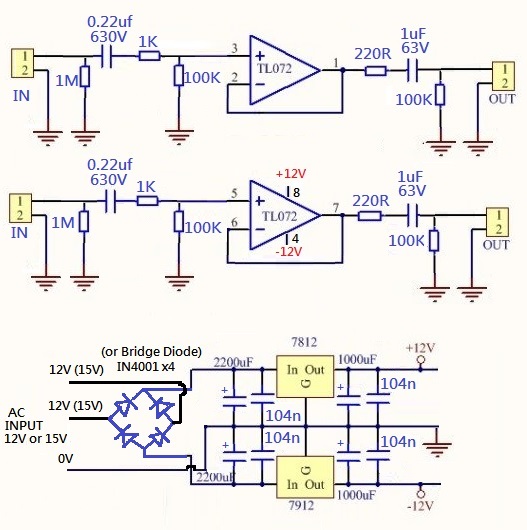

You can add a FET input opamp buffer (like TL072, OPA2604) between the tube amp and the ICE Power amp to match the impedance.
So I actually have a few TL072CPs sitting around...given my current tube preamp output impedance and signal amplitude, could you recommend a simple setup for the op-amp? I’ve actually never worked with or designed around them before (typically only tube) so if you could give me the simplest operating setup just to get going I would really appreciate it. Thanks!
That amp is unusual for a SS amp, normally input impedances are expected to be 50k, sometimes lower, down to around 10k.
You need a buffer with a high input impedance, and if the buffer is solid state it needs protection from input over-voltage in your setup.
You can try this circuit.
If you sure your tube pre-amp output cap is good enough then you can remove the 0.22uF/630V caps and replace them by 100R resistors.
For the power supply, the circuit runs at low current so that you can use simple zener diodes voltage regulation for the +-12V supply.

I don't have my calc handy, but with a 2.8K input R for the amp, a 1uf coupling cap is going to have a cutoff of 1/1ufx2.8K around 350Hz. Probably needs to be closer to 100uF. I'd check if the amp already has a coupling cap and if it does, just remove this one. Also if it really takes 10VAC(rms?) to drive the amp to full power, 12V p/s is not enough (10x1.414). I'd think you'd need to go to 18V if you can, to have 3V of rail to peak output voltage.
Koifarm is correct. Forgot the 2pi factor in the frequency. :ashamed:
Cutoff with 1uf is 57hz use 4,7 or 10uf
Yes, they are correct, in order to drive the ICE Power Module, please adjust the output cap and higher power supply voltage.
