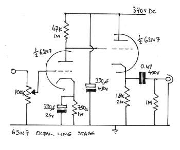

I've built a tube pre-amp using 2 6sn7gts. I'm facing a very big problem now and hope that someone out there can help me. My pre-amp will come out humming aound, and have tried a lot of methods, but still there the humming. Can anyone tell me how to solve it?
Do you use DC for the filament? Also, you need to raise the potential filament supply to approximately 80-100V in case the last stage is a cathode follower.
Of course, the ripple level of the B+ could induce in lot of hum as well.
Please post your schematic and picture of your amp so that we could find whether there are anything we could see.

Thanks all of you. I've tried everything I could to reduce the hum, but the hum still there. From voltages to ground looping, everything I've tried. First I thought It was bacause the heater voltage. But after some modification, the hum only reduce a little bit, the hum is still there. I've attached the schematic, hope you all can help me. Thank you.

Schematic? Sometimes when you attach a file and 'preview' before sending you need to re-attach the file before sending.
if that's what happened.
