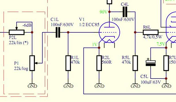

OK now down to the nitty-gritty... I have attached a part-circuit of just what I have at present and this amplifier is for CD input only at present. The input tube is a single ECC83 ( 1/2 per channel ), driving a single 6V6 in Class A mode. I am using a single 50K log pot on the input at this stage.
What I imagine for the additional PHONO input is that I would have to use a full ECC83 per channel now, to get more gain for the phono input. The cartridge output requires 47K impedence and has an output of 4.5mV. ..... 2 RCA inputs with a switch between 'CD' and 'Phono' would be my idea ????
Any help with a SIMPLE circuit would be very much appreciated and I look forward to hearing form anyone that is willing to help....

I'd suggest that you'll rename this thread, or start a new one, titled: "Looking for a phono stage". Better still, search this forum for "phono stage". There have been quite a few threads on the subject. Basically an independent phono stage should work properly with any pre-amp.

It's not as simple as just adding one stage to get more gain. A phono stage requires certain equalization as well, and usually two tube stages are used. Further, there are two general ways to do that equalization -- passive (lossy network) and active (network in a feedback loop). The output of a typical phono stage feeds a line-level input, so you basically need two tube stages (could be one tube, such as a 12AX7/ECC83) ahead of your existing preamp.
I threw together a pretty-good-sounding phono pre using a 6BH6 pentode and a 6GH8 pentode-triode tube (both fairly cheap tubes to obtain, versus a 12AX7 which can be spendy). It's set up for standard RIAA EQ plus settings for 78-rpm records.

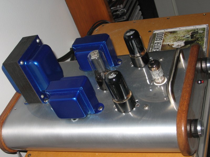

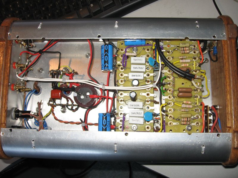

Attached is a pic of the little amp as I have it now, suppose there is much that is not totally correct 🙄 😕.... But in the end it does sound great on CD, but as requested... A bit of CD AND MM Phono would really be nice....

That's a nice looking little amp! I like its rounded edges style.
I'm no expert (far from it), but maybe that's a good thing for the purpose here. It's not easy to make a tube-based RIAA preamp that's quiet enough to be really enjoyable, and I'm sure it would be especially difficult to incorporate an RIAA preamp into an already existing amplifier. If the RIAA preamp has its own power supply and chassis, it will keep the noise that comes from the bigger amp's power transformer and higher current output tubes away from the very low level phono signals.
You might consider constructing something very simple and easy to pull off, but that still performs well. Eli Duttman gussied up the old RCA RIAA preamp circuit. That uses one 12AX7 tube per channel. I think you can get good 12AX7's for $10 or less each. http://www.diyaudio.com/forums/tubes-valves/190233-tube-riaa-something-easy.html#post2595174 -- The advantage of a 12AX7-based circuit is that it will draw little current, so a very small (and inexpensive) power supply is all that is necessary.
I built a stock RCA RIAA preamp years ago, except that I added a 12AT7 cathode follower to its output. My brother still uses it. It sounds very nice, sort of "vintage" warm, but cleaner. It's quite enjoyable.
There's a similar circuit that uses 6DJ8 (ECC88) instead of 12AX7, by RJM Audio. RJM Audio - Tube passive phono preamplifier -- That one is also very simple. You could replace the 500R resistors and 100uF 10V capacitors in the 6DJ8 cathodes with a red LED and 1N4148 diode in series to get the +2.5V cathode voltage. This circuit will require a higher current power supply than the 12AX7 one will.
I'm sure you'll get lots more ideas from others. You have a lot of options to choose from.
