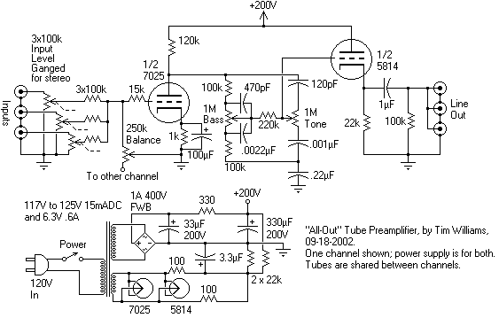

Skip a kit and build mine for $50. 😀
Tim
