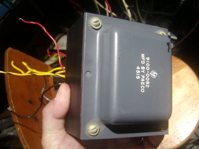

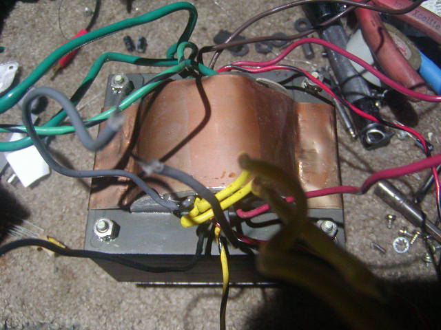

I have a HP/PAECO 9100-0082, 4515 Power transformer that I would like to know what the leads are before hooking it up to a variac to test. I can't seem to find a source of HP/PAECO transformer information.
Leads as follows
2) green 1) green/blk, 2) brown, 1) Red, 1) red/blk, 1) red, 1 red/yellow
1 blk, 2)gray
15 leads total.
I assume the green are for the 6.3 volt taps. The Yellow for 5 volt?

HP-738AR
This transformer was used in HP's 738AR Voltmeter Calibrator. The schematic for the transformer and lead identification is on page 23 at T1, T1 in the parts list on page 32 is labeled as 9100-0082.
Here is the link http://hparchive.com/Manuals/HP-738AR-Manual-sn-001.pdf
