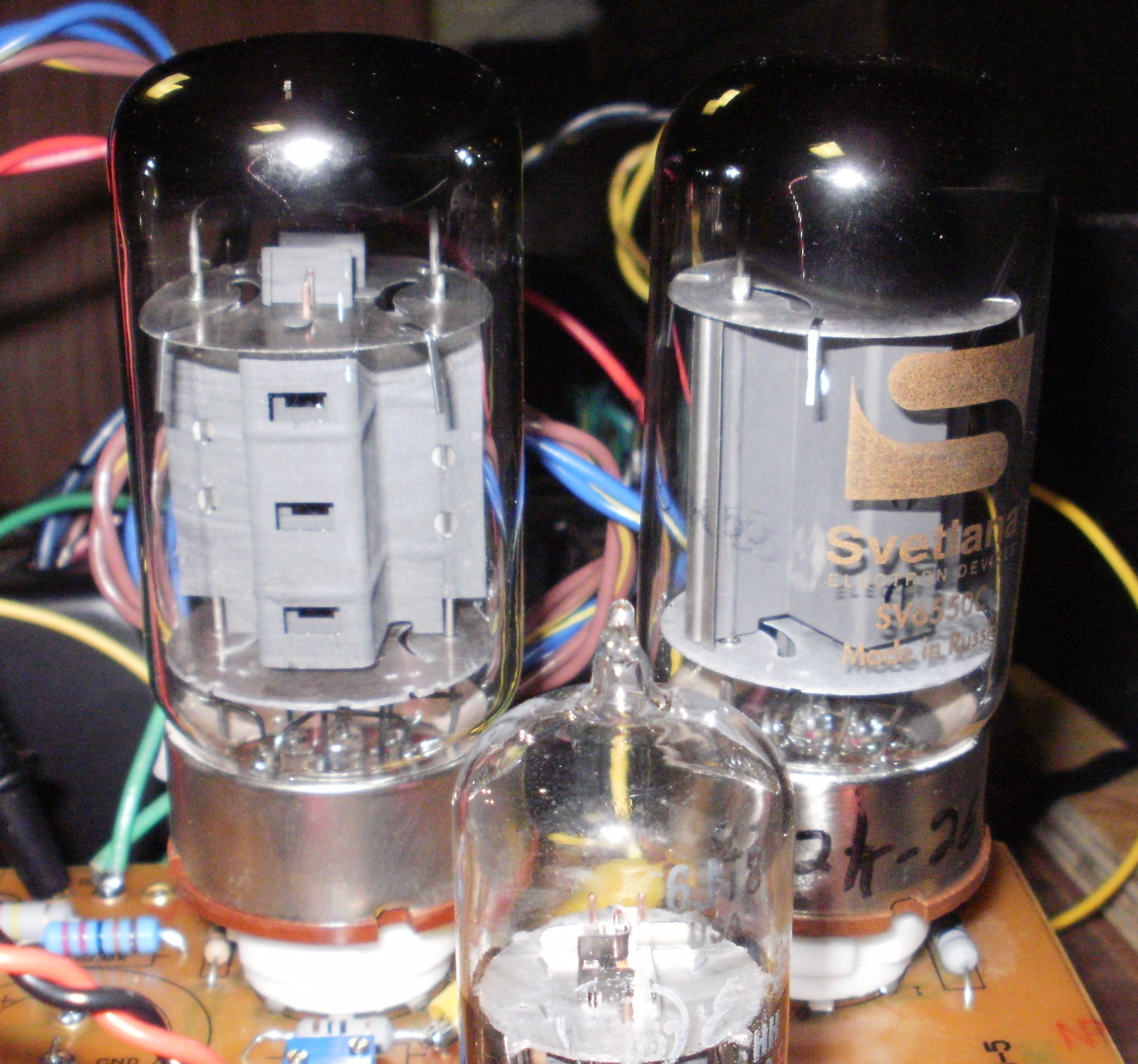

The KEG-EAR Amp PCB was designed for the newer Svet 6550's and I found a set of older Svet 6550 that the plates were rotated about 15 deg. Still looked OK but was missing the glow through the plate holes from the front. Currently running the newer ones, holding the older set for spares...
