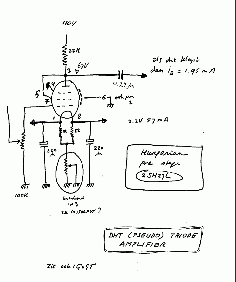

Some projects with 2SH27L (=2J27L)
Dear Matthias and others,
As promised I'll start here with links to some projects on the web using the Russian battery valve 2SH27L (=2J27L).
First, a link to a nice collection of datasheets for this tube, with a translation of the Russian text into German:
http://www.fragjanzuerst.de/rb/2SH27L.pdf
Then, four links to various receiver projects (mainly "audion" receivers, in other words, simple "straight" receiver designs):
http://www.jogis-roehrenbude.de/Leserbriefe/Burkhards-2SH27L-Radio/Tetroden-Audion.htm
http://www.jogis-roehrenbude.de/Leserbriefe/Negadyn_Weiss/Negadyn.htm
http://www.mydarc.de/dk3wi/html/mw-audion_mit_2sh27l_und_18v_a.html
http://www.jogis-roehrenbude.de/Leserbriefe/2,4-Volt-Audion/Audion2V4.htm
A link showing some simple oscillators:
http://www.elexs.de/roe2SH27L.htm
Finally, some amplifier designs.
A single-ended power amplifier from Hungary with 2SH27L and 4P1L: http://www.jgytf.u-szeged.hu/~kadar/projects/amp/4p1l/page_01.htm
And a push-pull amplifier from Germany with twenty-two 2SH27L tubes ! : http://www.jogis-roehrenbude.de/Leserbriefe/Vico-22-Roehren-Amp/Beschreibung.htm
I have built and tested a preamp stage with the 2SH27L based on the previously mentioned schematic from Hungary (University of Szeged), it works very well. I add a hand-drawn schematic, please note that the cathode resistor is a 2k Cermet trimpot. This should be adjusted in such a way that the anode voltage is 67 V (= the anode current is 2 mA).
Hopefully these hyperlinks will be copied properly to the diyaudio forum, and the handdrawn schematic will be readable.
Best regards,
Aren van Waarde
aka arensattic
