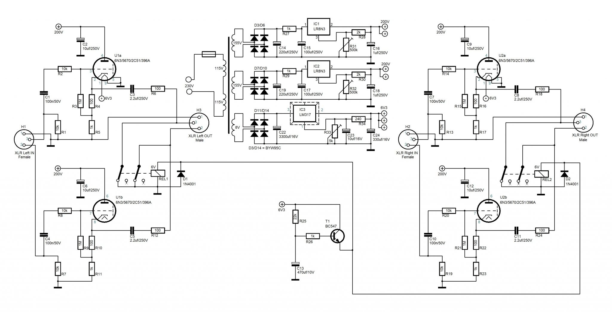

Class D amps were the tube buffer replace the first opampstage are a good solution. Often they use Class D amp(Oem) without opampbuffer.

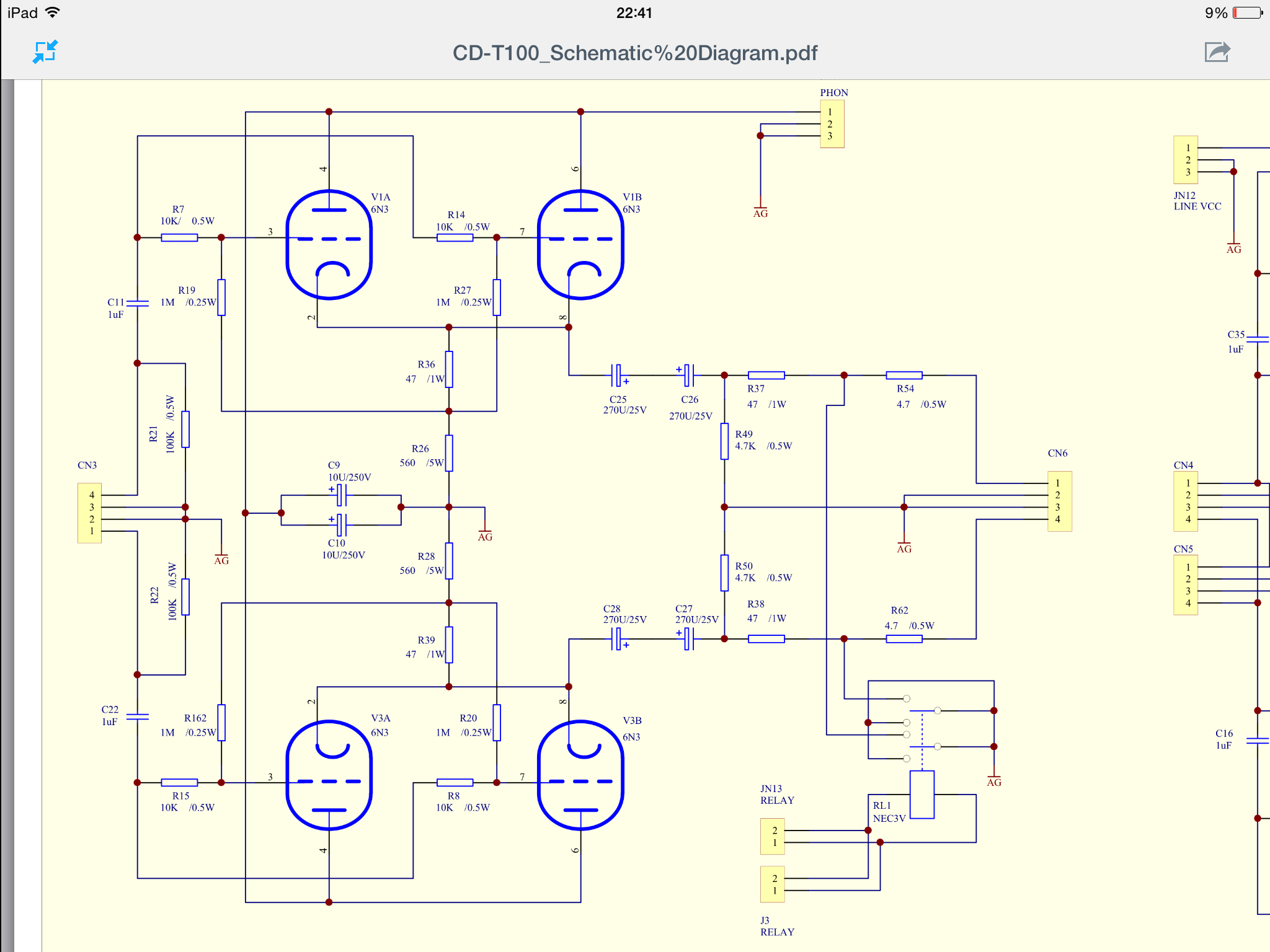

But your ice amp already has the opampbuffer. To ad some tube harmonics you can use a common cathode follower like schematic below. Use stabelized 200v anode and heater supply.
For symmetrical signal build the schematic two times and use 20sec On delay.
You can use for C25/26 and C27/C28 a 2,2uf capacitor because of your high input impedance and leave out R49 and R50.
You can also use 1 triode for each signal path. Then you have only 2 tubes. Change then R36/ R39 from 47 to 100Ohm and R26/R28 from 470 to 1k.
If wanted i can search for the complete schematic i build 20 years ago?

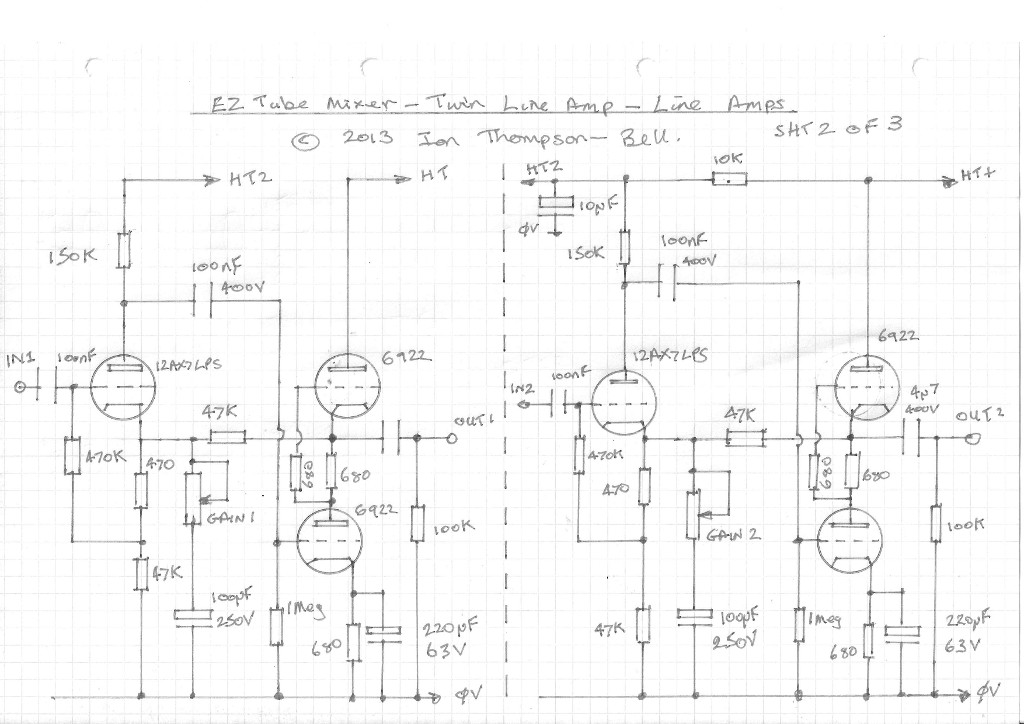

Since you want balanced in and balanced out then you could consider using input and output transformers for this. This will potential provide the additional mojo of using transformers as well as tubes. Don't skimp on the transformers; good 10K:10K input transformers are available from Sowter, Jensen, Cinemag and others. Carnhill make the best line level output transformers.
In between them you could use my twin line amp circuit (attached).
Cheers
Ian
Cheers
Ian
