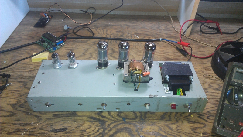

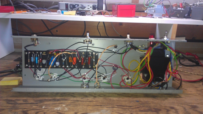

Thanks for the suggestions! I want to keep my designs "historically accurate" for their sound, but incorporate improvements when needed. Will be rewiring my heaters off-ground, and ground the winding CT (my PT has one). Just got it working yesterday, and DID shortcut some grounding - on purpose to see what I could get away with - and yes it hums! Oh, and the amp didn't make a sound when I thought I had it all wired....(expected it). Part of learning, but after finding a missed ground, an un-wired preamp pin, and lastly realizing I had forgotten the 1meg resistor on the input jack, it worked! So...will also insulate the input jack from the chassis, separate cathode resistor grounds from heater grounds (hey, they were right next to each other, just run them together!....NOT). Have a tremelo eyelet board ready to add later when I get the amp working. And put extra pot hole in the front for tone later too.
