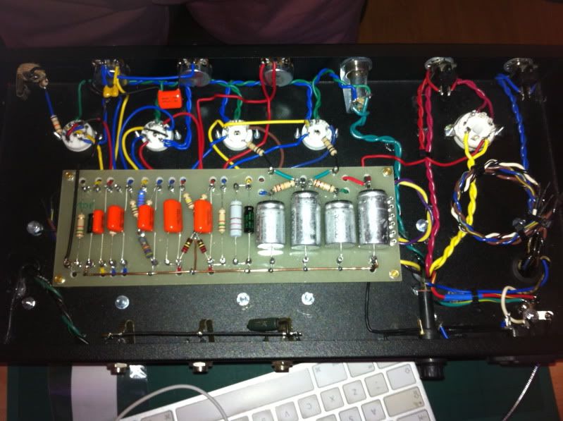

Hi guys, thanks again for all your helpful posts. Sorry I've not replied recently, been very busy.
My amp is now finished! I tested all the voltages today and while being a little lower than I expected everything was pretty much where it should be and the lower voltage was consistent and turned out to be because the PT secondary was rated somewhat lower than on the schematic I was following, so it all makes sense.
The amp, to my total amazement, sounds fantastic. I'm so pleased, I was expecting a fail of some kind at first but it's fine and is exactly the sound I was after, a little dirtier than I'd expected but that's even better for the kind of stuff I play when I do play guitar (I'm a drummer mainly). Love it.
There's a bit of buzz when the tone pot is up but it's no more than on other amps I've played and it doesn't bother me a bit.
So, as I mentioned in an earlier post, here is a shot of my build and there is a whole album of progress and gut-shots here. Enjoy. Comments/feedback and suggestions more than welcome, I'm looking to do a similar amp again next but with the addition of three separate EQ pots, so any advice would be appreciated.

No kidding.Very nice Ben, very neat and tidy, looks fantastic. Just a pleasure to look at.
Hello Ben,
beautiful build, checked out the other pics and great job on documenting all your excellent work. As you are looking at alternate tone stacks, I would suggest getting a free download to try on following
