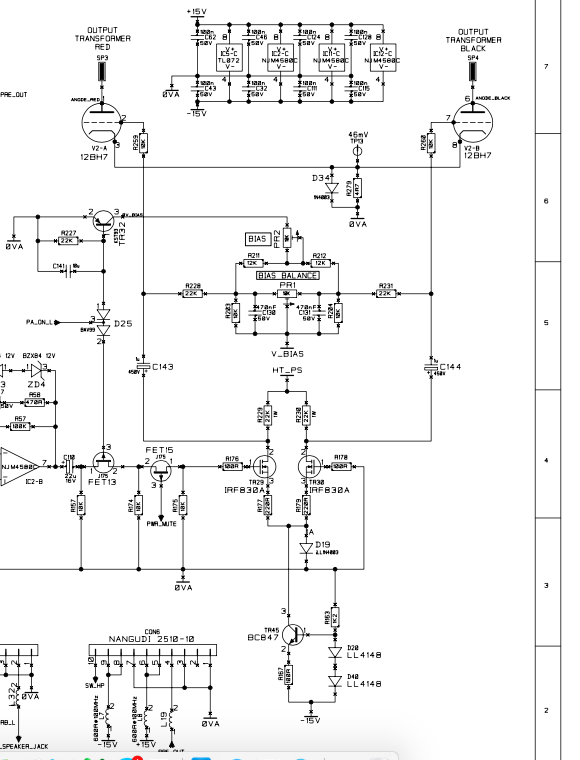

I have an amp I'm trying to repair. I have a bit of experience with tube amps and know the dangers and safe way to work inside a chassis (to get that outta the way). It's a Blackstar HT5 and there is an earth hum. All voltages at the test points are correct, and there wasn't any damaged components. What I did find was the grid pins of the output tube was connected to ground while under power (no tube in). It stays connected for a few seconds once power switched off then isolates from earth. I have tested a few components in the chain between ground and the grid pin and they test OK to my knowledge. Its a twin triode tube and is earth is present on both grid pins when powered. Should the grid be connected to earth when powered? Below is the section of schematic with grid circuit.
What is this "connected to ground", "earth is present"? Do you have zero Ohms, zero Volts, or a continuity beep?

Thanks for the reply PRP
Sorry if I wasn't clear in my description.
I am getting a continuity beep with 1 probe on the pin, and other to chassis, when the circuit is on. When power switched off, the continuity beep slowly dies.

Thanks for your reply Duncan2
I was looking for a component leaking to ground. While probing the tube socket pins, after the amp was switched off I found the grid pins had continuity to ground. This disappeared as the amp cooled down, so I suspected a component was going open when amp powered up. Is this a possible scenario?

Your amp's output tube has a negative bias voltage via it's grid. Your meter is likely reading that negative voltage and not detecting a short to ground. Switch the meter to DC voltage, you should detect a negative voltage. If you do, it s normal.
