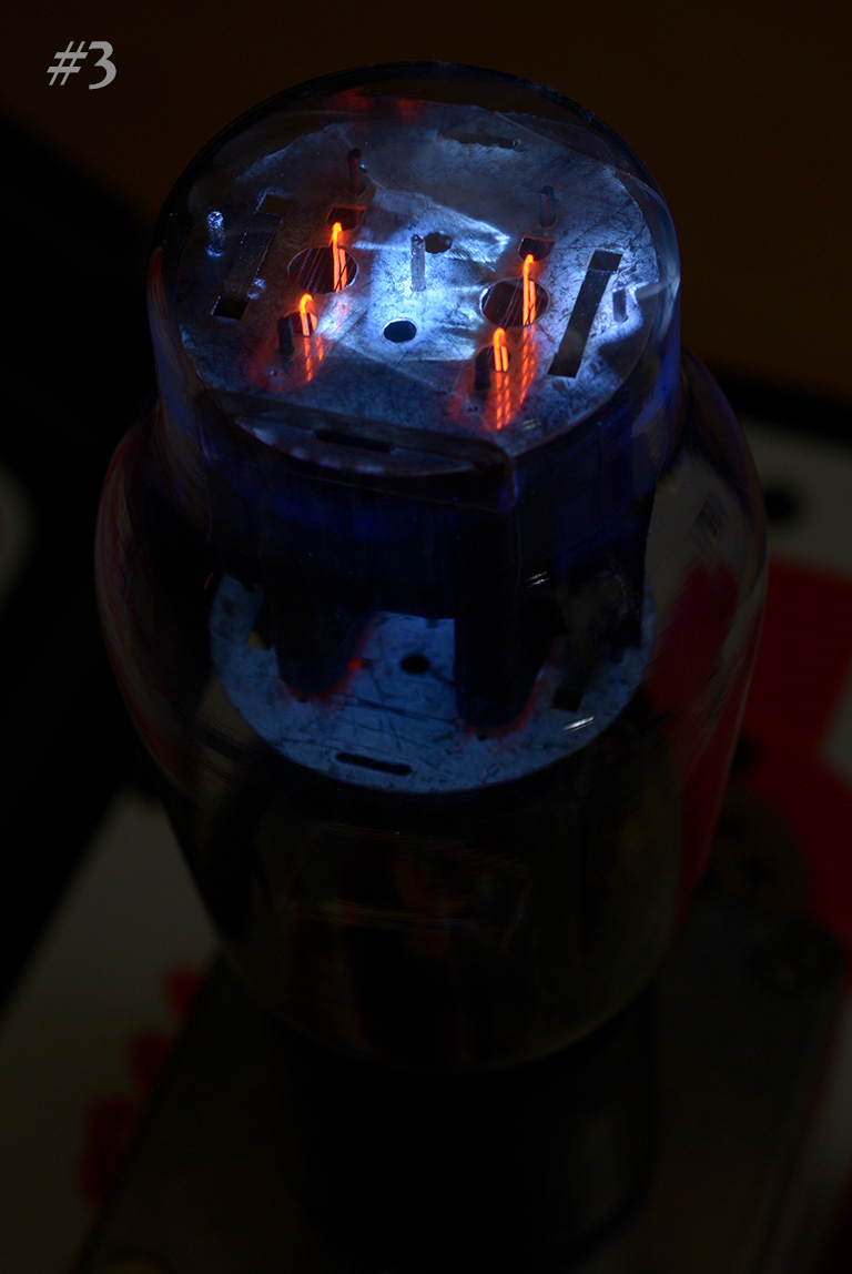

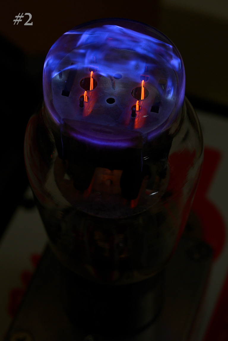

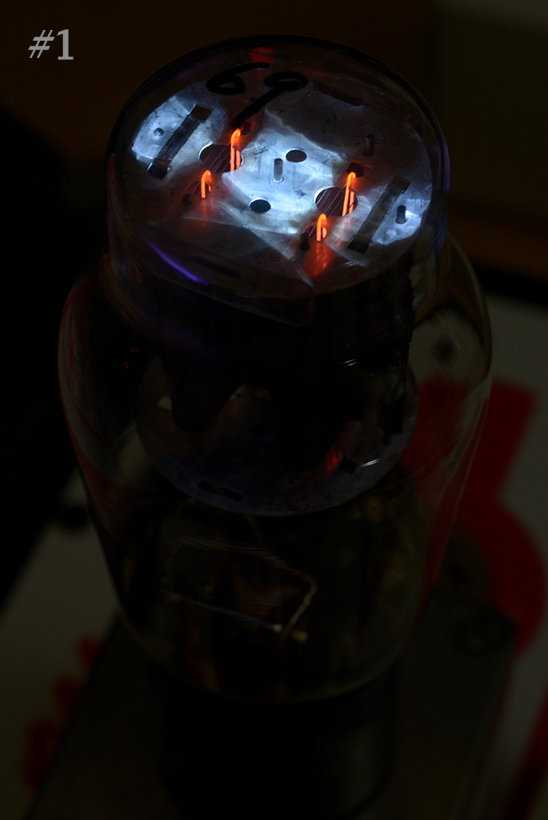

Below are photos of three different 2A3 tubes recently purchased at a particular online auction site, all of which exhibit different glows when under test on my MaxiMatcher (Vp=325v & Vb=-60v).
It is my understanding that
What are your thoughts and analyses?
Would you use any of the tubes below with amps and speakers you cared about?
- blue glow on the glass is OK
- blue glow on the mica or supports is questionable
- purple glow anywhere is bad.

I've seen similar on a handful of both NOS and new production tubes, and they lasted a good long while without issue. I wouldn't worry.

If I was concerned about the glow, I would test for grid leakage. With your test parameters, connect the grid to ground though a 1M resistor and measure the voltage across it. A good quality meter will have an impedance of 10M and won't influence the measurement much.
I did not look on the 2A3 tube curves, so do not know what current you had at 325V and -60V.
The resultant I x V is probably less than the 15W maximum power rating.
Of course under real signal conditions the plate might go to as high as approximately 500V.
But I have had 2A3s, 6A3s, and 300Bs that glowed that way. They worked fine.
Some of them "dance" with the music.

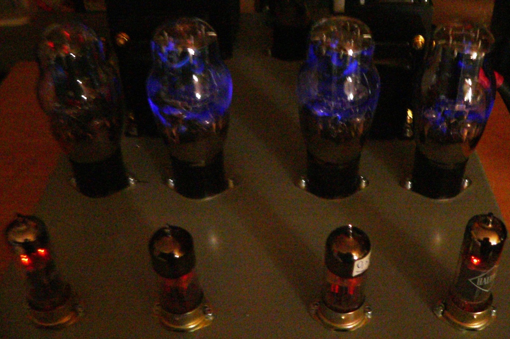

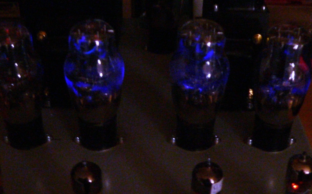

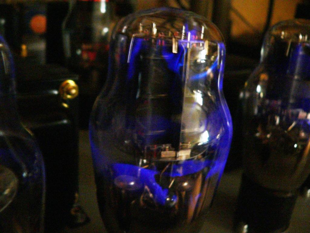

I have some Svetlana 6C4C (bought cheap before the price ballooned) and a pair of Electra-Print output transformers designed for a triode push-pull. It would be interesting to design a no-feedback amp based on these once I decide on an input stage. I also like that I might be getting some blue glow for my trouble. Maybe it's time to trot out my 6n6ps....
my 6n13s (russian 6AS7G's) have a wonderful blue glow that will dance lightly on heavy signal input, very handsome.
