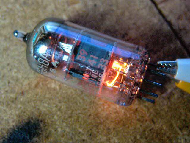

The "flasher", captured
The "flash" has no bearing on the quality of the tube. I looked through my tubes and found this "flasher". I took several pictures attempting to time the camera and the power supply simultaneously. This tube is a Zenith 6GH8A, Made in USA. I don't think that anyone would accuse this of being a "quality tube". The flashing is due to the filament construction. The fact that the link between the sections is made from filament material instead of steel is probably a cost reduction move, not a quality move.
I have seen other tubes that "flash" and some were from well known European manufacturers. I don't believe that they are any better or worse than a non "flasher" from the same manufacturer.
