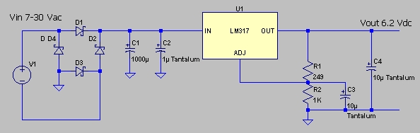

Hello, I'm going to try Joe Rasmussen's tube buffered GC, Pete inspired me, raves about his. Anyway, for various reasons I want to use this circuit in the pic for the heater power. If Joe or anyone sees any problem, I'd appreciate a "heads up".
Thanks,
eeehaah

I'd add more capacitance for a heater supply...10,000 to 20,000uf for your first cap, 4,700 to 10,000uf for your last...these are pretty common values for heater supplies.
Whatever for??? It's drawing around 300mA! The only advantage will be watching your heaters glow for 5min after you've turned the amp off...
Eeehaah, the caps are fine! Don't waste caps where I guarantee they will make NO difference. In fact I'll bet you won't be able to hear ANY noise/hum from an AC supply, especially with a CT 3.15-0-3.15 arrangement.
Rather add 10000uF to your supply rails...
...because that's what's traditionally used in dc heater supplies(please see any number of schematics on the web)...granted the lm317 is going to help kill the ripple, so you could lower the value of the second cap, but with only 1000uf in front of the 317, it's going to be working overtime to do so.

Hi this kinda interests me too.
In my heater psu Ive got 1000uF 7805 with two diodes raising output to 6.2 regulated and another 1000uF. It sounds amazing (thanks Joe if your lurking🙂 Anyway, I got 50mV ripple with next to no capacitance, whats the point of using tripple regs and wasting 20000uF on capacitance? Should I try more capacitance or is 50mV as good as it gets?
With 3-10 bucks,(not alotta money for that "wasted capacitance"), you'd have it down to 1mV. This may not matter for a buffer being fed from a preamp or CDP, but it most definately matters in a preamp - especially one that has to handle micro or millivolt signals from a phono cartridge.
...the point being: why scrimp in an area where it's cheap to remedy? I'll take 1mV of unregulated ripple on a heater over a regulated heater with 50mV any day.

your right I should try it, and if I do actually choose this variation, I will work on the heater PS. Im just curious if it really makes that much difference as heaters can also be fed of 6.3V AC. To the best of my very limited knowledge on valves, I thought that DC over AC makes it easier to control hum so i wonder if 50mv ripple matters if there is no hum.
If you don't have any hum, I'd leave be. My point was kind of rhetorical- if someone wants DC, why not go all the way?
BTW, my first preamp had AC on the heaters, and it worked and sounded fine.:bigeyes: ...until I switched to a different tube type(12au7 to 6sn7). Then it hummed like a barber shop quartet, and forced me to go to DC.
