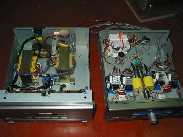

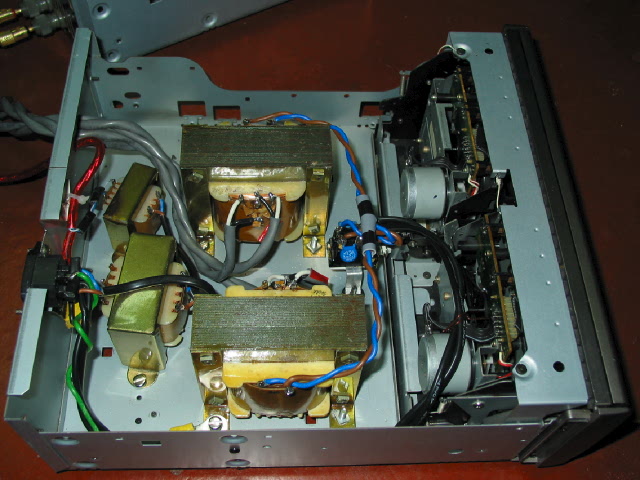

Just to give you an idea, I'm using 2 separate chasis for Tx and amplifier - both chasis salvaged from a Yamaha Tape Deck and a Yamaha CDP (at least they have the same aspec ratio).
4 Tx in the first chasis - Lt, Rt, Tube, Filament.

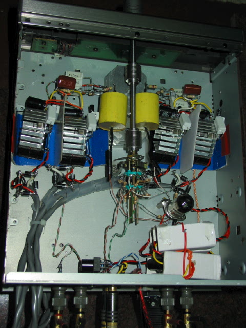

Amplifier chasis consist of the following - Step Attenuator (wafer anf attenuator from RS, resistors using matched carbon 5% i.e. normal stuff), Voltage regulator LM338 x 4 including heatsinks, Tube 6922 Electro Harminix, Supply and Filament Regulator. Pretty packed too.
- Will post some in a couple of days time when my camera arrives...

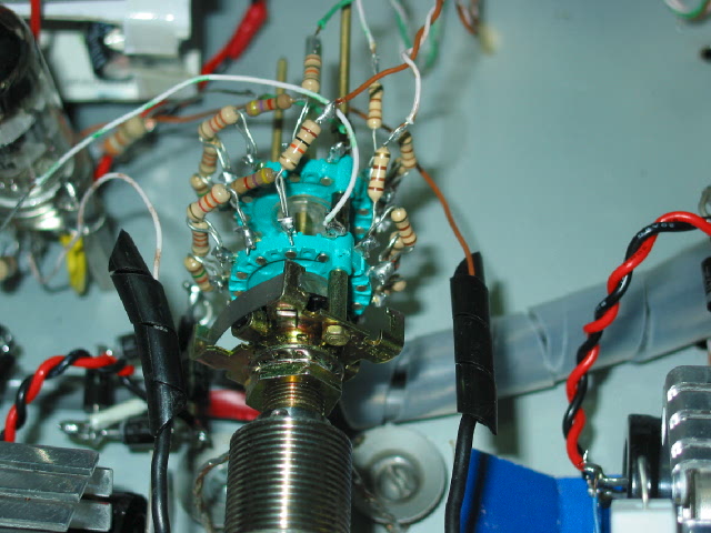

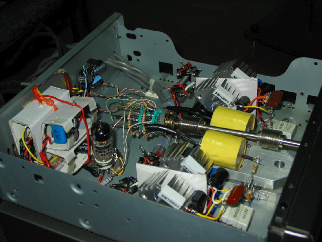

Some more pics of the guts: Last but not least, the 11 step attenuator (make bf break) having total of 24.1K ohms from RS. This made a huge difference in improving sound stage width and depth compated with an Alps Blue. The resistors are plain carbon 5% but carefully matched. Who says carbons do not sound good ???😉
I like the ruff and ready look of your amp and layout Will (that's a compliment btw! ). 😎
It looks like you are using just the single valve for both channels - was there a reason for this? Did you remove the V regulators completely?

- Thanks. This is the first time I'm building this kind of amp so to save on cost and also to maintain simplicity, I'd use the single valve. Pin 9 is connected to the chasis BTW to minimise x-talk. Yeah the V regulators are gone cos' they are really noisy.
