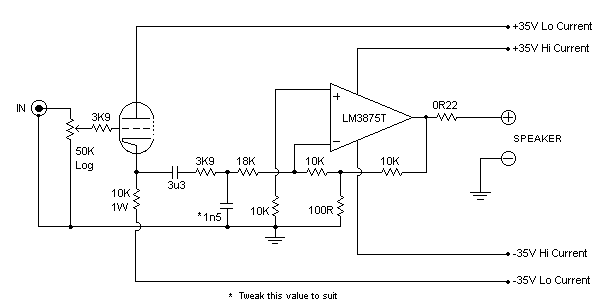

I have tried to pick out a bit of the Tube Buffered gainclone to make an output buffer for a CD-PRO2M. I want try it to see the difference in sound.
I was hoping someone would check to see if this is OK, or if I have left out any thing I'd need.

Not sure what you expect to hear from a cathode follower, probably just the sum of fingerprints of the components used but here goes:
As for the circuit, if you put a 50 to 100K gridleak resistor "en lieu" of the volpot it should work.
Plus add a bleeder resistor of roughly 100 to 470K behind the coupling cap too.

Well, the buffer is supposed to give the Gainclone a hint of "Tube" sound. Since I've rarely heard tubes (in fact, only the buffered Gainclone - with a buzz) I'm not sure what Im listening for. However, I'd like to see what the impact is on the output of the CD Player.
Is this revised schematic correct?

I doubt that's the main purpose but nevermind.
Yes.
You can safely reduce the 3K9 gridstopper (gatestopper in semi lingo) to 1K or lower.

Sorry to say so but 90% of what I read on that page is absolute nonsense.
Heater polarity, cascode stuff that has nothing, nothing whatsoever to do with the circuit shown.
Forget it.
BTW, why would anyone want to put a tube buffer behind a couple of stinkin' opamp buffers anyway?
If you want to work with valves then start on page one of the book, don't jump right in.
