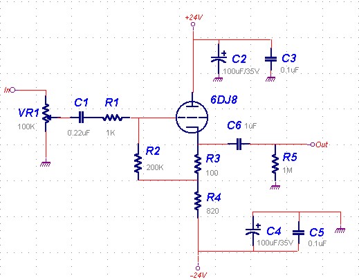

ebijma said:Found this circuit.
Don't know if its any good.
Maybe some of you members can give some input on this circuit.
The specs say those tubes can run at 24V but higher is better. You might try 35V or even up to 70 or 80V.
Exactly.
The cct shown by Ebijma was developped for a Gainclone amp where this bipolar supply was already available.
Upping B+/B- should noticeably improve dynamic range and linearity.
Another useful technique to improve on it is to stick a CCS on the tail end.
Various other buffer types exist so pick your poison...
Cheers,😉

There's another version of the buffer with a CCS, how's that?
(from http://www.diyzone.net/diy/references/tube/6dj8buffer_2.htm)
Also, what modifications are required to run either of these circuits at say +/-35 or +/- 40V ?
/U.
Nisbeth, the circuit you posted is a simple self-biased cathode follower with an active load.
Not too sure what R1 is doing. If it is a grid stopper it should be as close to the grid as possible so the lead doesn't act as an antenna. I believe the 6DJ8 is known to self-oscillate, particularly used as a cathode follower... not certain on this though.
Since the output is capacitor coupled, a bipolar supply is not really needed... though it will work off one if you are going to install it into a SS amp and share the rails.

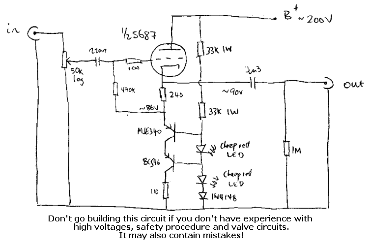

Active-Loaded Cathode Follower Buffer
I've drawn something with a 5687... (I happen to like this valve 🙂 ) and a single supply
It's probably over the top for its intended usage... and 200V is rather dangerous, and probably requires higher voltage rated components, especially in the power supply. But allowing more plate-cathode voltage lets the valve provide a greater swing, and avoids the murky area around 0V grid bias where you may or may not get grid current...
The LEDs in the schematic are for their voltage drop... I had something with Vf ~ 1.7V in mind when i drew it. The silicon diode is my attempt at temperature compensation... and the MJE340 may be happier with a small heatsink, as long as it is well insulated
For anyone reading this... don't go building this circuit unless you have knowledge and experience with high voltages and valve circuits. Apart from the 200V supply, I haven't triple-checked it and may contain mistakes
