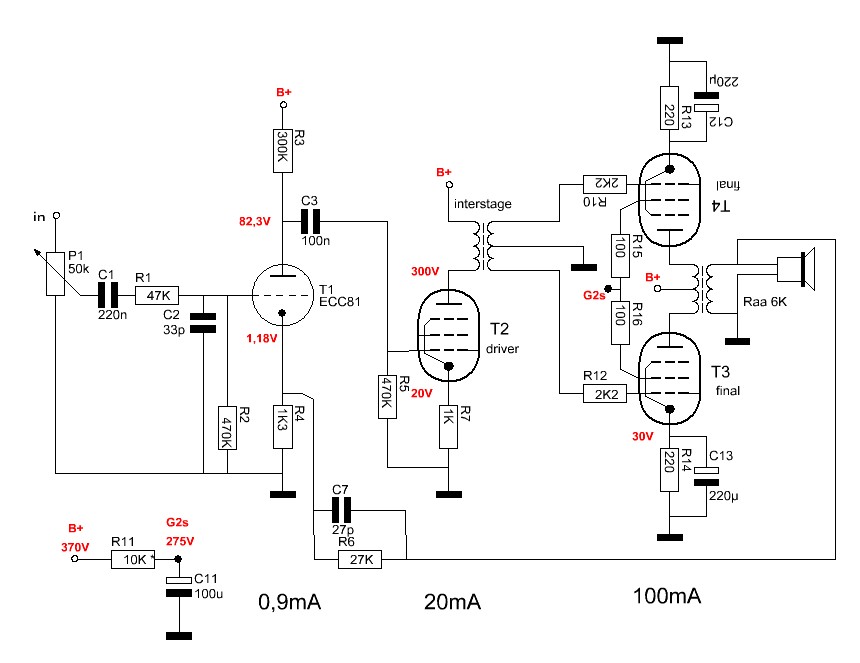

They're interstage transformers, "driver" indicating that they feed a power stage, usually a class B or AB2 stage that requires some driving power. The first one appears to be a low-power modulation transformer - a push-pull audio stage would modulate the DC that powers an RF amplifier stage. They are different from audio output transformers in that the secondary carries DC current.
Do you know of any schematics that would show interstage transformers in a circuit. Seems like they are power transformers? What would be the benefit or reason to use them?
Thanks!
Thanks!
Thanks!
It's not a complete schematic but it has the principle to look for. The purpose of your interstage transformer can be two fold: to split the audio signal into two opposed phases, or to deliver a beefed up audio signal at the final tubes.
