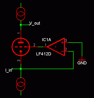

I've made a simulation using tube as i/v converter
http://www.geocities.com/aykm/temp.htm
Any suggestion?has any1 tried this kind of ciruit b4?

I don't see the point of this circuit. Your tube is not amplifying anything, it is connected as a vacuum diode. If you are going to use transistors for current steering anyway, you might as well replace the tube by a resistor...
Grounded grid stage looks more interesting to me, although of course the input impedance is going to be higher than transistor's.

Cathodes are the only low impedances so look for high gm tubes, with gm as flat as possible as function of Ia.
Furthermore this converter type suffers from the same drawbacks as a cathode followers (so remeber about current sources and cascodes !)

my thought is ,the sound will be dominate by the charateristic of the tube if use as iv converter.In simulator the wave form has the kind of distortion as described in a passlabs article:the positive half is slightly higher than negative half.Im curious how it would sound in reality.

ingram said:rfbrw,
I've seen that website b4 but dont quite understand how it work,how come the ground is floated??😕
It is the same as the Pass D1 circuit without the follower on the output or the ability trim the input to 0v.
The circuits you linked to do not look to be servoed to me in that there is nothing keep the input impedance seen by the dac as close to zero as possible. A sevoed variant of the tube iv would look something like the circuit below.

Hi
CFs distortion habbits from
1 - current modulation (mostly the low cathode resistor value)
2 - voltage modulation (anode - cathode)
both can be understood when studying thecharateristics
1 is worse than 2 (mu times) and 1 is also affected by external load like input impedance of next stage (but often high with tubes
Applying a current source as a load for the CF, decreases distortion, also when drive at the cathode.
2 can be reduced by applying cascoding on top of the anode, but again, yields less results
consider penthodes like E83F or E55LL as well
