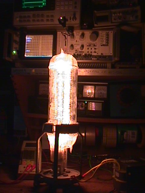

I'would suggest 833A.
Or the GU81. This tube is extremely cheap here, a non-used, NOS GU81M/GU80/5S045T costs about 15USD. But an original socket is about 80USD...
833 is to good and expensive for this purpouse I think.

What you are looking for is a transmitter tube with a thoriated tungsten filament. They glow very brightly.
Normal tubes use a low-temperature coated filament that is not very bright.
