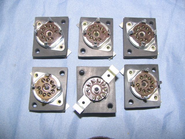

zigzagflux said:I've searched around, and wasn't finding any good ideas on mounting tubes for low vibration. I came up with the following parts for a simple subchassis mounting.
What have you used?

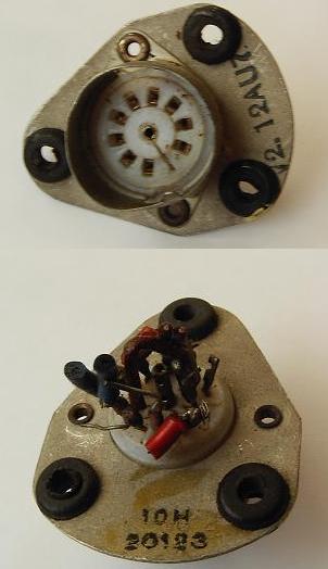

I found this in a box of tubes I recently acquired...
Andy
Yeah, that's kind of the idea I was coming up with. Tube socket mounts to a small ring of steel or aluminum. That ring is then mounted to the top plate through the grommet or whatever.
Thing I liked about the pads I put in the first post of this thread was there was no metallic hardware coupling the top plate to the bottom ring. The grommet method does just that.
I'll check out McMaster for some high temp silicone grommets. They have such a nice selection, and one doesn't end up spending $8 per grommet because it has magical audio powers.

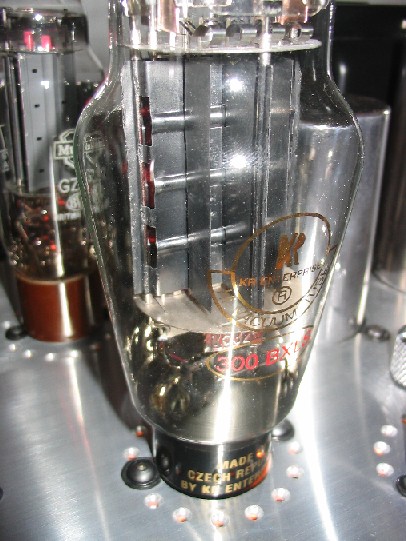

I used these Buna-N Rubber grommets from McMasterCarr for all components mounted to the top plate (tube sockets, caps, Xfmrs, chokes, etc):
http://www.mcmaster.com/ctlg/DisplC...20099835975&ScreenWidth=1280&McMMainWidth=925
Their temp rage seems decent (-45 to +250 F).
No cracking or signs of failing yet. Amp has been used daily for about 8 months now.

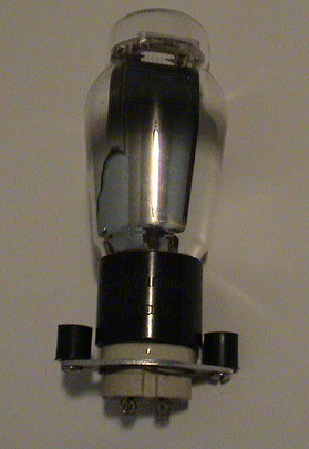

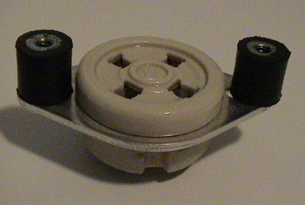

Here are two small isolation mounts attached to a 4-pin socket. As you can see, they barely clear the sides of the tube base, so this is really the minimum size socket mount you can use. On this type of mount, the metal threaded sections are completely isolated from each other by the damping material. The screws used to hold these to the flange are only 1/8" long.
John
