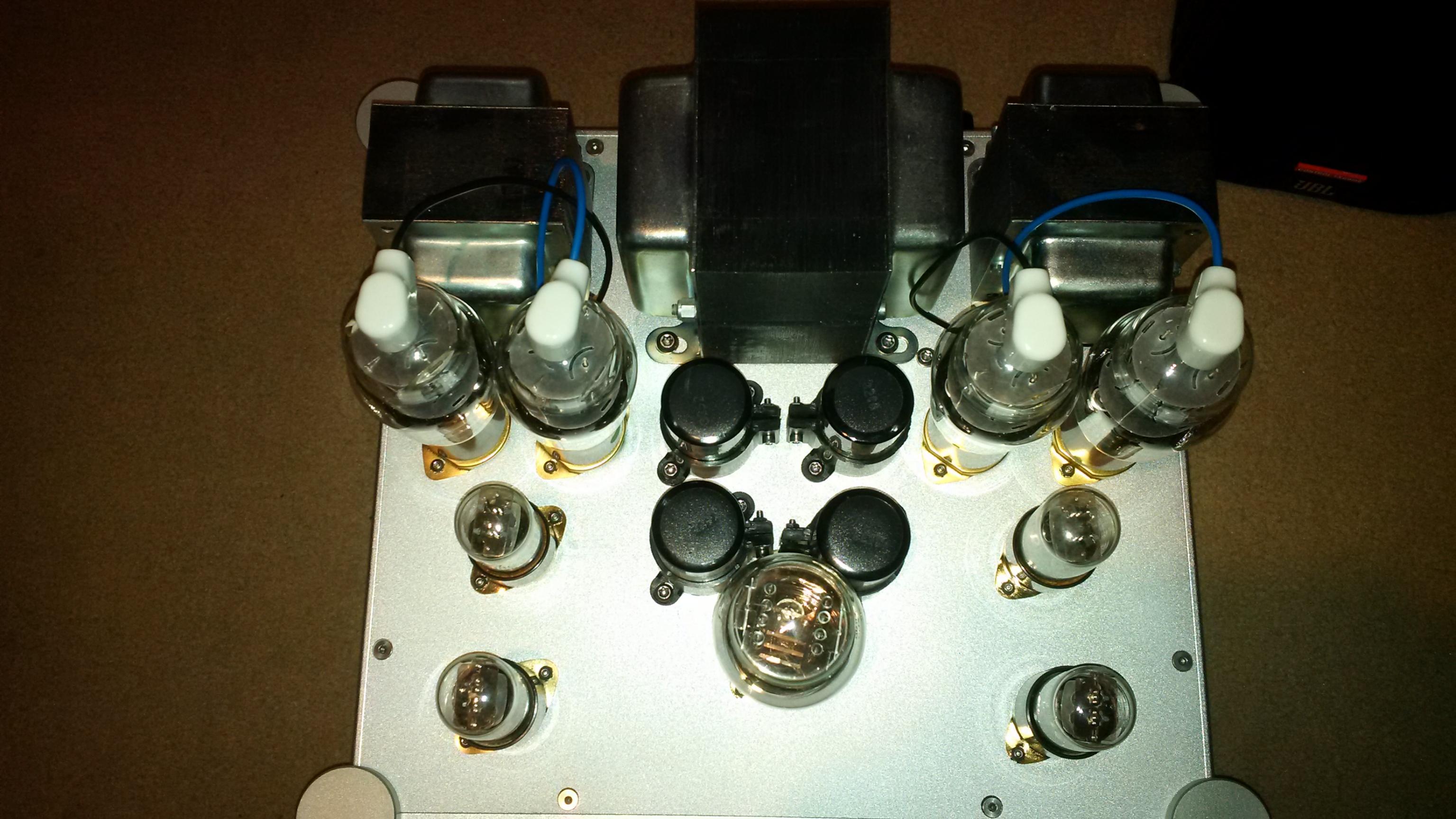

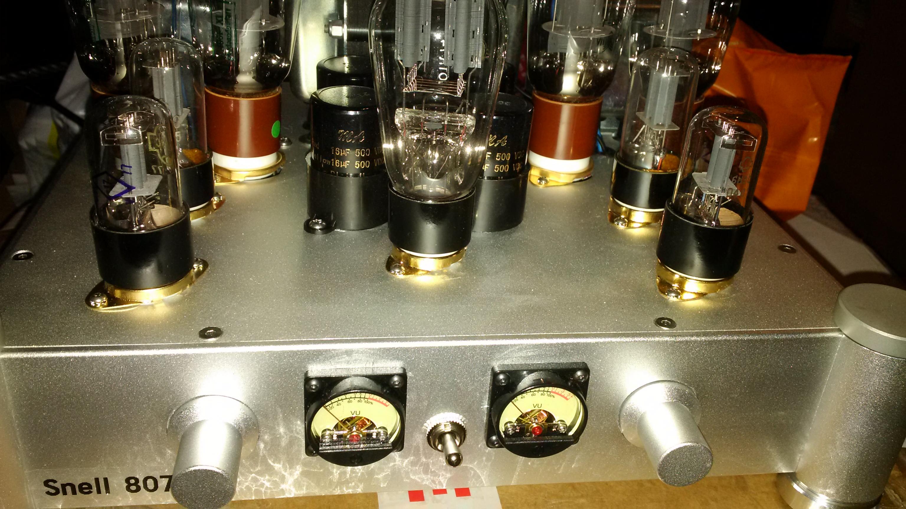

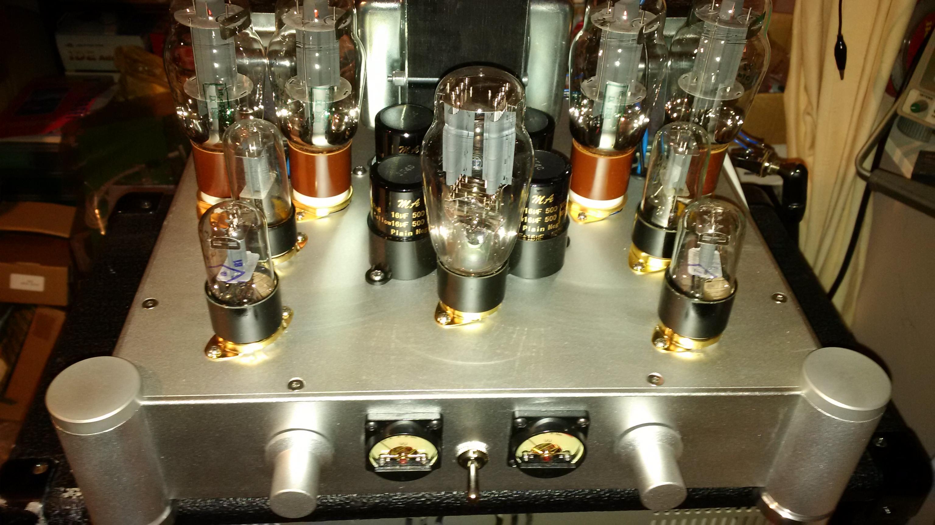

The pictures are of my Type 807 power amplifier. All transformers were made in England to my design and locally at a cheaper price than anywhere else I could find. I made 3 of these, two sold straight away and the first one I kept for my home use.

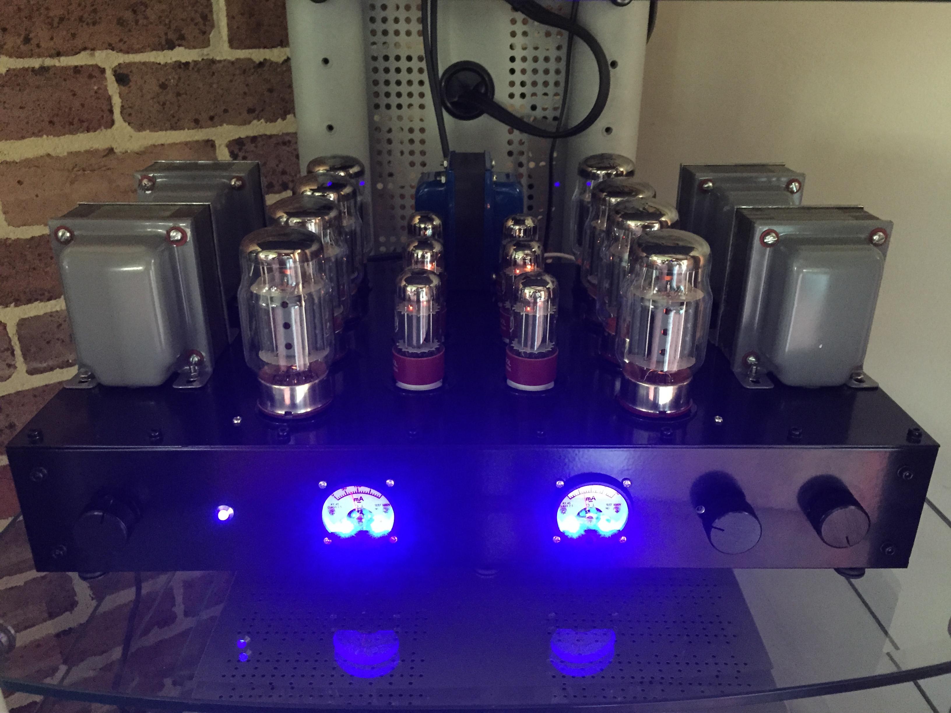

Your pics look good. Attached is one of mine. Its a circlotron with 4xKT120's per channel and (few hundred Ohm output impedance of the circlotron cct means I can use thin hook-up cable for the leads from the amp and mount Lundhal output transformers at the speakers).
For info, who do you use/recommend in the UK for transformer manufacture?
