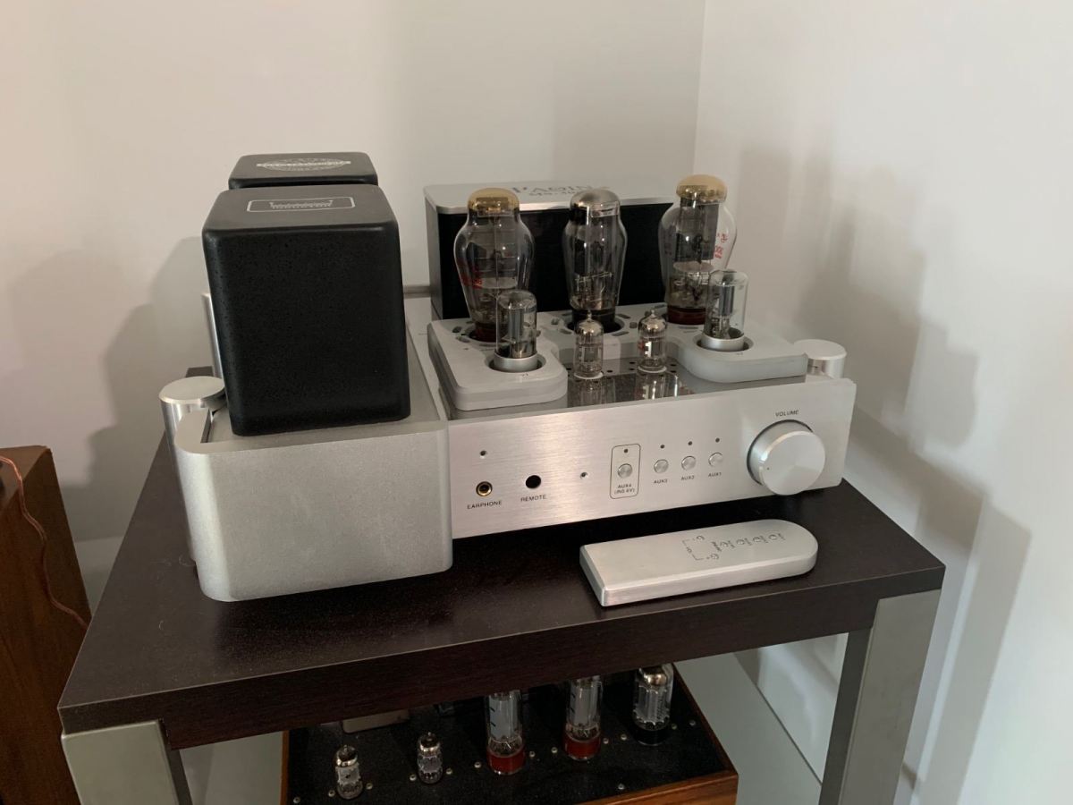

I really like my Elekit TU-8200R with the Lundahl output transformers (US$1260 with shipping to the US from Vancouver, Canada). I am using it in a slightly smaller room with 86 dB SPL/W@1m sensitivity speakers. I also enjoyed building it tremendously. The English manual you get from Victor Kung is very detailed and pretty much foolproof, with check boxes for every single step. I bought a $46 soldering station that came with a roll of solder, a solder sucker and very serviceable tweezers. I already had small needle nose pliers and side cutter pliers, a headband magnifier and a DVM.
The TU-8900 is also in your price range I believe, although not the upgraded version with amorphous core Lundahl's just reviewed in the July issue of Stereophile.
Because you live in Australia it is easy and cheaper for you to get Yaqin tube amps. They are good value for the money and easy to upgrade/ modify.

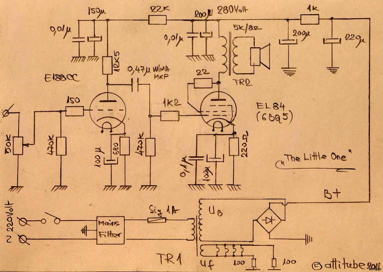

I have a påir of Klipsch RP-160M and use a triodewired el 84 se, probably 1,5-1.9 watts Class A. Sound great and for me, it is enough to fill my livingroom with music.
