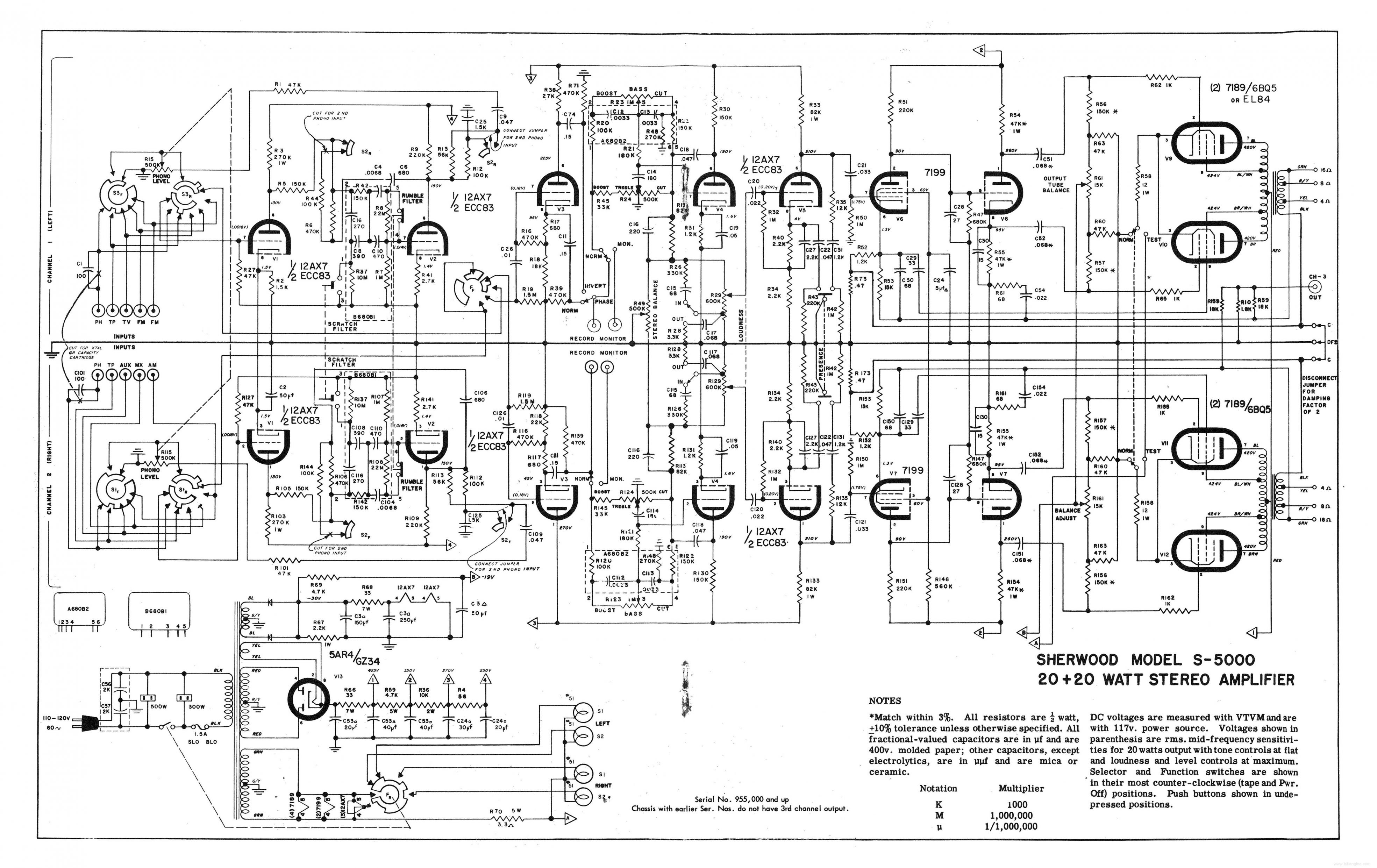

The power section of the 20 WPC Sherwood S5000 (schematic uploaded) could be a good point of departure for this project. The 7199 is more or less extinct, but you can "score" a stockpile of highly suitable 6GH8s off "EBone", before that type too disappears. The ONLY O/P tube to use in that setup is the Russian 6П14П-EB (6p14p-ev), AKA EL84M, which is a very tough 7189 equivalent. The Russian tube sounds pretty darned good too. 🙂 FWIW, my preference is to buy tubes from reliable dealers, whenever possible. Jim McShane is my go to guy, but he's definitely not the only "straight shooter" out there.
Circuitry, like the S5000, that employs global NFB must be built with O/P "iron" that exhibits substantial magnetic headroom. The headroom is needed to avoid encountering core saturation from the deep bass error correction signal. 🙁 Edcor's CXPP50-MS-8K, with its 50 W. rating is a bit overkill, but much better too much "iron" than not enough. That core will NOT saturate. 😀
