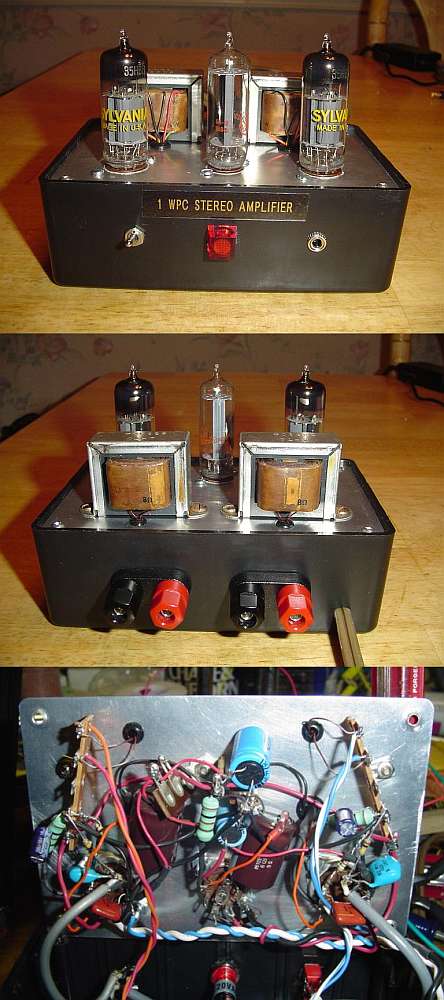

Why am I saying all this. Well, I wanted to get back into tube audio and gathered most of the parts to build a 6L6 based integrated stereo amp. I decided to put that aside and build a budget amp to experiment with. The results is my 35HB8 stereo tube amp using 2 35HB8 and 1 50DC4 tube, line operated so it should be used with an isolation transformer 🙄 . Its real compact, pretty loud for a 1 watt per channel amp. Its lacking bass as I used a 70 volt line pa system audio transformer but it was fun to build. It is so small it fits in your hand, only 6" wide. I do have 2 audio transformers I bought from triode electronics I should swap them out with. Below is a photo of it.
