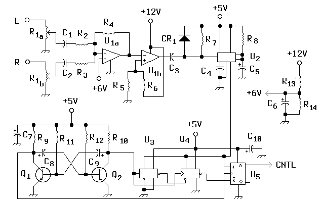

Tube amp inactivity auto-off
I had a similar problem for a project. Here's the solution I devised. How you'd actually implement it would depend on the delay you need. To increase it, add more decade counters. That way, you wouldn't need to worry about quiet/silent intervals in the program material.
