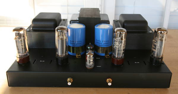

Its related to the one piece of equipment I didn't build....the Quicksilver GLA tube amp. I must have not noticed it originally? Without anything attached to the inputs the amp is dead quiet. However, once I connect just one piece of homemade or commercial source equipment to the RCA inputs on the amp (even with different RCA cables) the hum appears (with or without signal). The problem is in both channels. If I unplug the R input the R channel output has no hum but the L output still has hum and vice versa
Curiously the tube amp doesn't have an earth ground (class I?; two prong power cord). I added ground safety loop breaker circuits to the source equipment but this had no effect on the level of hum from the Quicksilver amp (BTW which doesn't vary with level of the source(s) volume). I also temporarily connected the amp chassis to earth ground, but this made the hum worse when a source was connected to the inputs.
Any suggestions on how to get rid of the hum problem with the tube power amp?

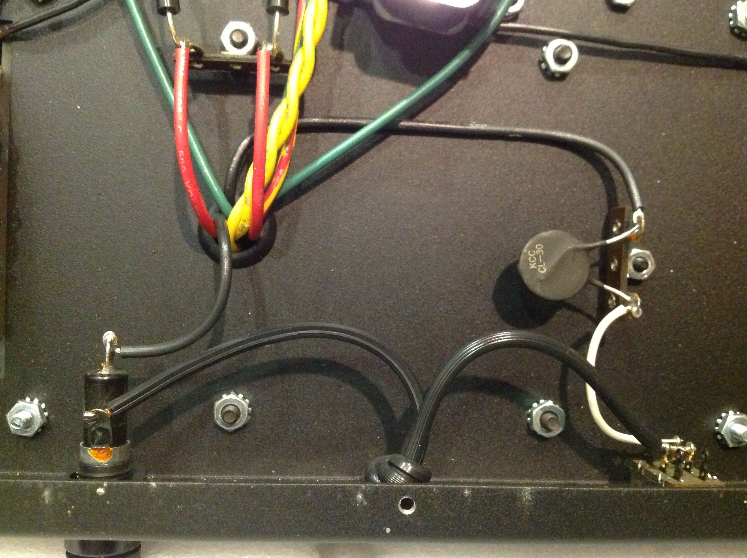

Nice ... no ground and a switched neutral ...
Needs a three core grounded mains lead fitted urgently, the ground taken to the chassis and bolted down nicely using a tag and a star washer. This will give you some safety, although won't fix your hum (in fact, may make it worse, until we get to the bottom of the problem)
I don't know what the regs are in your part of the world, but switching the neutral is a pretty daft idea in my book. Double pole switching both live and neutral is preferred here.

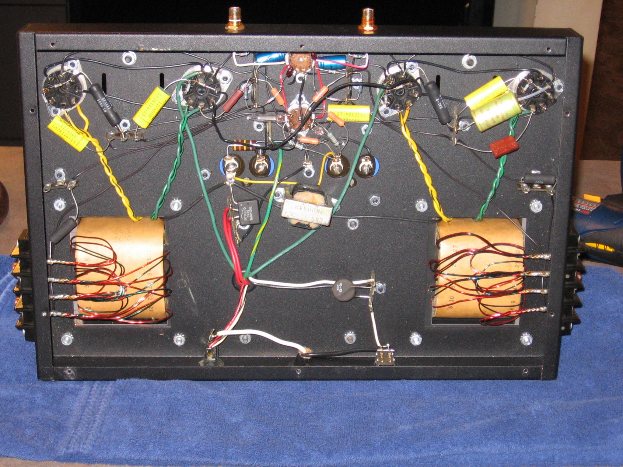

You might try lifting the heaters to B+ / 4. Also looks like all the heaters are off one xformer tap seems like a lot of current necessary.

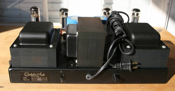

I haven't found a schematic for the amp yet but I did find several photos of the amp and its inards on the web. If this isn't sufficient I try to trace the circuit this weekend
That suggests that the photos are not of your specific amp but of another of the same type.... Apart from the very serious safety issues already identified, the photo of the underside shows some less than ideal power supply grounding (which may contribute to hum), and also some strange differences in the components used between the left and right channels. The non-symmetrical placement of some of the parts adds to the confusion, but I only see a cathode bypass capacitor on one of the pairs of output tubes, for example. If that's not a photo your own amp, then can you take your own photo so that we are making correct recommendations?
do not rely on the chassis for grounding, all power leads should have a corresponding ground return wire....a star grounding connected to the chassis at only one point is also good...
I suppose the picture shows an amp that violates all common sense and construction principles.

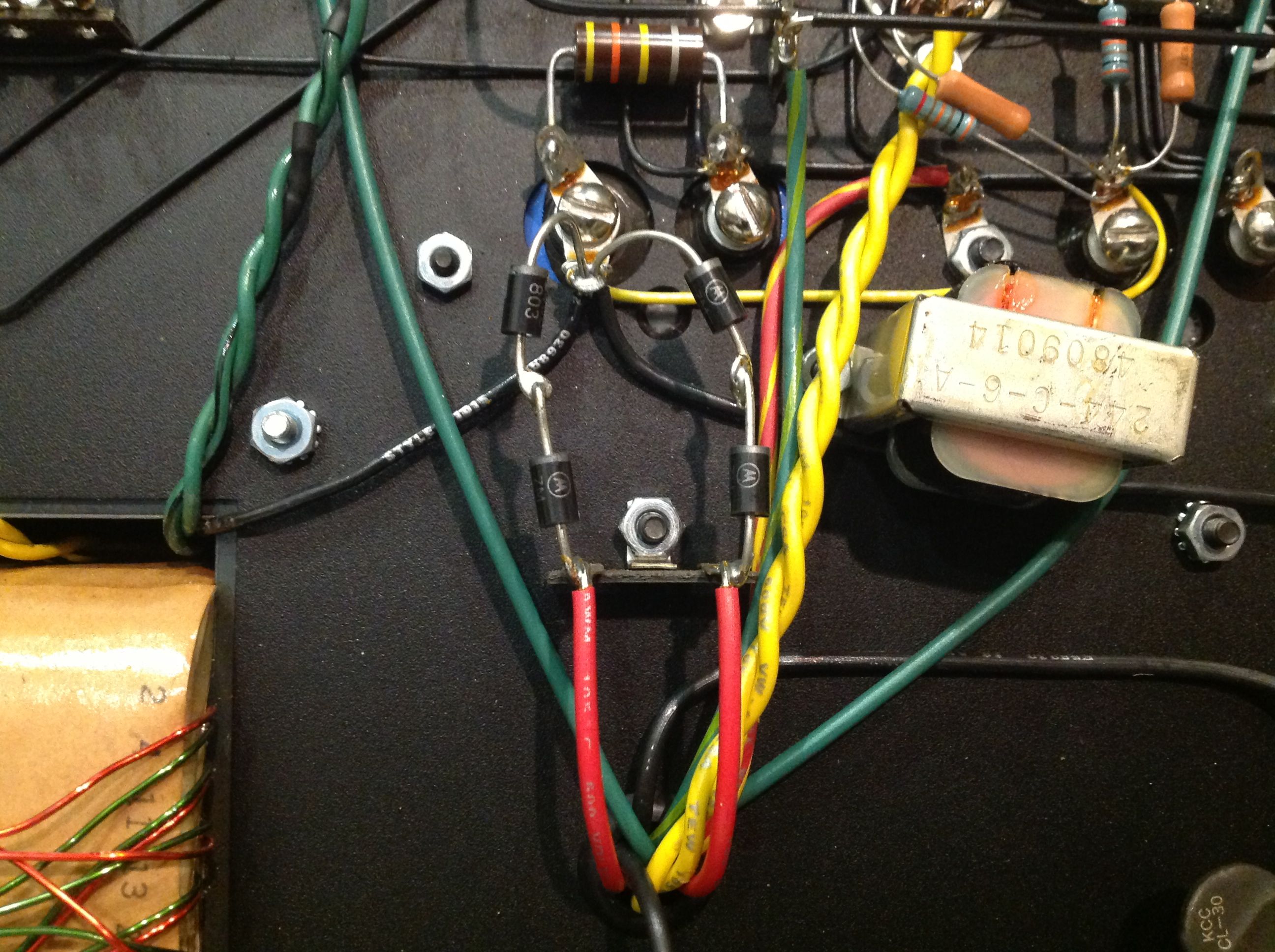

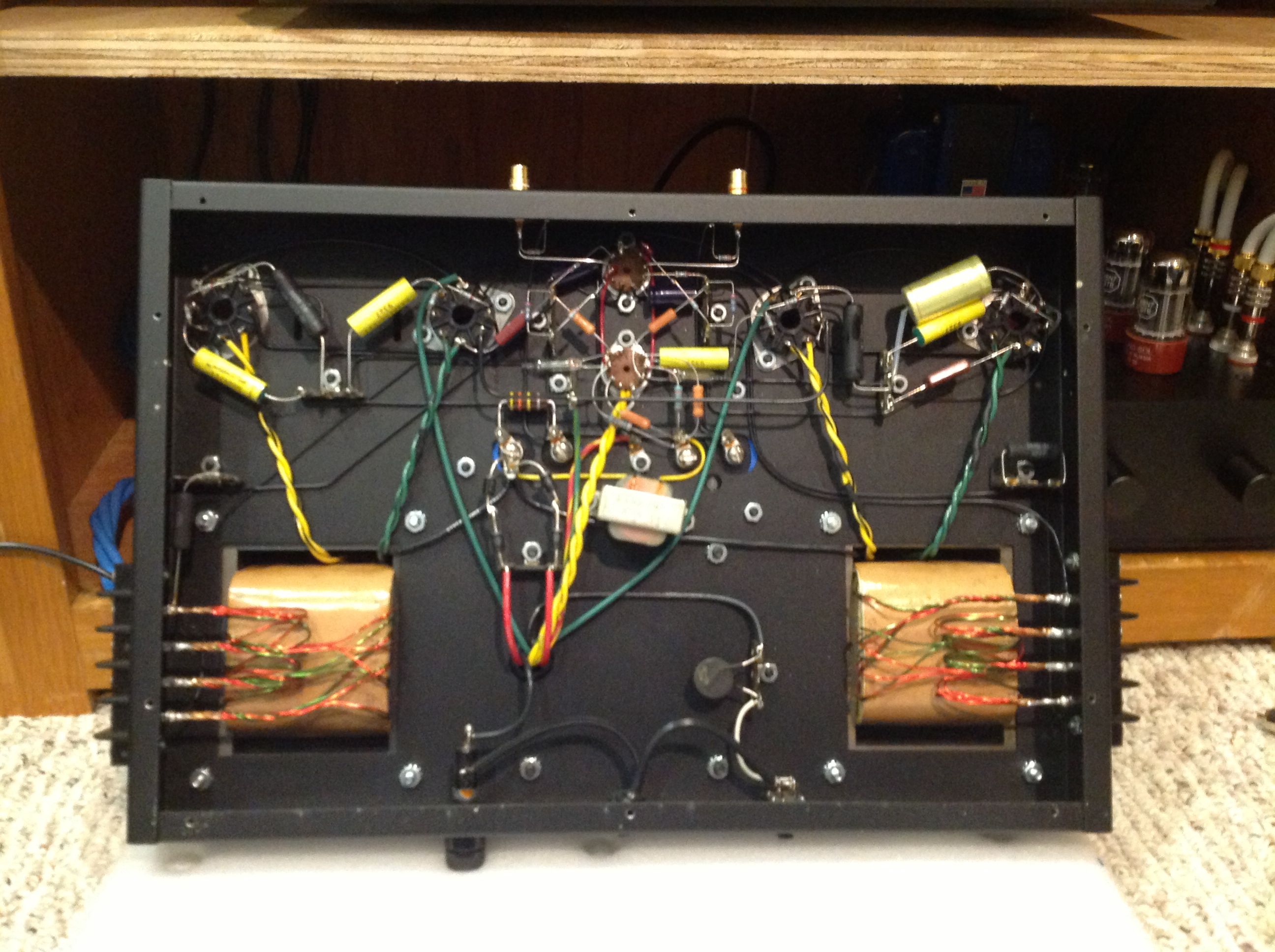

Power input cable apparantly not secured against yanking. A few pulls and it may come loose inside and put live voltage on the chassis.
Obviously the mains circuit breaker should be a dual-pole.
The bridge rectifier in the power-supply should be connected directly with both + and - to the main filter-cap. (Left in picture) and the negative connection of the cap should be taken to the (future) star-grounding lug between the cap's.
All connections that are now on the negative pin of the cap should go directly to the star-ground except the parallel resistor 470K.
Float (hoover) a dual, bare thick copper-wire bus-bar, soldered to the star-ground, above the small-signal tubes and splitting it left and right above the EL34's. Do not connect far ends to any existing ground-lugs.
All components and tube connections with separate grounding-lugs should now be moved and soldered to this bar except the electrolytic cap in the upper right of the picture. It's negative lead should be extended and be connected directly with the star-ground.

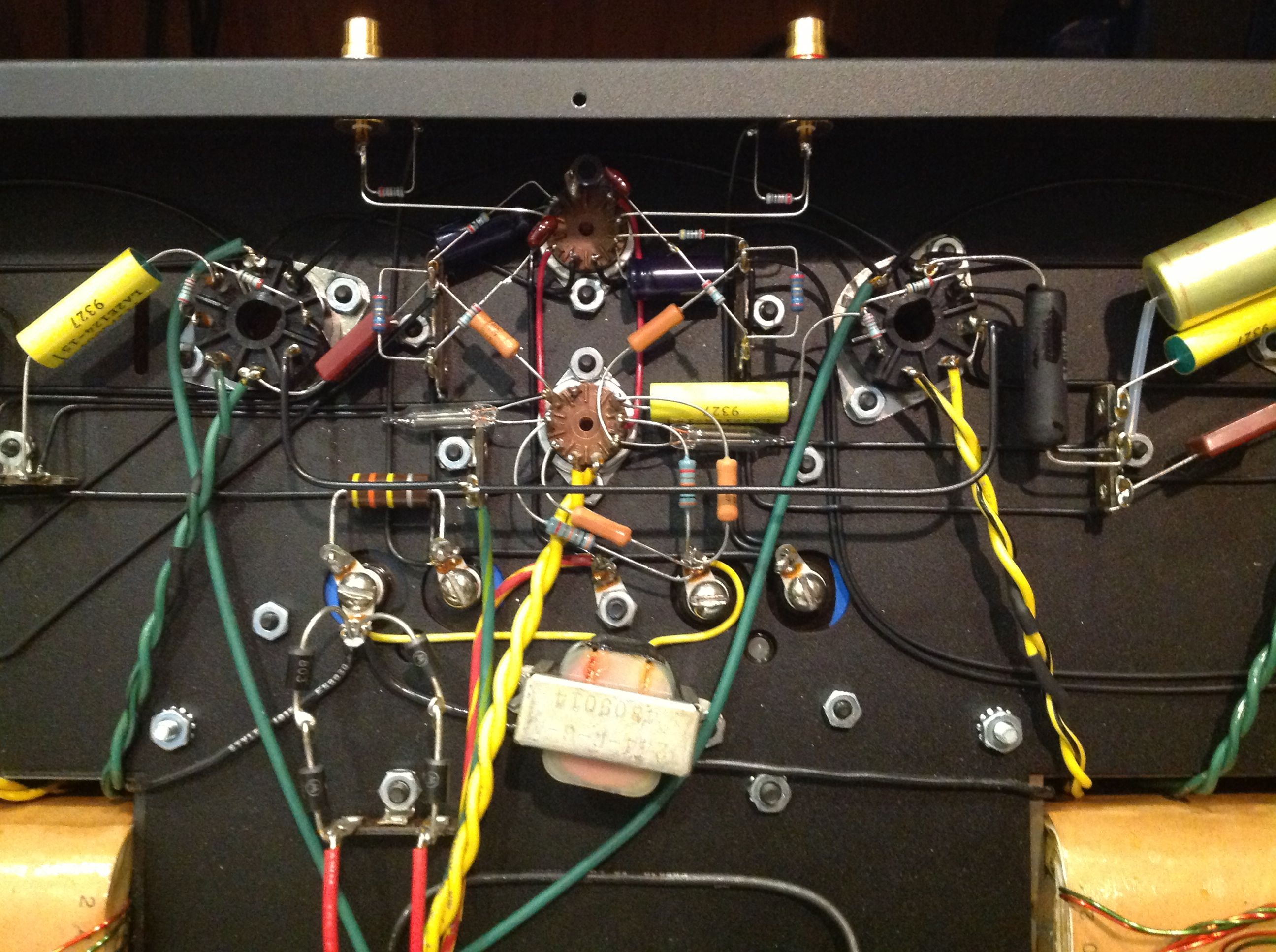

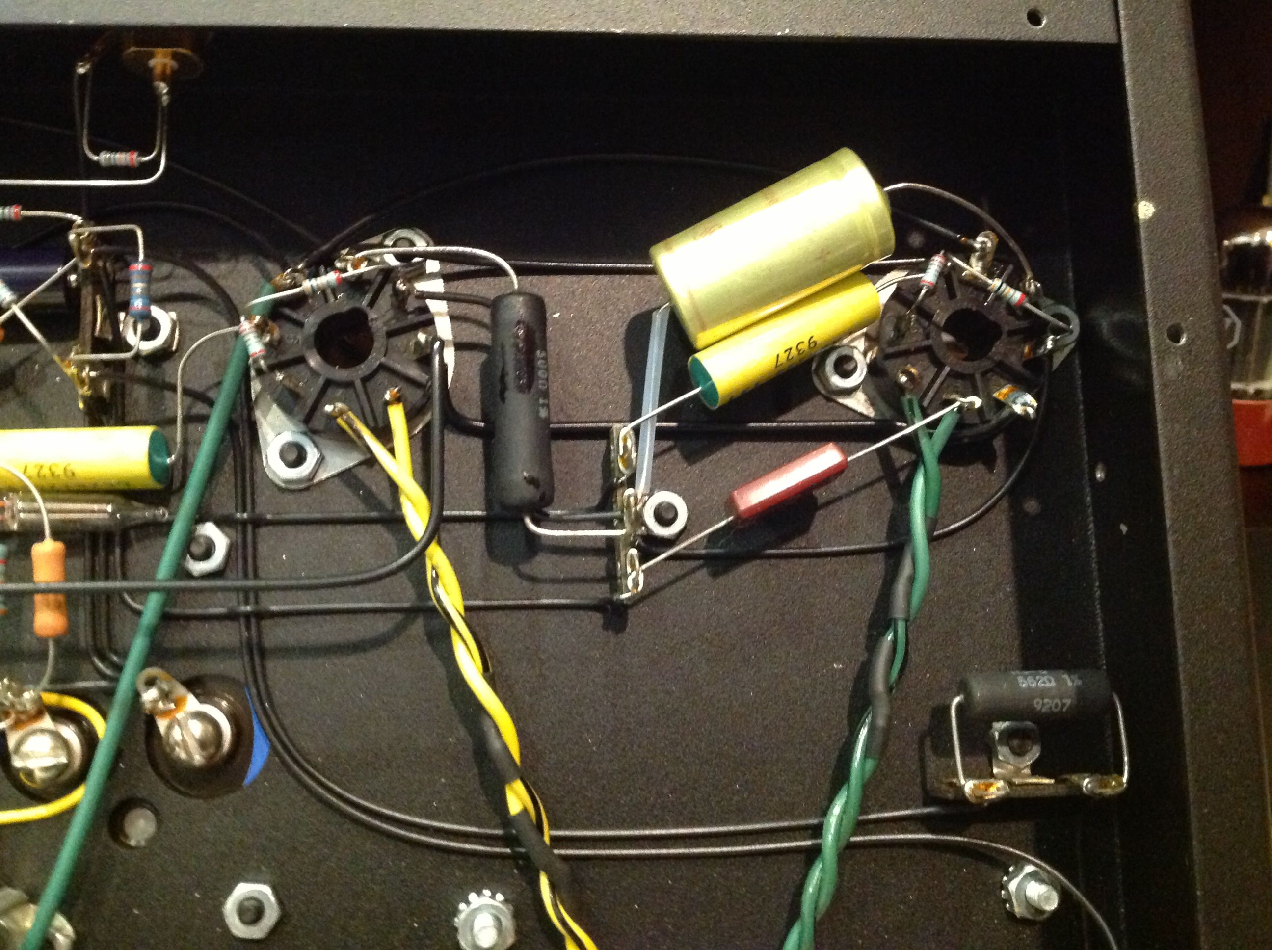

Filament wiring is hopelessly wrong laid-out. Tightly twisted leads should supply the pre-tubes and have a couple of 100-ohm resistors series-connected across the supply with the center of the resistors connected to star-ground (If the filament transformer doesn't have a centered supply with the center connected to star-ground)

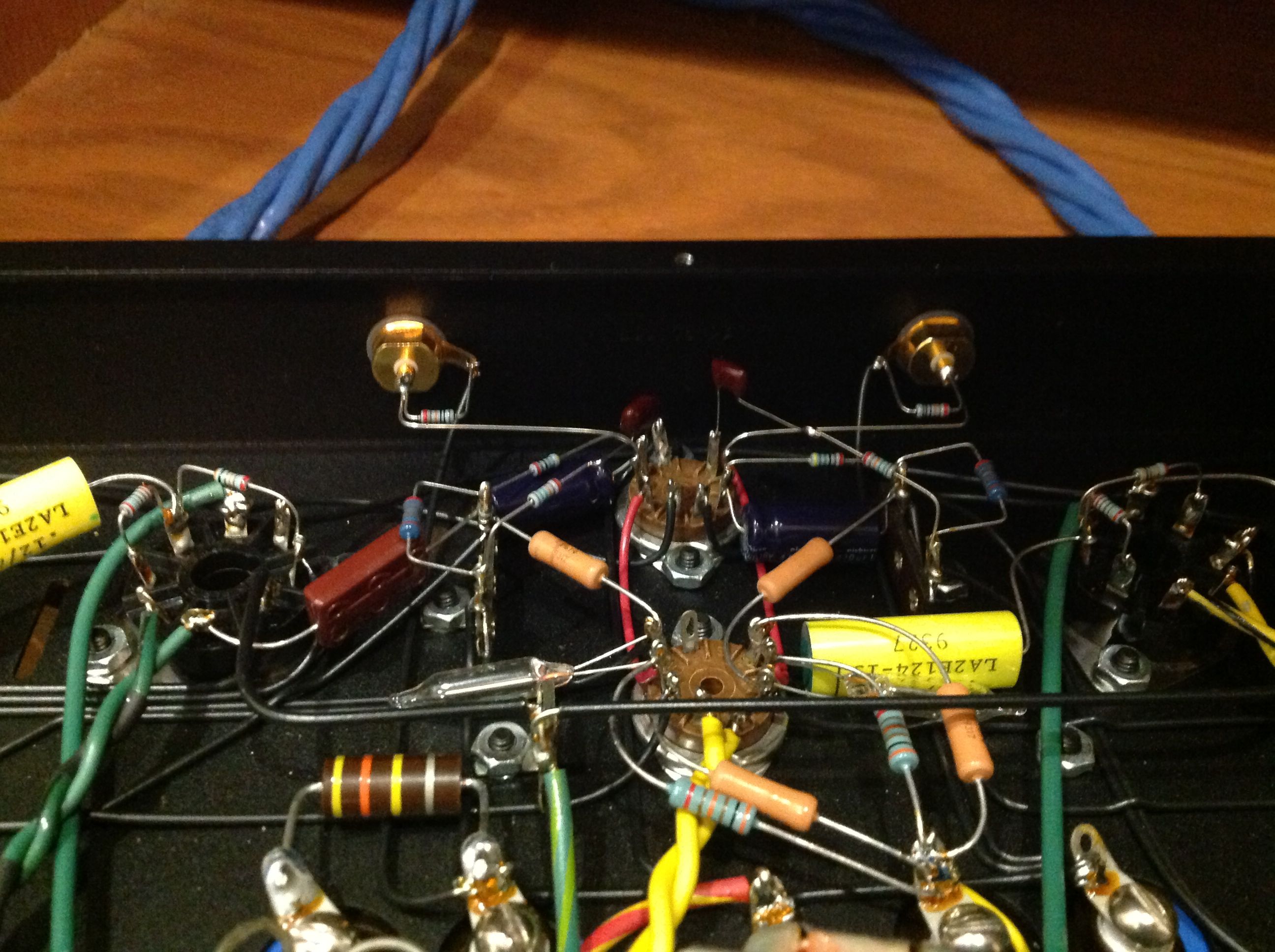

Since the input RCA's are so close to the pre-amp tube I suppose the use of shielded cable from them won't make any difference. However, the RCA's should be floating (NOT connected to the chassis) and the ground-lugs should be connected to the star-ground, directly. Strap from one RCA to the next and on the the star-ground.
There's still a possibility that this re-wiring will not cure the hum-problem.

The construction looks very amateur for a modern company. Start simple and ground the chassis before going to any exotic measures.
As I pointed out - it is not clear that the photo is of the OP's actual amplifier so we cannot be sure what steps are required. Even then, some simple remedial measures regarding the grounding and heater wiring would normally be enough to take care of the hum issues. The OP says they are new to electronics - describing the use of differential inputs, op-amps, etc is probably jumping in at the deep end.

Quite right probably best not to rely on images of another, but related amp. The images I have now posted are of my amp including some up close pics. To my untrained eye there are no major differences between the layouts of my amp and the one I posted from the web. But I defer to the combined expertise of the people on this forum

I'm sure I must be imagining this, but the ground wires from the input sockets appears to go straight to the ground tags on the two fat electrolytics. In the case of the white (Left?) channel this appears to be the reservoir cap. I could not imagine a better way to inject buzz from the PSU into the signal circuitry. Whoever wired up this amp clearly knowns nothing about grounding. It is truly awful! You are guaranteed hum/buzz as soon as you connect anything to the input.
It is a pity you bought it second-hand, as otherwise you could send it back under warranty and demand a refund.

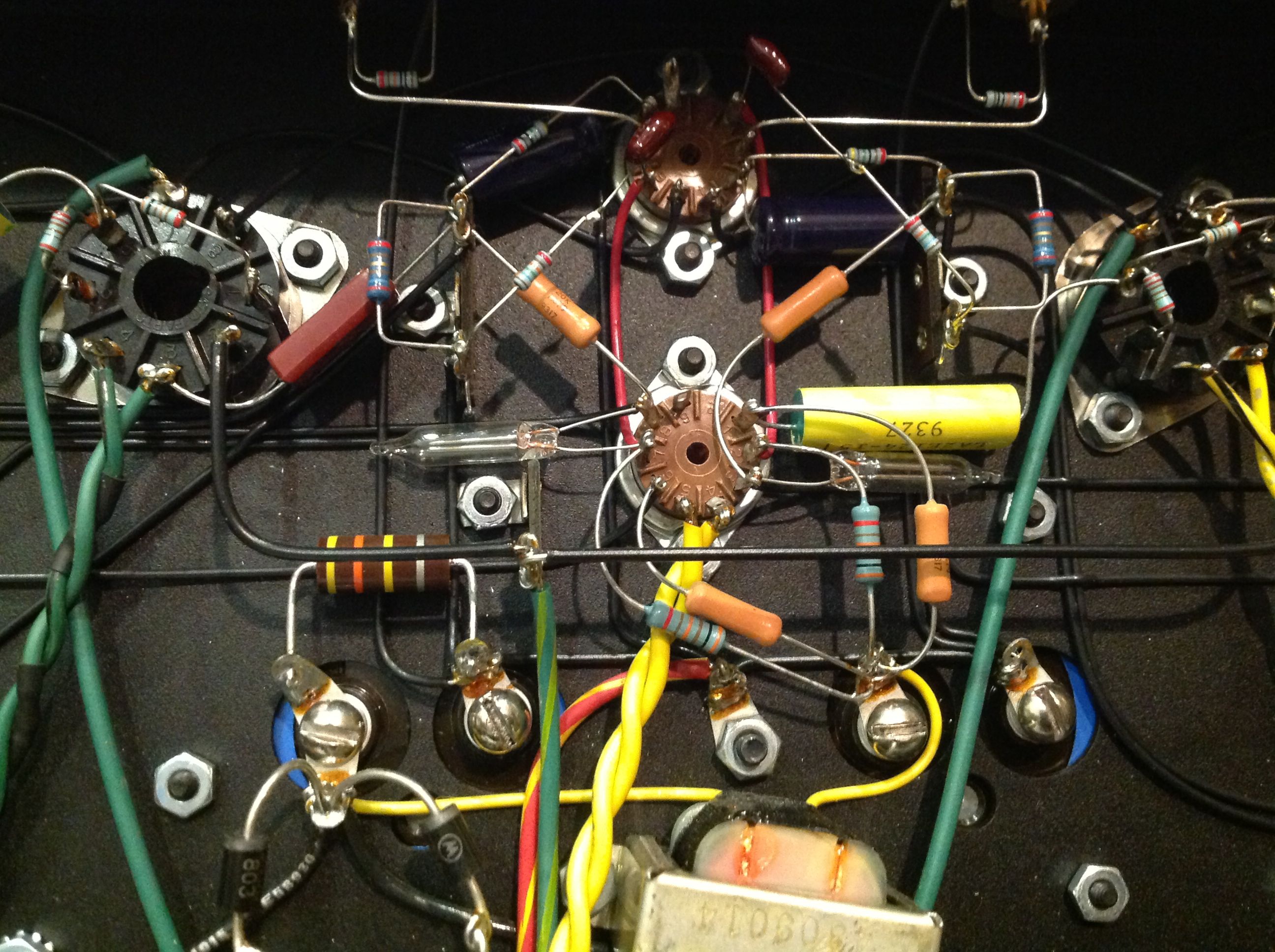

Yea, that's some poor work indeed. Looking at the closer up pics, it appears that the filament winding is 12.6VAC center-tapped and it's likely that a 5-volt rectifier winding is wired to the filament on the lower 9-pin tube. The upper 9-pin tube is wired in with the octal output tubes.

Yes, I was previously thinking about replacing the two prong cord with a three wire grounded connection. The power slider switch is also pretty flimsy and really not easy to get to.
However, as a quick an dirty experiment to see if grounding the chassis would help or hurt the hum issue I connected a line to earth ground to a bolt on the top of the chassis. Not surprisingly this made the hum worse
