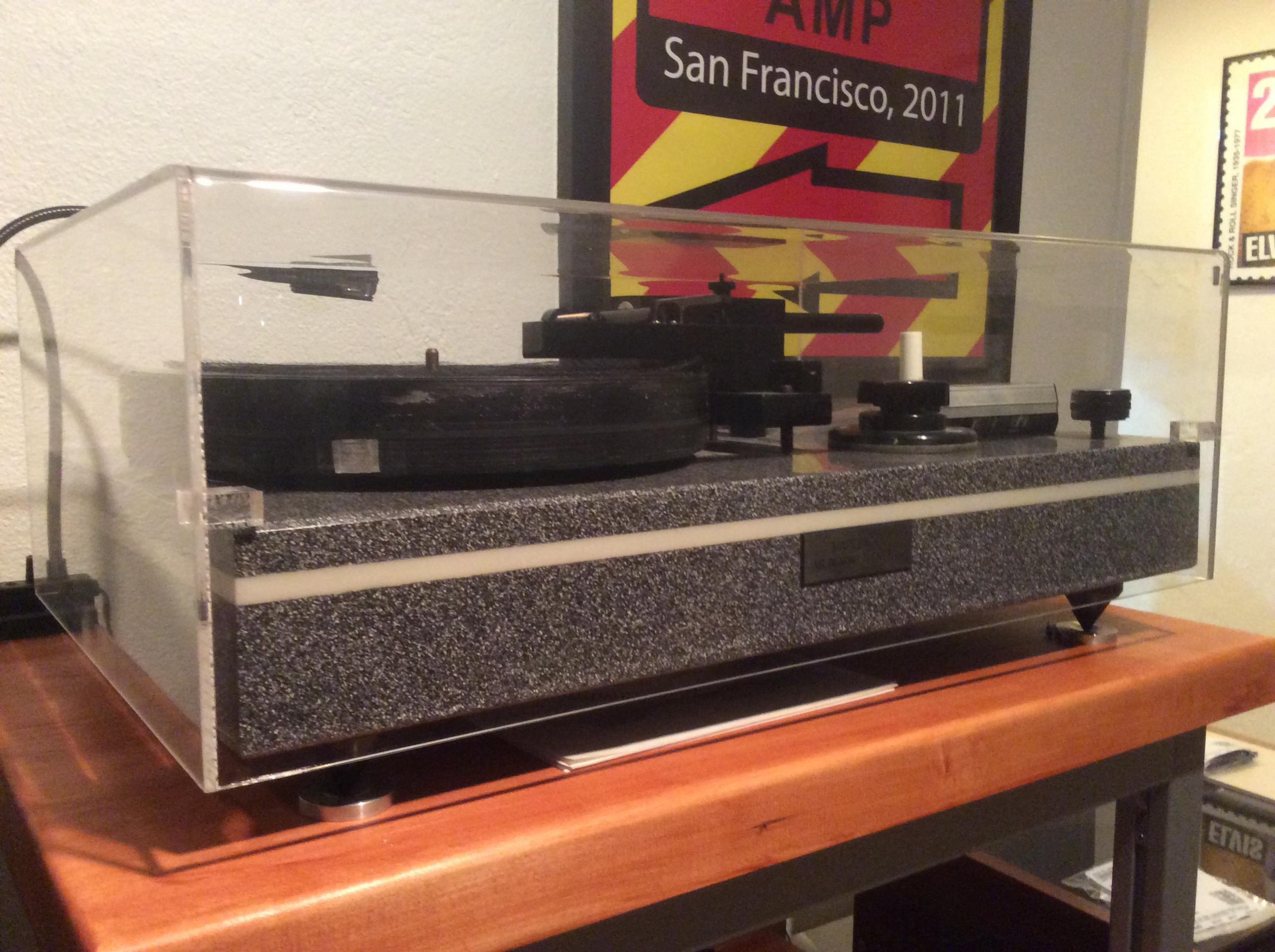

I had this acrylic turntable cover custom fabricated about 25 years ago; it has stood the test of time quite nicely. The design might work well for you: the cover's width and depth are just slightly larger than the turntable plinth (perhaps by 1 cm). The four acrylic cubes are positioned so that there is clearance for the tonearm and air manifold (it's an air-bearing arm). You could probably do something similar for your amp.
Scott
This is basically almost what the rayma suggests, just slightly less tall.

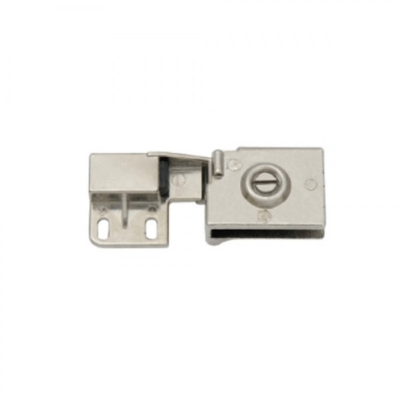

I don't know how to search for these in English, so I post pics... The first is for mounting glass shelves on the wall under mirrors etc and the other is hinge if you like to make it old TT style. Here we find them at DIY furniture stores and the alike.

The first picture looks not bad and the design does look a bit "Art Deco " could have done with a longer slot as the strain ( forces acting on the cover ) is more intense in a small slot but it would do .
Don't like the other picture at all it would take away the classic look of the amplifier ( cheapen it ).
