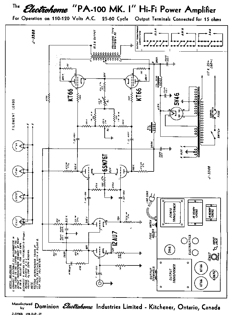

How about starting to give some photos with the used wiring?
Although the circuit is a "relatively basic Williamson with about 6 caps and 20 resistors.", a circuit
diagram is still of much use.

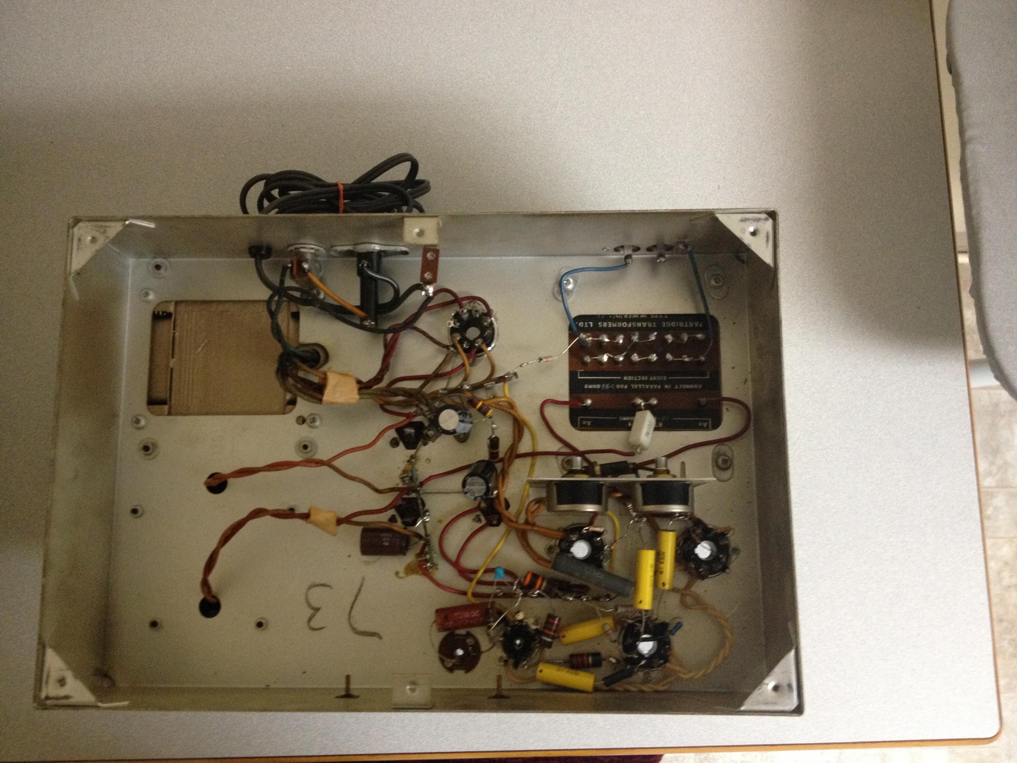

bolly, are the filter capacitors still connected to the circuit??? If they are, stop using the amplifier immediately. The old caps must be disconnected, and it looks like cheap capacitors were used with the old terminals to support them. Who did the work?

An even earlier stage should be making sure to survive the fault finding. Looks as if the unit has a two-wire mains connection with one of the leads directly connected to the chassis. Wouldn't want to power this one up without an insulation transformer.
Rundmaus
The circuit doesn't show that, and the underside photo is unclear, so probably OK but worth looking at just in case.

Rundmaus, every PA100 and PA100 Mk1 is wired the same, with the chassis ground. I've used these off and on maybe 10 years without much problem, whats the isolation txfmr for?
