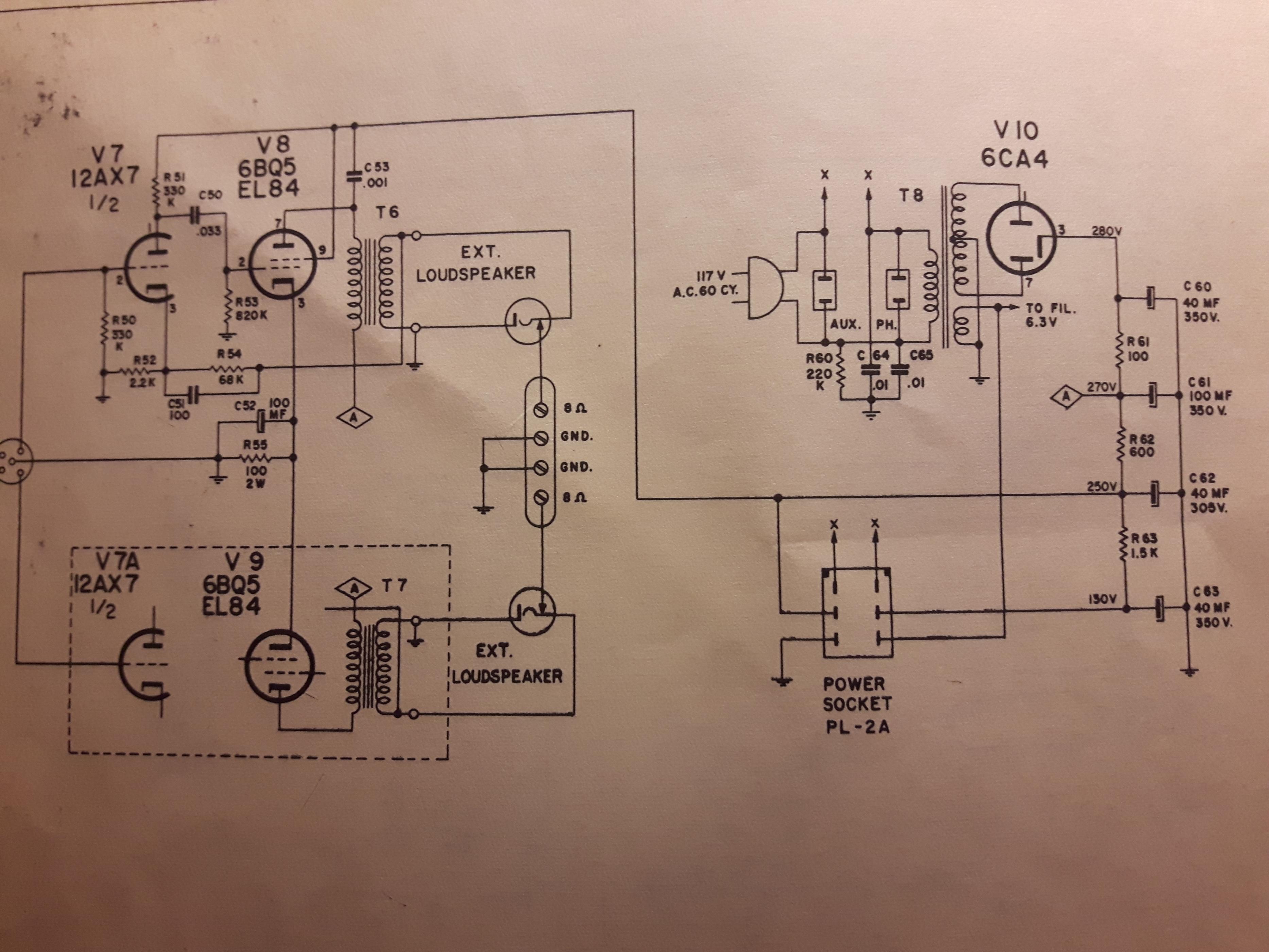

The amp is an old SE 6bq5 power amp from a stereo console. It has a single 12ax7 and a 6ca4 rectifier. I recapped the amp fully, and also moved the RCA inputs to a different location for convenience.
I'm getting significant continuous buzz through the speakers. I thought it may have been a ground loop issue with the RCA inputs, so I disconnected them, and now the buzz is even louder with very high frequencies hisses.

Short the inputs or the (triode) grids to ground. Use leads as short as possible and listen if the hum goes away.

I've moved the RCA inputs to the location of the optional external speakers since there were RCA connectors in place. I moved the wires from the 12ax7 to the positive RCA terminals, and I grounded directly to the chassis, instead of grounding to the C52/R55 as shown in the diagrams. Could this be the main issue? The buzz and hisses are even more pronounced when I don't plug anything in the RCA inputs.

Try grounding the RCA to the junction of R50/R52. Make sure you are using shielded cable.
The input grid (pin 2) may be shorted to the same junction.

I looked closer at the diagram and the amp now, and there are some differences in the ground locations.
The RCA inputs are grounded directly to the chassis far from the original r55/c52 location.
Also, the electrolytics capacitors (c60, c61, c62, c63) are grounded to the r55/c52 location instead of the original location on the chassis.
Yes, rectify the above and let us know how it goes. Multiple grounding points are found in old equipment and lead to ground current problems.

Put the grounding back where it was and it is likely that the problem will be solved.
If not, exactly what did you do in 're-capping'? Were all cap changes strictly like-for-like, or did you attempt an 'upgrade'? Cap 'upgrades' can easily ruin a circuit.
The symptoms you have sound like HF parasitic oscillation, probably in the power stage.

The capacitors were changed with the same values as the originals.
One of the newer cap only read 88 uF instead of the original 100 uF, but I don't think this should make such a big difference?
I've moved the filter caps ground and the power supply ground to the initial location but the buzz/hiss is just as bad.
Could it be a bad ground of the audio input?
The buzz/hiss seems worse when the preamp is not there (just the speakers connected to the amp, and powered on).
