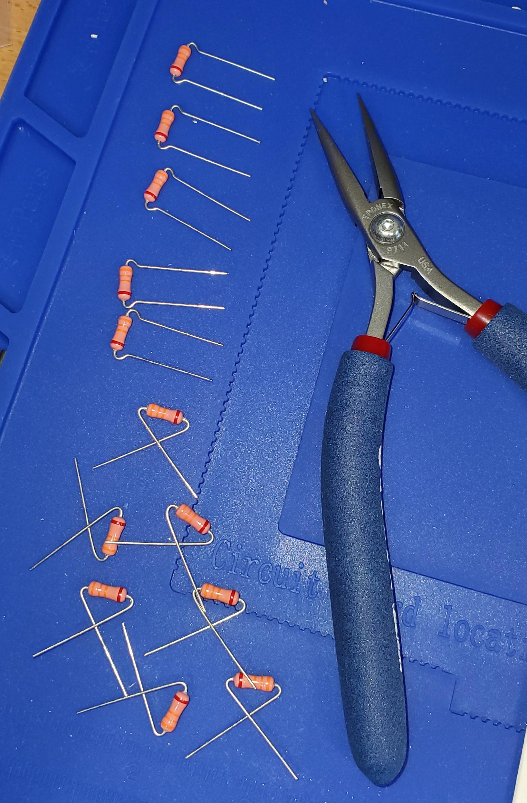

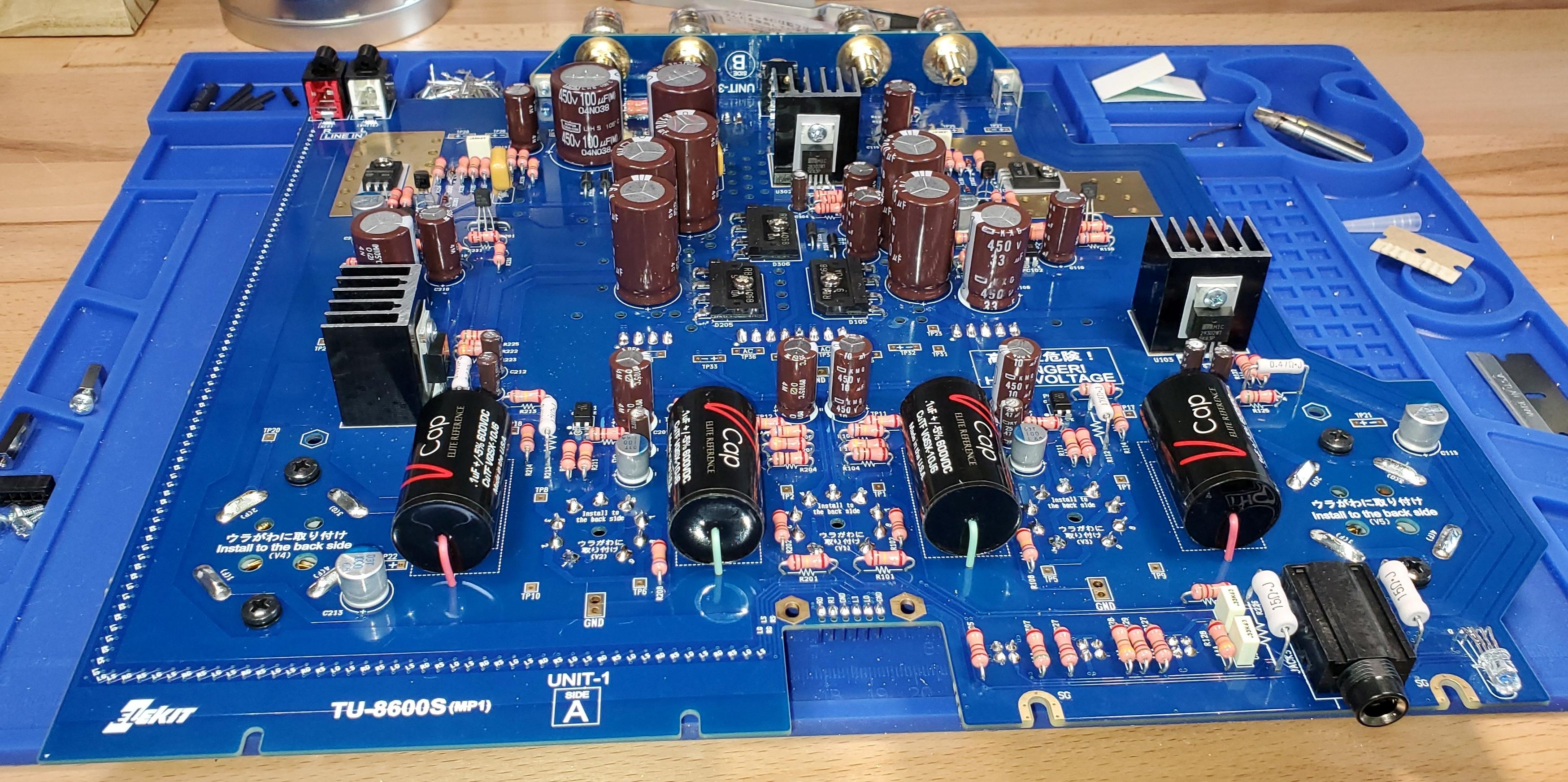

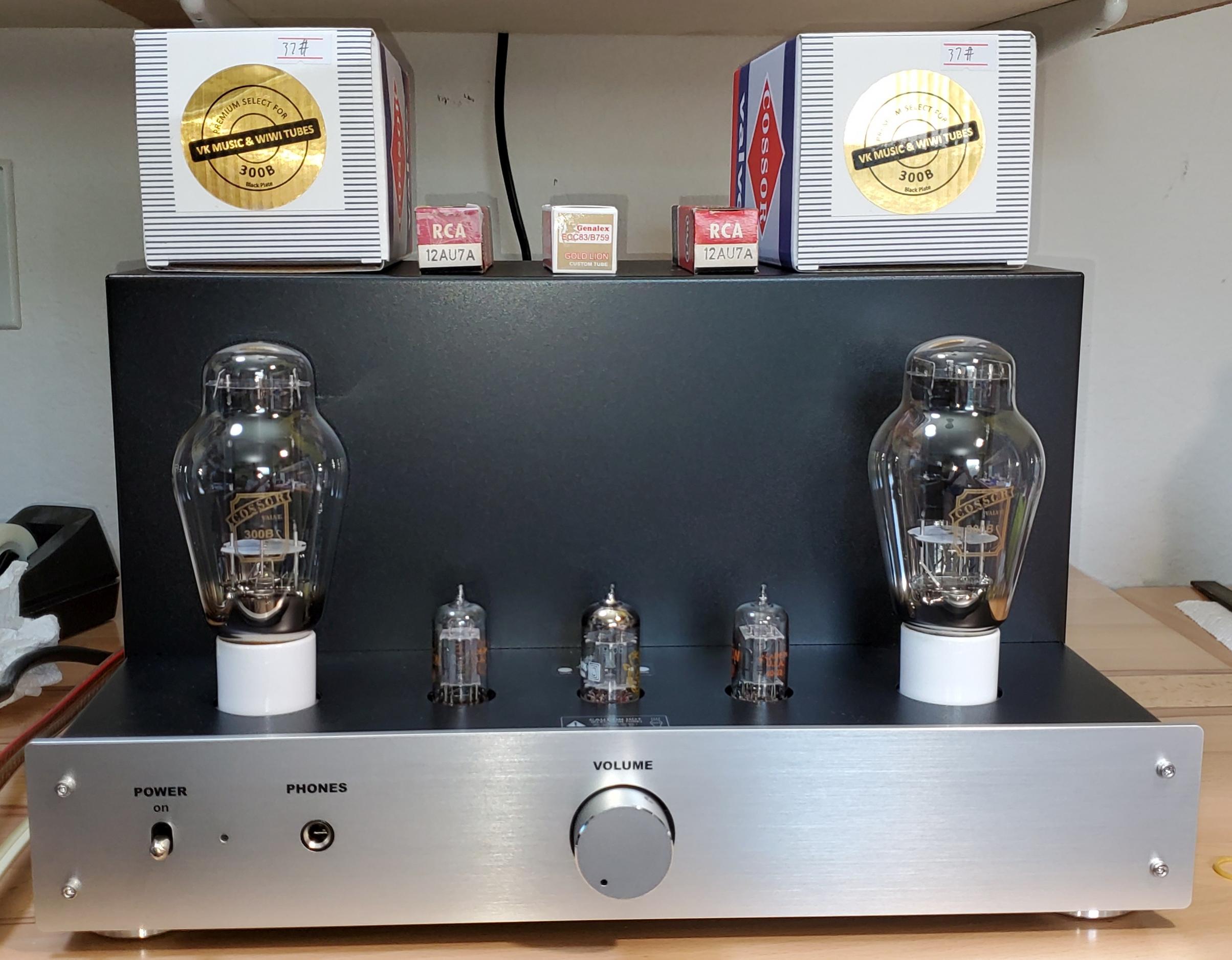

I finished building my TU-8600S amp over the weekend. I very carefully followed the instructions in the manual and the tips that Victor gave me. I double-checked all solder joints and component placements.
It worked the first time that I powered it up. It is dead quiet when the volume is turned all the way up with no music playing.
This is my first tube amp and is by far the best sounding amp I have ever owned.
I ordered all the upgrades. I have attached pictures of the Takman resistor preparation, orientation of the V caps, wire routing of the primary connection on the Lundahl OPTs, and tubes used.
I will be rolling tubes in a few weeks, after I have gotten familiar with the sound of the amp.
Thanks again to Victor for the great service he provided to me and his great dedication to our hobby. I appreciate that he brought this 300B amp kit to us and made it so easy to get the upgraded components.

It seems from one of the pics that you installed a TKD CP60x pot in your build.
What is the length of the hex spacer you used between the main PCB and the pot PCB?

The TKD upgrade came with the hex spacers needed for the install. I did not measure them with a ruler so I can't answer your question specifically. The next time I open the cover, I'll measure that for you if someone hasn't answered the question by then.
Thank you Rock Ball. I will ask Victor for the info on the spacer.

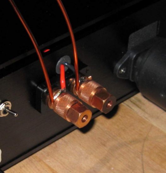

What stops me from going onboard with tube connectors is that it still introduces connector metal and solder joint in the signal path. If I'm going to go through the trouble of bypassing binding posts, I figure I would go all the way and go for wire-to-wire contact For example, I saw this once..
That's a really interesting picture. I see your point and like the idea of using what's in the picture. That seems like an easy mod.
The hex spacers that come with the TKD upgrade are 16mm long.
