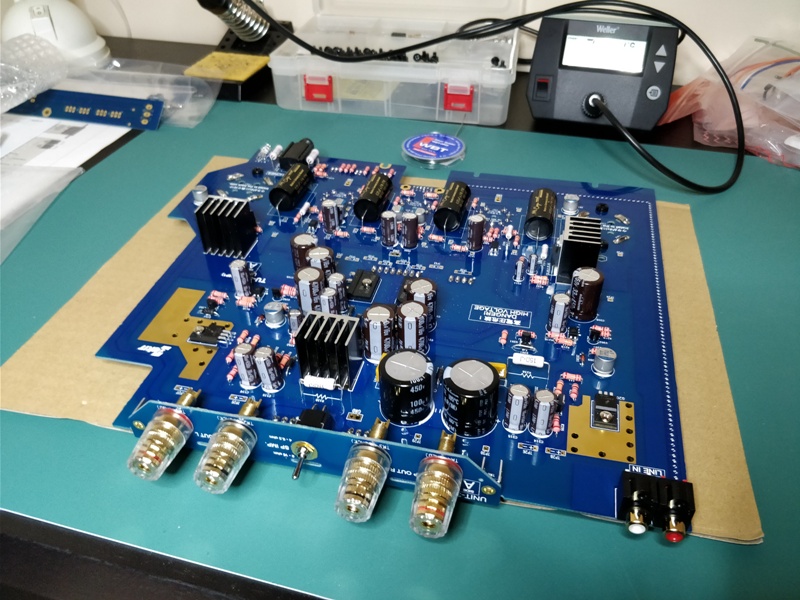

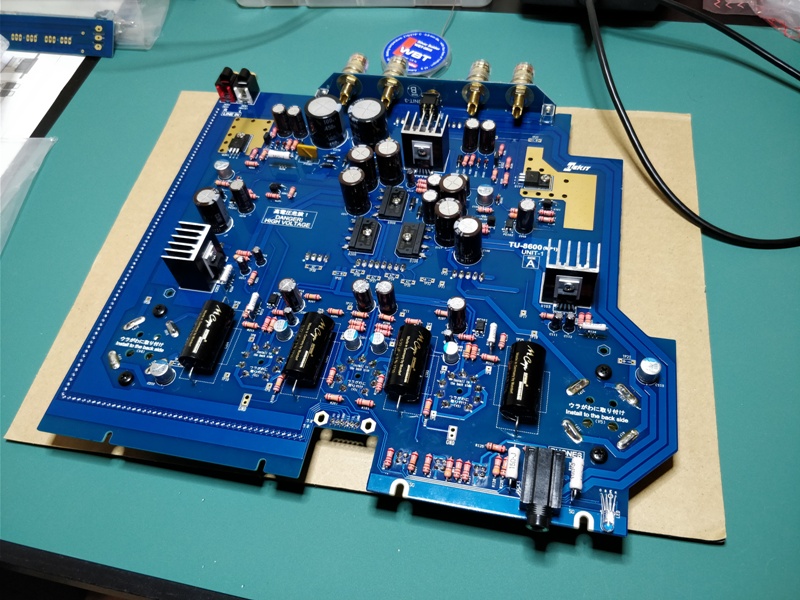

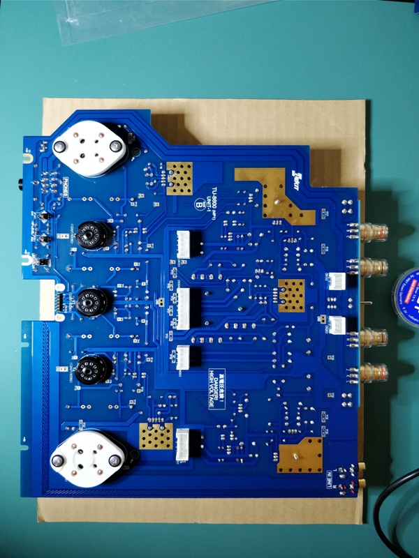

Just to describe my experience in building Elekit TU-8600. I bought the kit as well as the optional upgrades through Victor.

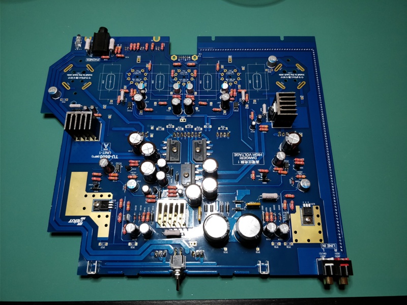

The PCB layout was great and in no time i had the resistors mounted and soldered. Soldering with Weller using 350 Deg and WBT silver solder was the best and resulted in a clean job.
Then i got the Diodes followed by the Capacitors on the board.
After every step i used a magnifying glass to make sure that there are no bridges whatsoever and to inspect the solder joints.

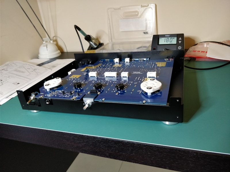

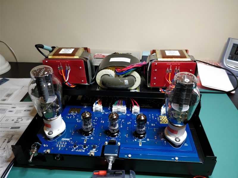

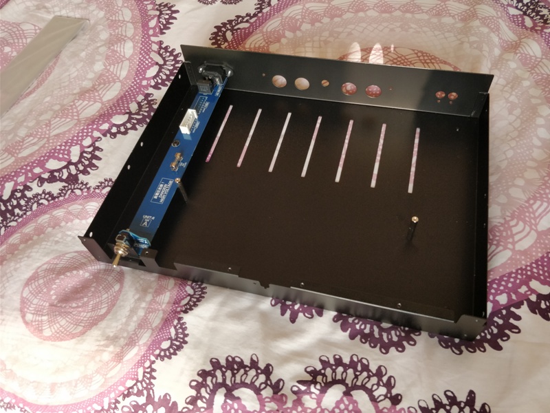

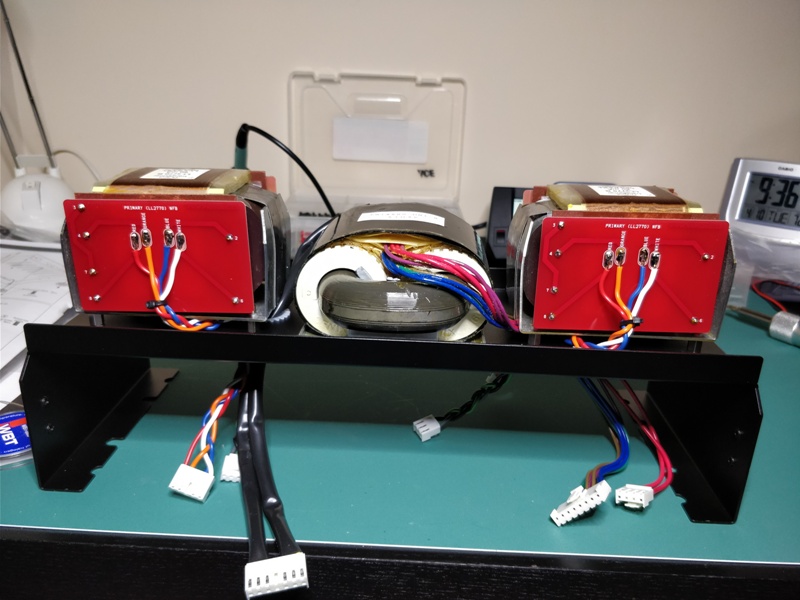

Next i soldered the special PCB victor supplied for the Lundahl, mounted the main board to the chassis and fixed the transformers in place
I connected all the cables, fixed the tubes, powered the amp and did a quick test with all the test points.
I knew at this stage that everything was right, connected the amp and voila there was sweet music on my speakers.
Victor has been an amazing guy, who responds faster than lightning, I needed help on the ALPS pot and in no time Victor sorted it out. Victor's passion for the hobby is tremendous.
The amp sounds great and it stunned my Primaluna dialogue premium Amp , It is dead quiet and the sound-stage is amazing, Nils Lofgren- Keith Don't Go came alive and i could hear details which were all hidden before
I am totally impressed and a big shout out to Victor for everything.
