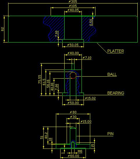

Hi Jerry,
1. Don't forget about thrust plate, i.e. special insert within the bearing housing, facing the ball and bearing the axial load. The contact surface with the ball is of primary importance, should be very smooth ( SS mirror, teflon, delrin), otherwise bad vibrations will be induced.
2. Moreower, ball-plate contact need oil to work as it is supposed. Your inverted bearing (ball on top) should have small oil bath on top of the axle - not easy to implement. Why don't you start with convential bearing: ball in the bottom, the cavity is filled with oil.
3. The ball, as a main source of vibration, is placed dangerously close to the centering pin. So, vibrations will be effectively coupled with the record.
Michael
Michael
Hi Michael
Thanks for your reply
I made this drawing in comparison with the clearaudio champion bearing, only bigger.
The top of the pin will be rounded so the contact area will be less than 1mm². The only thing i have to take care of, is that they are in alignment.
But you have got a good point, think i'll make a conventional bearing as well. That way i can realy test if i can hear the difference between the two.

I use a POM ( derlin ) thrust plate because derlin has a good resistance at mineral oils, 0.02mm clearance is too high you may expertise vibrations I use a 0.005-0.007 clearance with a ISO VG 32 - 46 mineral oil for a perfect coupling.

0.02mm is to much you say, ok i'll make it less than 0.01mm.

I made a mistake it's "delrin".
To obtain less than 0.01 mm clearance without a special grinding machine you 'll find useful a diamond polishing kit.
