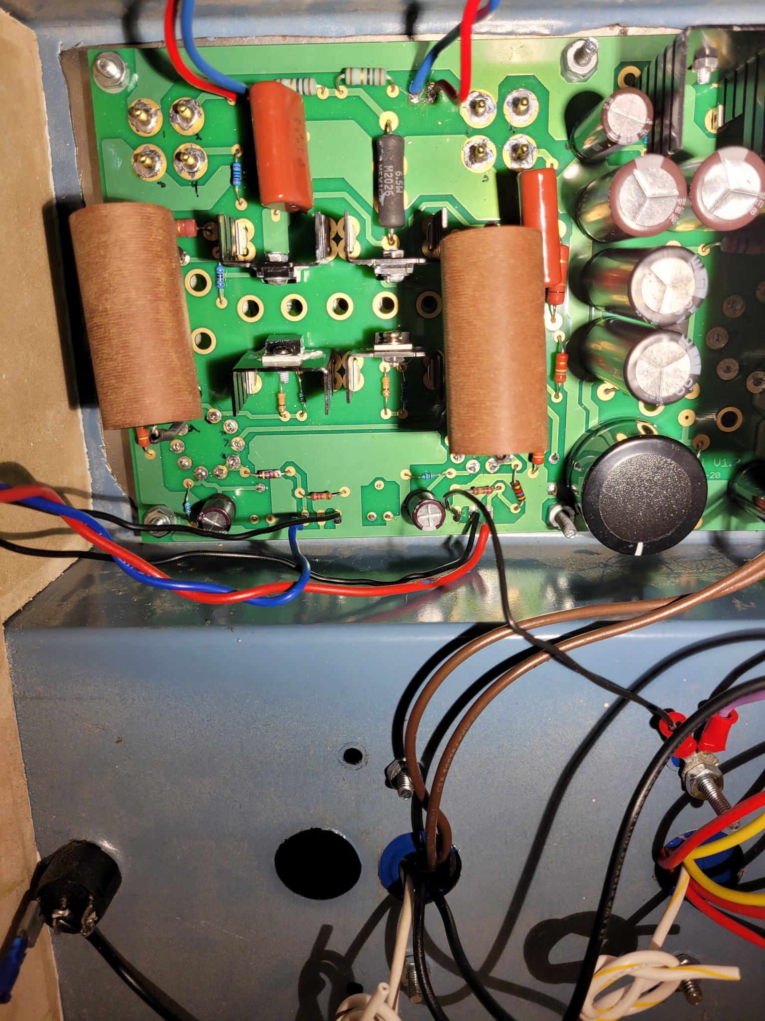

Well seemed like an eternity....the new edcore arrived.330-0-330 or xpwr178-120.
All wired, initial check
B+ -00
B- -169( r6)
Rectifier in.
R30. B+ 428
R6. B- -169
Pins 2 5.2v. 8. 1.3v
Added small tubes 5832
Adjusted to lowest v...approx 140 then moved up to 160v measured at coupling caps.
Installed 300 B
Played some music....adjusted 300b to approx 280/300 v. Music( one side only) went from low volume and distorted to clear and louder
Having trouble with locating issue.
Read a ton on the forum, going in to re check based on the info obtained.

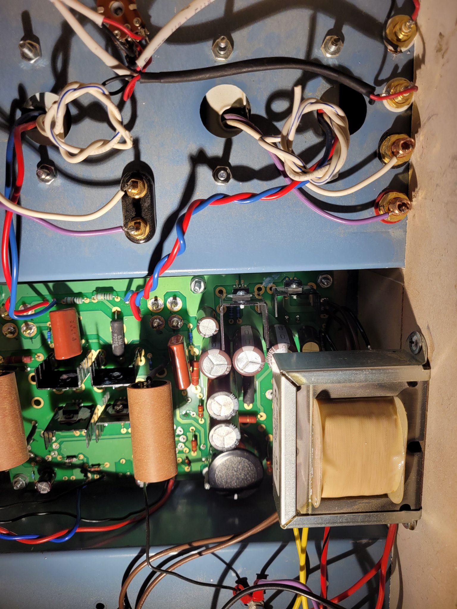

Here are a couple pics.

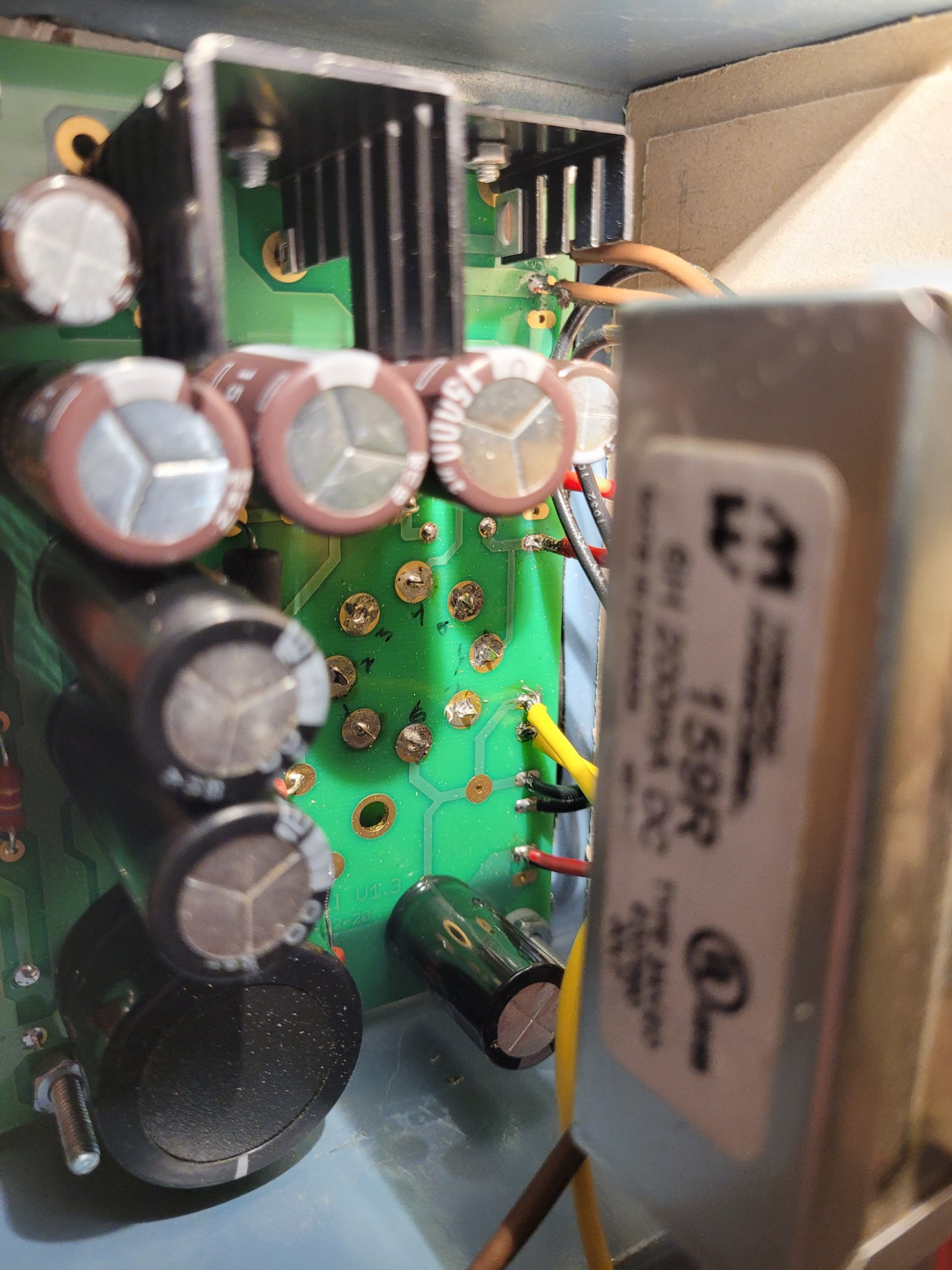

Oh and still with bringing bias (r18 r29) and c11---c9 into spec the v across the choke is still only about 7.5 to 8 v
it is btw a 159ohm 200ma

If I understand correctly, one channel was OK, but neither OPT has a resistance on the secondary winding? That sounds a bit odd.
Looking at your pictures, it looks like you might have made your task a bit hard for yourself. I presume that you have built the board into the case, and are attempting to solve the issues with it in place? Also you don't seem to have used connection blocks, which limits your options a bit in testing, and ease of switching things around to eliminate issues. And some of the soldering looks a bit skimpy, with plenty of the copper pad surface visible.
Sometimes you have to go backwards to go forwards, so I think I would be tempted to try and put the board on a wooden base, use the PCB connection blocks (or use electricians connectiong blocks - we call them 'sugar cubes' in Sweden). Reflow the solder joints, and plan a systematic approach to start up and test. A variac really is so useful when commissioning the board, and I even use a dim bulb in series with that for belts and braces. You really want to try and record the voltages from ground to each tube pin, and sanity check that (report that here). If you have those correct, then it is likely a misconnection of one of the peripherals (probably OPT). I was super careful with my SSE, but still managed to have one connected to the opposite channel to the UL winding!

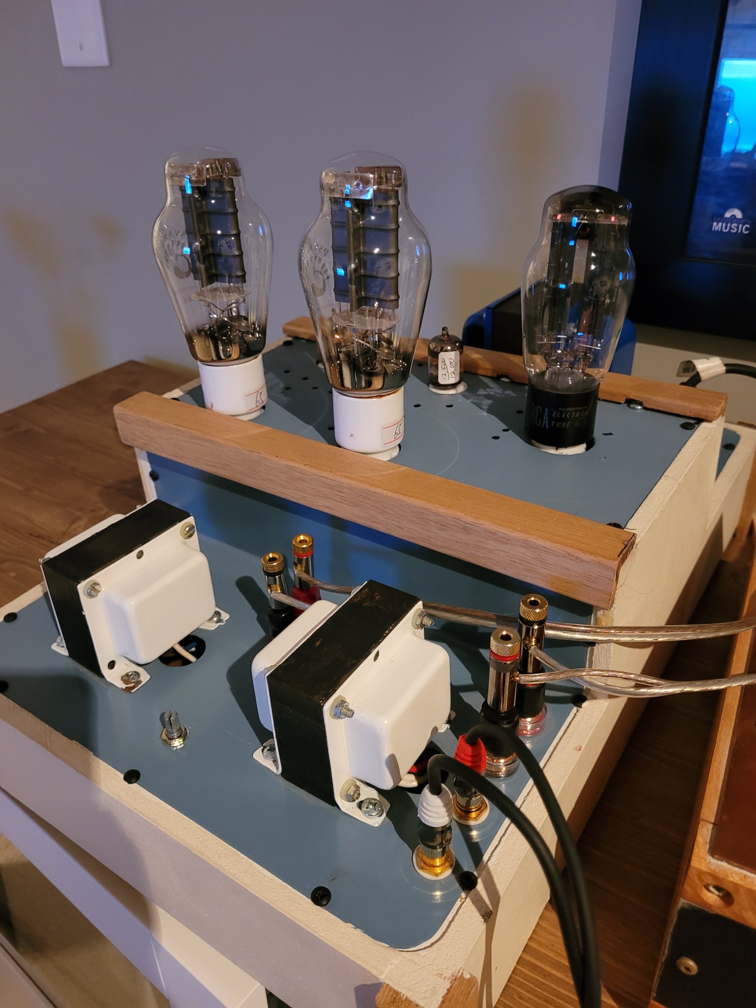

All is good, The Amp has finished burning in, sound is Amazing!!

Well, you inspired me to detach 90% of the wiring, installed the connection blocks, literally checked everything over...and, the easiest check to over look was a bad ground!
I know I deserve the the lashing turns out the input on the non working side was grounded. Seriously I shouted!!!!!
so after enlarging the holes, utilizing some spacers tightened everything up, re checked for issues non found.
Reconnected the wires using the blocks, performed a start up check, all good minor adjustments made.
What happened next was nothing short of amazing,
Joe Bonamassa never sound better, ok he does sound really good the SSE too and on another amp I built!
How ever Happy to hear this amazing amp come lo life!!!!
