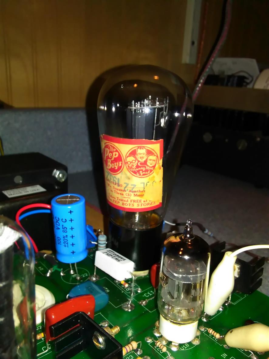

I wonder if it was Manny, Moe, or Jack that tested this 247 on July 22, 1932?
It still works as good as new!
