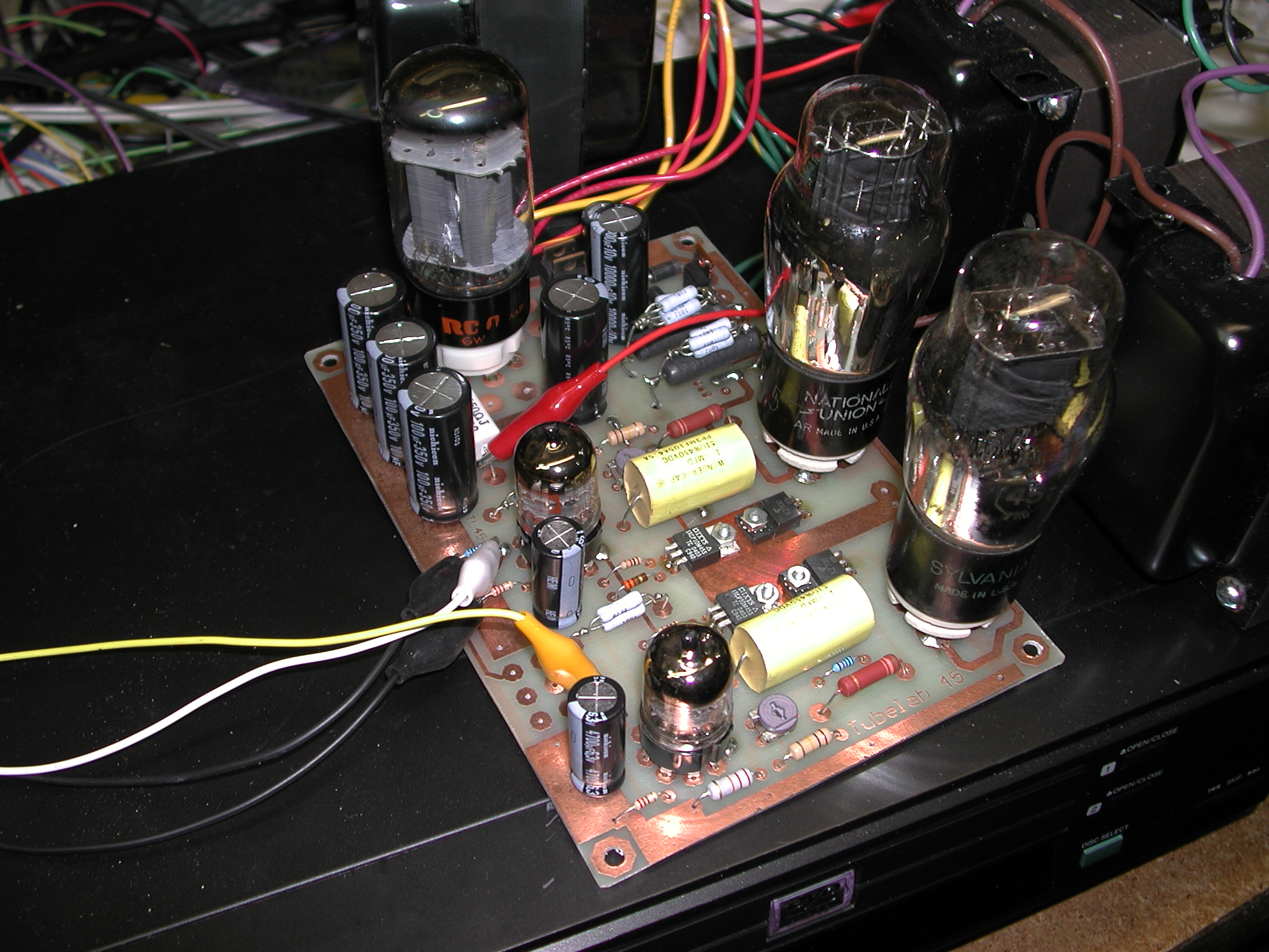

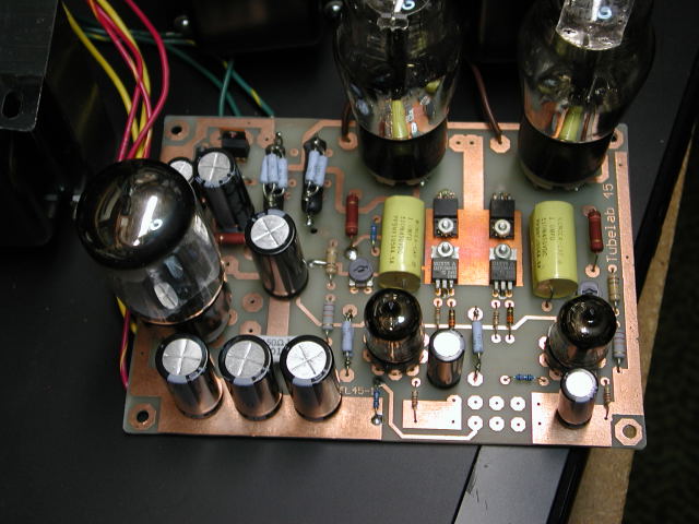

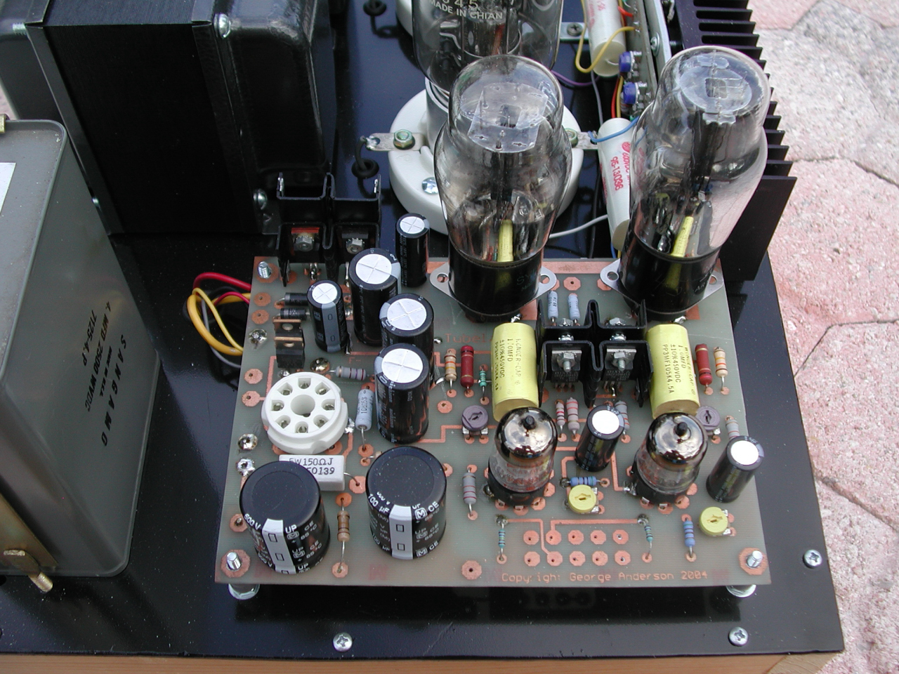

On a different note, I was digging through my hard drive looking for a particular picture when I found this. This was one of the boards I made when I was selling completed amps. It's from a time before Tubelab or the TSE existed. The board was called 45-1, and the name Tubelab 45 came from it's use of the 45 tube, and its origin is from the "Tube-lab" prototyping system (last picture).
I can't even find the Eagle file for 45-1 on my hard drive, but 45-2 is dated Dec 2003. I'm guessing this is actually a 45-2 board, and I was in too big of a hurry to change the revision number. I got up to 45-5 before they became the TSE in 2004, and Tubelab became a real company in 2007.

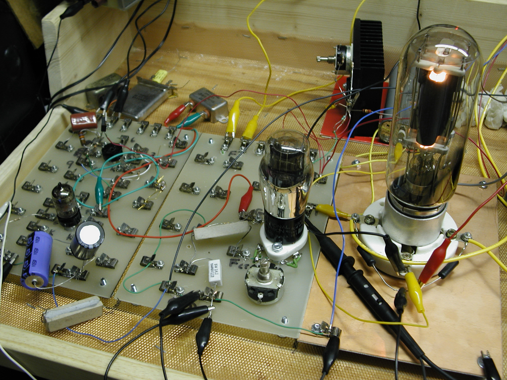

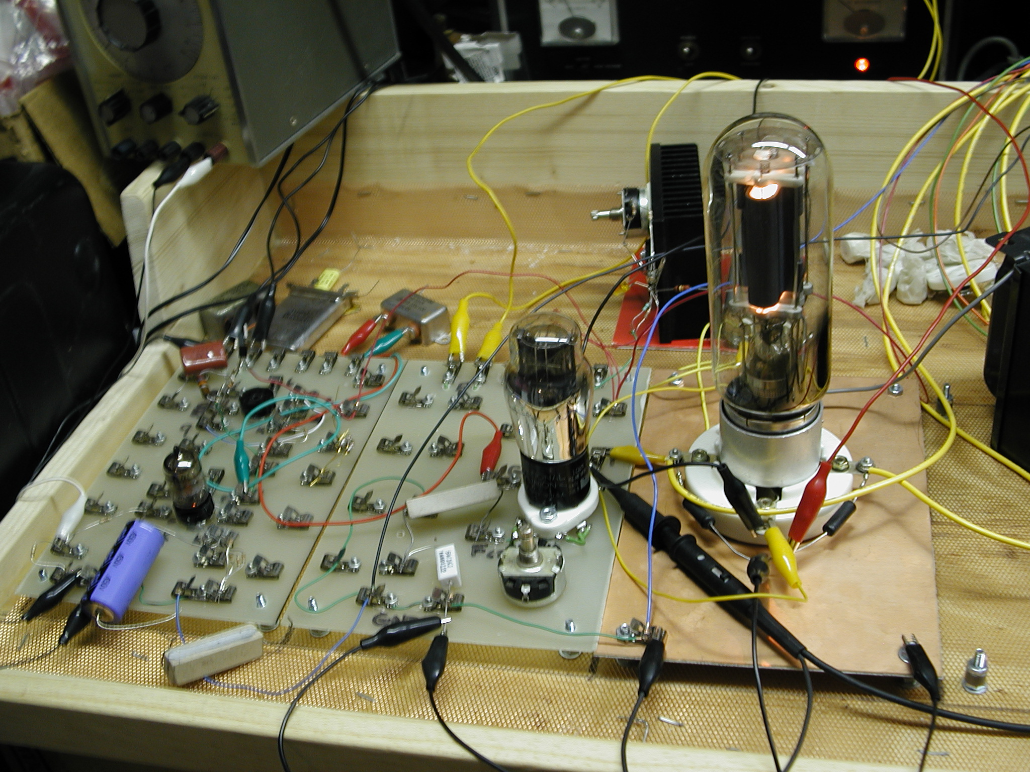

I made a few of these amps, and sold or dismantled most, improving the design each time I made one. An Ebay score got me some OPT's for a bigger SE amp, one that could use an 845 or 211 tube. I had some tubes and sockets, and had built a "poor mans Ongaku" amp for a friend who bought all the parts, but didn't want to play with 1100 volts. I was not impressed with the way it worked, or sounded.
The TSE design had migrated to PC board, and gone through a few iterations, but the design still existed on the Tube-Lab in the closet, so I got it out, upgraded it to match the current design, and added another stage. The IXYS ccs chip can be seen in mid air where the top tube used to be. The 3 "magic diodes" are still in their clips, disconnected. The mosfet buffer between the 5842 and 45 is not present in this picture since it was repurposed to drive the 845. A second CCS is mounted on the heat sink to handle the current of the 45.
All of these improvements including a DC filament source to lower the noise floor and eliminate low level IMD products were added, and eventually became the board now known as the "original TSE."
