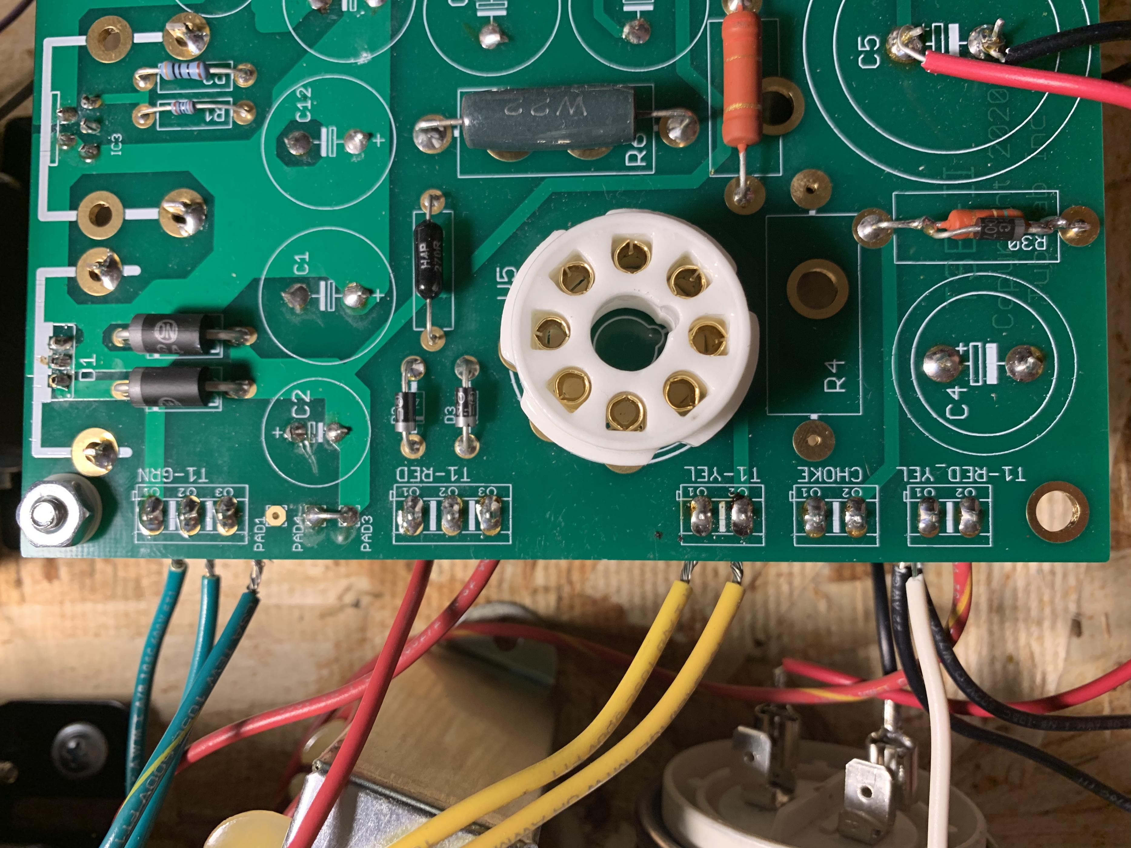

I’m attaching a shot of the left side of the board with the PT connections for reference. (Note the black wires coming into the star ground point are from the inputs. The white is from the IEC earth ground. To the left you might see the terminals of the supplemental motor run cap that’s connected in parallel with C5. The amp is currently just set up temporarily on a piece of plywood for checkout.)

I got the new 5AR4 today and tried the test again. The voltage at Choke 1 without the choke installed came up to 458vdc after the rectifier warmed up, confirming the old one was bad.
I then waited over 5 mins, made sure C4 was drained, hooked up the choke, powered up again with no tubes installed. Voltage started to climb slightly as the rectifier warmed up, followed by more internal arcing in the 5AR4. I immediately shut things down again, disconnected the choke, waited another 5 mins, powered up again, and confirmed that I again have the ~460vdc across C4. So at least I haven't fried the new 5AR4 yet.
So, likely short in the B+ line then? I've checked all the components for correct orientation and haven't found anything amiss yet, but I will check again. Any suggestions about further tests to narrow down where the problem is?

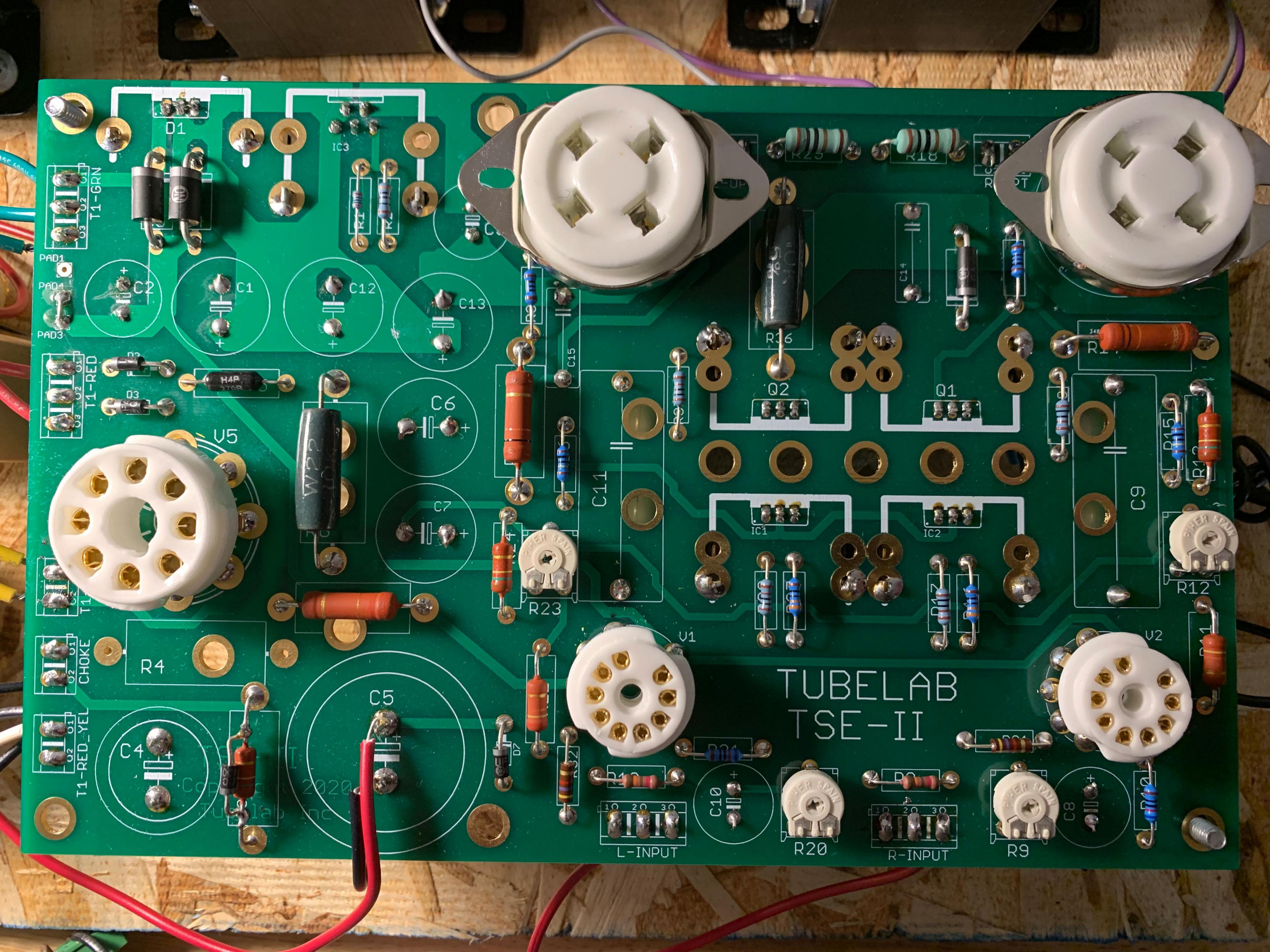

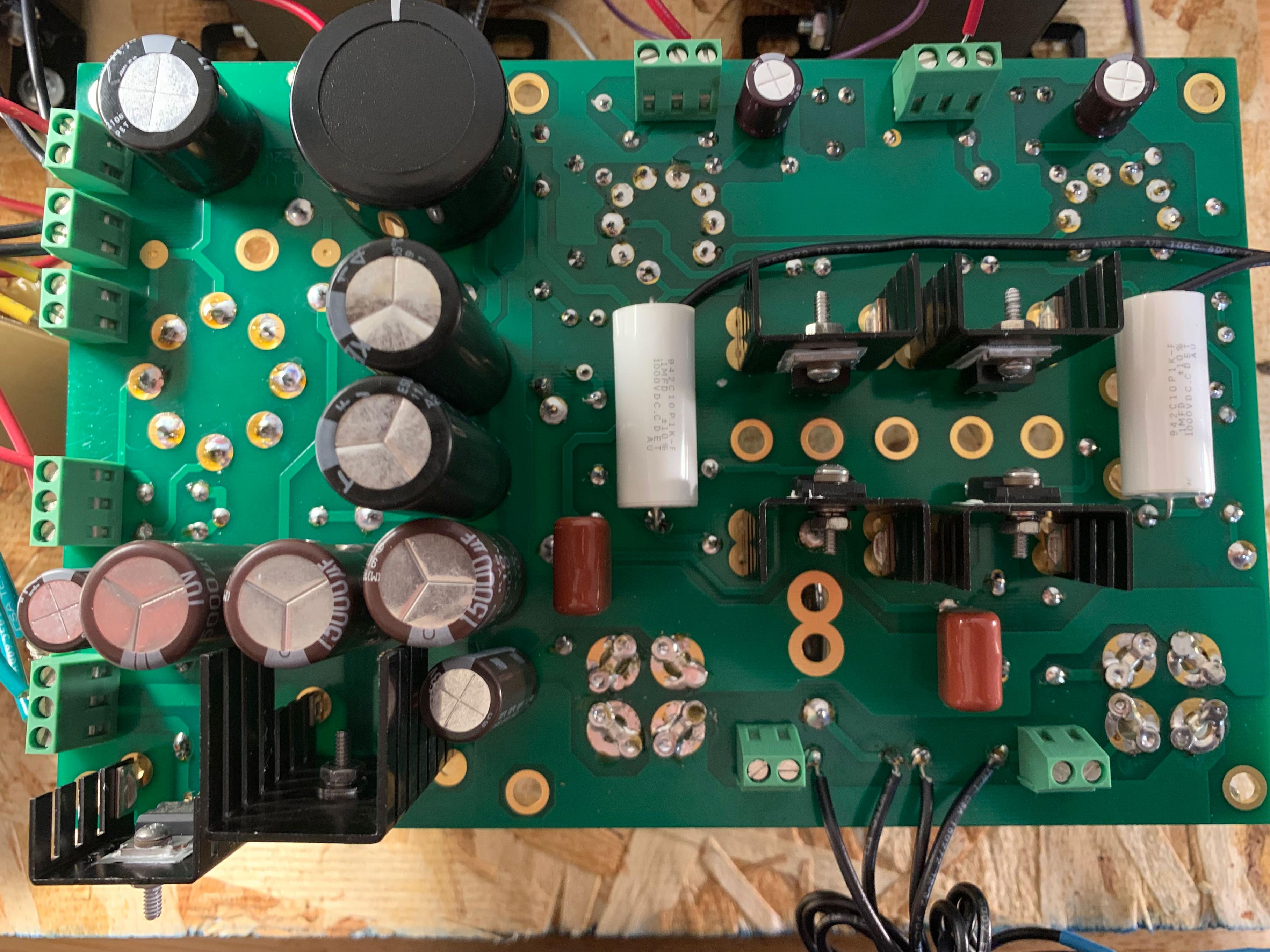

Full pics of both sides of the board attached for reference.

Found the issue. I'd installed a 1N4007 diode across the R30 bleeder resistor backwards. With that fixed, the B+ settles out at about 412v.

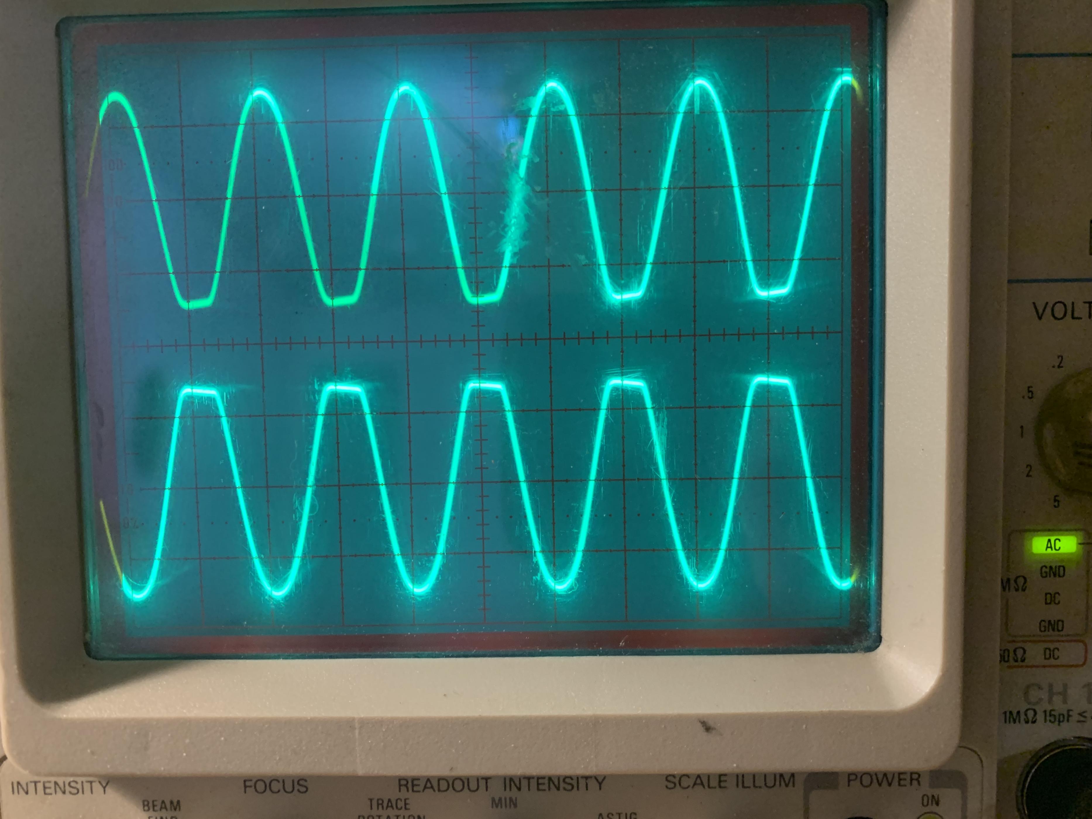

Getting about 5.8w at the onset of clipping, and the clipping is asymmetrical (see attached). It’s the driver stage that’s limiting things here, since I see the asymmetrical clipping at the 5842 plates.

I am still seeing asymmetrical clipping at the outputs though. I'm at right about 6 watts output before that kicks in, which is pretty near what I expect for max clean power. But I wonder if the asymmetrical clipping is an indication of something that may affect pre-clipping performance as well? I'm running the 300Bs at 60mA now, but tried bumping that to 80mA and dropping it to 50mA and in neither case was there a change in the clipping characteristics.

Asymmetrical clipping is somewhat normal in an SE amp.
In a push pull amp you have two identical circuits, each working on part or most of the waveform. Unless something is seriously out of balance the clipping will be symmetrical.
In a Single Ended amp there is only one output device. Clipping is caused by running out of voltage headroom as the current goes to zero (cutoff), or by running out of current carrying capability through the tube - OPT pair as the tube tries to pull its plate down to the cathode (saturation).
Note that at the PLATE of the TUBE, top clipping is from running out of voltage headroom and bottom clipping is from running into tube saturation. These may be reversed at the speaker terminals depending on how the OPT is wound.
Do not connect your scope directly to the plate of the output tube without a voltage divider or HV probe. The plate voltage will swing to nearly twice the B+ voltage under normal operation, and much higher if the amp is hard clipped.
Which of these happens first is dependent on the load impedance, the power supply voltage, and the tube's characteristics which are bias current dependent.
When I'm testing a new design on my bench I use a variable bench power supply so I can find the optimum supply voltage for a given combination of circuit, tube and load. There is usually a few valid combinations of supply voltages and bias currents that will result in symmetrical clipping when testing with sine waves into a load resistor. We don't listen to sine waves or resistors, and all that optimization is lost as soon as I hook up the speakers and crank up some loud dynamic music.
Speakers are not resistors, and rarely even match their published impedance VS frequency curves, since those curves were made with single tone sine waves at a fairly low level.
It is usually possible to adjust the B+ voltage and / or tube current to make the clipping more symmetrical with music into speakers, but that is lost if different speakers are used, or the music being played has significantly different content.
