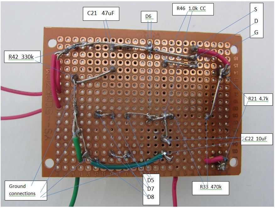

I've only now got around to trying this but I'm not getting the expected screen
voltage, far from it actually.
Last January in this thread I aked a question about lowering the screen
voltage in my low voltage SSE. George suggested using Pete Millet's screen
voltage regulator from his Engineer's Amplifier.
It's a simple circuit based on a mosfet, some resistors and zener diodes.
I used the same mosfet as specified in Pete's circuit FQPF8N60C.
I got all the parts from Mouser.
Assembled it on a piece of perf board and wired it to the SSE as per George's
suggestion.
Powered up with a 6087 rectifier,12AT7, 6Y6G power tubes and 680 ohm cathode resistor.
Checking the screen voltage all I'm getting is 78mV, yes that's millivolts,
B+ and Vp are 296V, just about where they should be, normally Vp is several volts
below B+
I am able to play music but with quite obvious distortion.
I measured the voltage going to the input resistor in the circuit (R21 4.7k) and
it is 296V but at the other end it is only 620 millivolts, I'm assuming this is due
to the effect of the rest of the circuit but I wonder if the problem is actually the
resistor.
This resistor gets scorching hot after a few minutes, I can still feel the heat from
it with my hand more than six inches away !!
At the output end of the circuit (R42 330k) going to screen, voltage is just
78 millivolts.
So I'm thinking maybe the mosfet is bad or damaged, I was careful not to overheat
when soldering. I also reflowed all the solder joints to ensure I did'nt have a cold
joint.

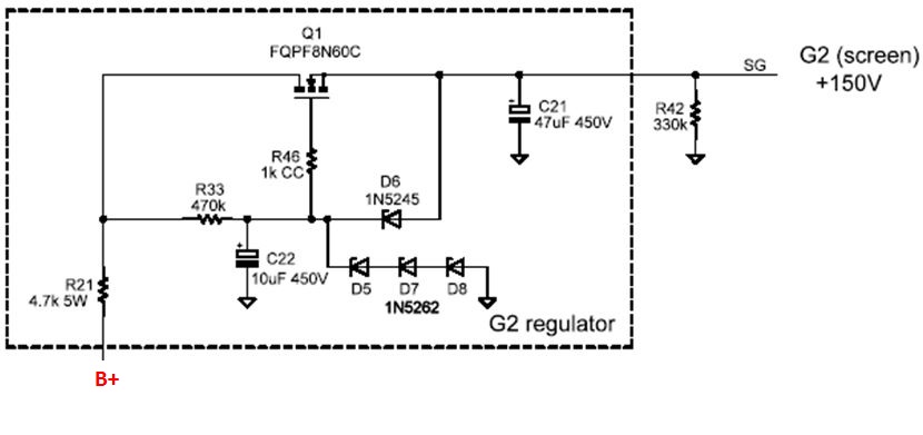

I believe I have the circuit wired correctly. I've attached some photos of the assembly
and a copy of the schematic, maybe George or others can offer comments and suggestions.

Sounds to me like you have a direct short between R21 (colder end) and ground. If the FET was short I would expect a little higher than 150V.
The nearest ground for R21 is the ground point for C22. While I can't test continuity between those two points
I'm getting resistance of about 69.6k ohm and I am getting continuity from R33 to ground of C22.
The Drain of your FET must be touching a ground somewhere. What have you got between Drain and -ve C22/21 resistance wise? It should be pretty much Open Circuit.
Yes, you're correct, there is a short between drain and ground but no wires are in contact. However, here's what I've found, R42 has no resistance, I'm measuring only 1.6 ohm whereas it should be 330k, also, I'm getting continuity across that resistor. I always check resistors with my multimeter before installing them and it was okay then. Don't know what happened there.
I find with that sort of perf board that shorts are almost inevitable. I recommend carefully removing a few of the unused pads around various HV circuit points using an x-acto knife. With care you can make this work.
I purchase perf board from vector that does not have any copper on it for these sorts of uses.

Disappointed to report that the resistor R42/330k is not the cause of the short. When I checked it in circuit I was only getting about 1.6 ohm but
when removed it tested at 327k so it's okay.
It looks like the culprits are those zeners. I isolated them from the rest of the circuit and got continuity between D5 and D8. Also did a diode test on each
of them with my multimeter diode checker and got 0v in both directions. Not sure how or why this happened.
I checked for solder bridges and found none I also checked for shorts between the solder pads close to the HV rail and those close to ground, none found.
Didn't expect to have these problems with such a simple circuit.
I think later I'll assemble a new board, I have spares and I can salvage the caps and resistors from this board.
I'll get perf board without solder pads. How do you guys install mosfets on perf board without solder pads ?

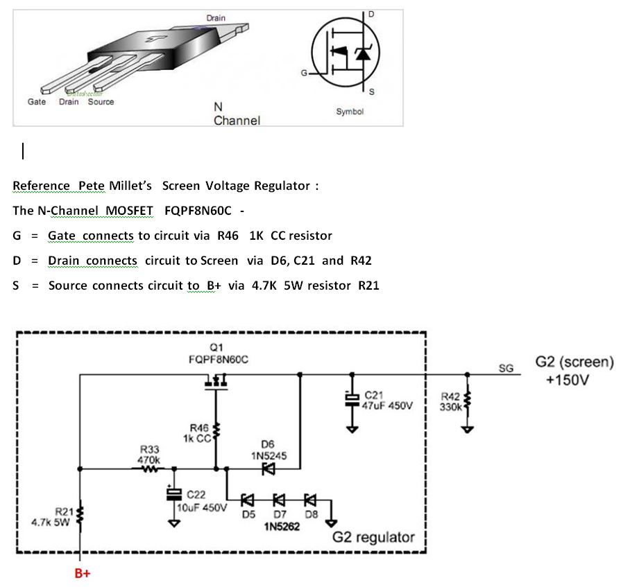

Looking at the schematic, the datasheet for that part, and your pictures, I think you have the connections to the drain and source reversed on that FET. Double check me by all means, but it looks that way to me. There may be other errors, but that needs to be double checked.

Backwards connected mosfets are often just a diode, depending on other circuit factors the gate insulation may fail..(In normal operation most have a reverse biased diode between drain and source.) Candidate for replacement.

Well, that would explain the smoking hot R21. R21 should go to the drain ( middle pin ), not the source.

Just recovering from a severe bout of spring fever these past few days.
Thanks to all for the responses.
Never wired a mosfet before so it does appear that my understanding of the mosfet connections was
wrong and I have the connections reversed - see attachment.
So the correct connections should be -
Gate - pin-G should be connected to circuit via the R46 1k resistor as close to the pin as possible.
Drain - pin-D should be connected to circuit and B+ via R21 4.7k 5W resistor
Source - pin-S should be connected to circuit and screen via C21 47uF cap and R42 330k resistor
You recommend adding a small 100W resistor on the source between pin-S and the zener D6 ?
I have spares and will assemble a new board later when I'm feeling better..
So I finally got around to assembling another screen regulator board. As W5JAG pointed
out I had the mosfet wired in reverse on the first board resulting in it and the zener
diodes being fried.
I got it right this time and it's working fine wired to the SSE board.
