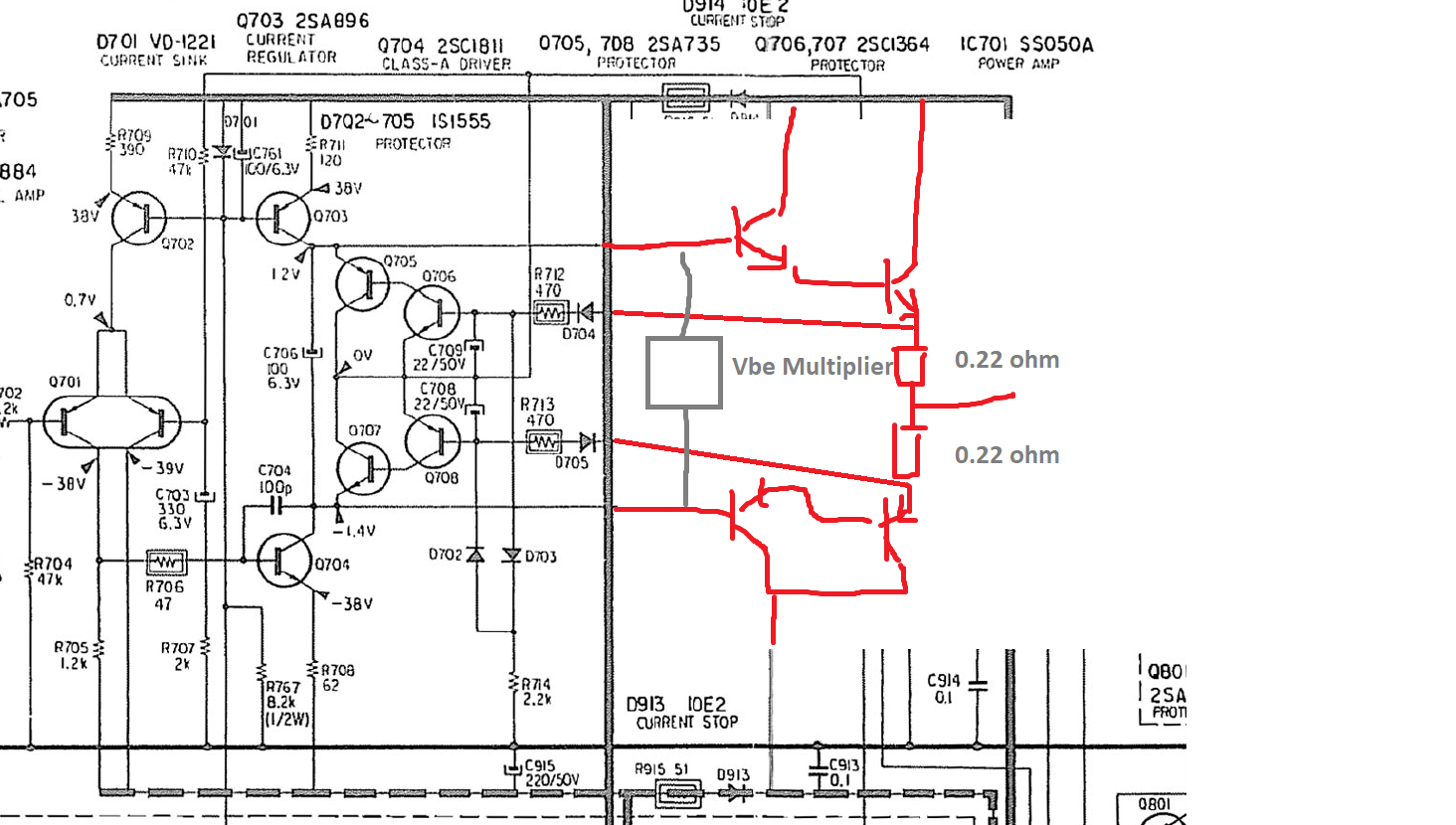

We need a model number at the very least 🙂 and the component references of the burnt up resistor.
Sorry @Mooly I was just getting ready to go out and running out of time 🙂
Sony STR-4800
R763 I believe is the one that burnt (Right channel burnt, only left channel shown on schematic, which is R713 for Left).
C706 leaked.
Q754 is class A for Right channel, Q753 is at the top the current source for the VAS. There's a whole bunch of weird-looking (to my novice eyes) transistor arrangement that leads into the Sony SSA050 module for current protection.
Schematic shows +-37 for the supply but mine is +-36, maybe just mains is a bit lower?
Emmiter for the differential amp is at 0.8v rather than the 0.7v on the schematic.
With the modules in place, the 0v output that goes back to the feedback was hard at one of the supply rails - need to check my notes when I get back.

Hmmm... I think you are going to find the module is faulty.
The front end (the discrete part) of the amp looks fairly conventional, the module will most likely contain a pair of driver transistor, a pair of outputs and the usual low value emitter resistors.
R763 (R713) is the current limit take off point. I'm thinking that if an output transistor has failed and if that has caused the emitter resistor in the module to fail open circuit then you could easily see a high voltage appear between pin 7 and pin 4 (the output pin) of the module.

I have done voltage probing with the modules disconnected, so I'm not sure if this means that my testing methodology was flawed, and that having the modules disconnected would cause further problems (i.e. that capacitor getting too much voltage across it).

That point-O is not steady, makes me think it's D701 that might be dead, but I don't understand because the bases of Q702, Q703, Q752 and Q753 are tied together anyway.
Point N, Self's book Audio Power Amplifier Design says this stage is a transconductace stage, so the voltage at point N in this circuit wont matter, it's the current passing into the base that would affect that class A amp transimpedence stage.
There is a clear difference between Left and Right channels for point B and C. I'm tempted to desolder the transistors Q753 and Q754 and test them out-of-circuit.
The strange current limit circuit is something I need to "decode" and understand.

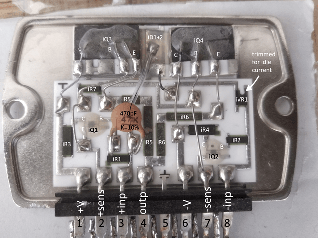

iQ1 and iQ3 are NPN (collectors to +V), iQ2 and iQ4 are PNP (collectors to -V).This appears to be the insides of the module.
I'm not sure if the transistors inside are NPN or PNP or what combination.

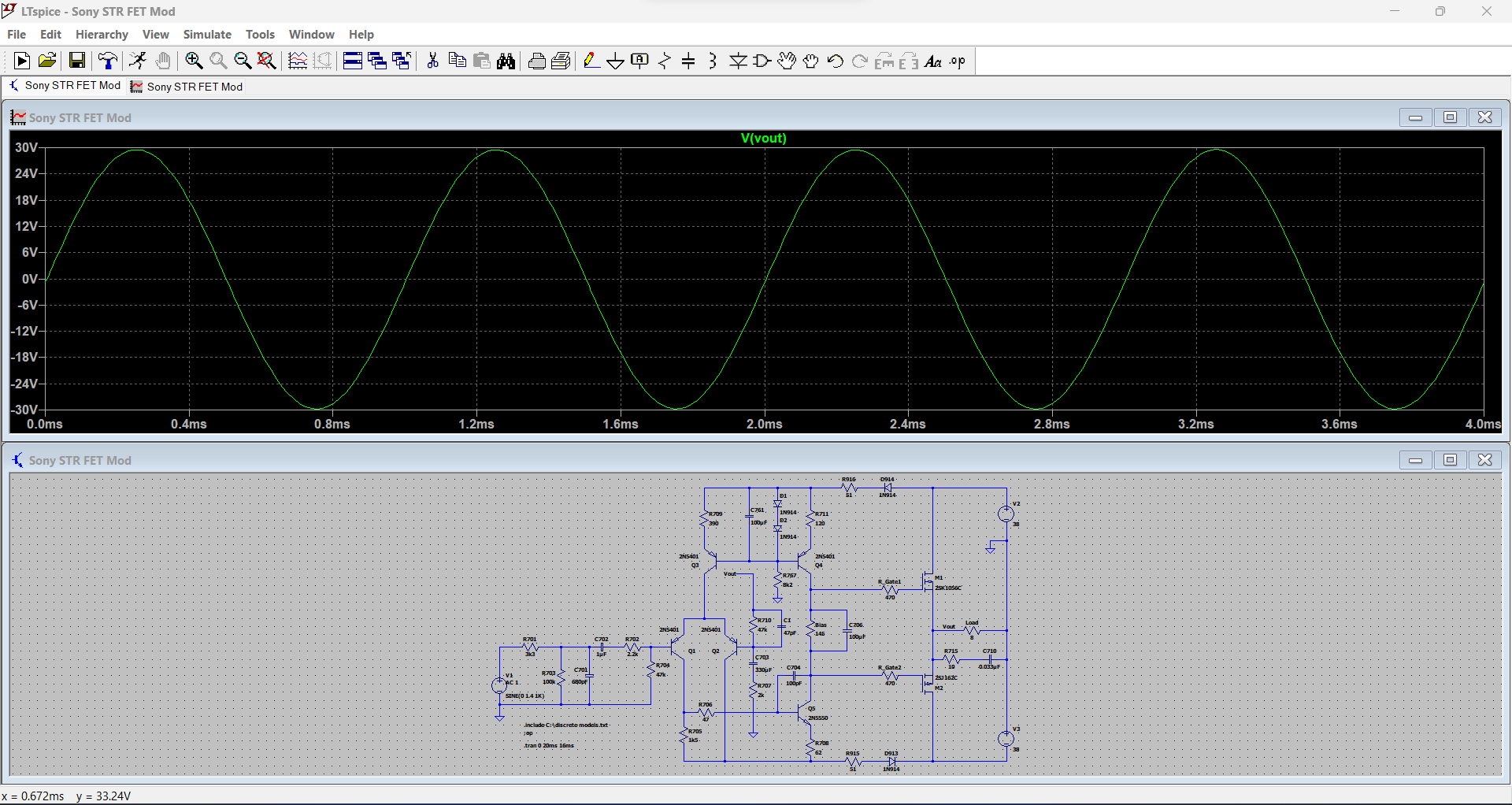

Doodling around... and I think you could replace the whole module with a single pair of FET's if they could be physically mounted OK. Lateral FET's would be the first choice but also the most expensive while common vertical FET's would need a bit more circuitry, not much but enough to make it less of an easy option.
Very nice! 🙂
I need to learn how to use Spice... and no idea if it runs on Linux.
The FET replacement - presumably would need to replace both channels in case the Sony module has different characteristics to the FET replacement?

I've started drawing out the internal schematic of the Sony module, it's a bit rough on paper but will get a Kicad schematic done in next day or two.

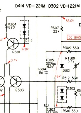

That VD-1221 diode (D701) can be a problem. They are a double diode (two series diodes) and they can and do fail. In simple terms that would allow a massive bias current frying the module. An internal failure in the module could easily fry that resistor.

The connection between the two diodes within its tiny casing breaks, causing an open circuit.
To be replaced by two 1N4148 single diodes in series.

I did some testing this evening of the right channel's STK module and found that pins 8->6 and 8->7 were fine, reading a diode.
Pin 7 -> pin 6 (and also vice versa) reads 0.031v - I assume this is bad. Left channel (which did not have a burnt resistor coming off pin 7) showed both of these as open circuit, as if the internal iQ2 transistor was fine.
I de-soldered Q703 (well, it's Q753, since it's the right channel), as well as Q752, Q754 and they all read properly on DMM diode test across all combinations of pins. And even one of those eBay component testers showed them as transistors (except one, which showed as thyristor, but that was explained away on some other website: https://www.vintage-radio.net/forum/showthread.php?t=194739).
I even tested the VD1222 / 1221 diode, and that also read correctly in diode test / component tester.
So far is seems only damage is C756 (that blew up) and the R763 (coming out of STK module pin 7), and the right channel's STK module.
All other silicon devices nearby read ok on DMM diode test. I didn't check the muting / protector circuitry yet.
