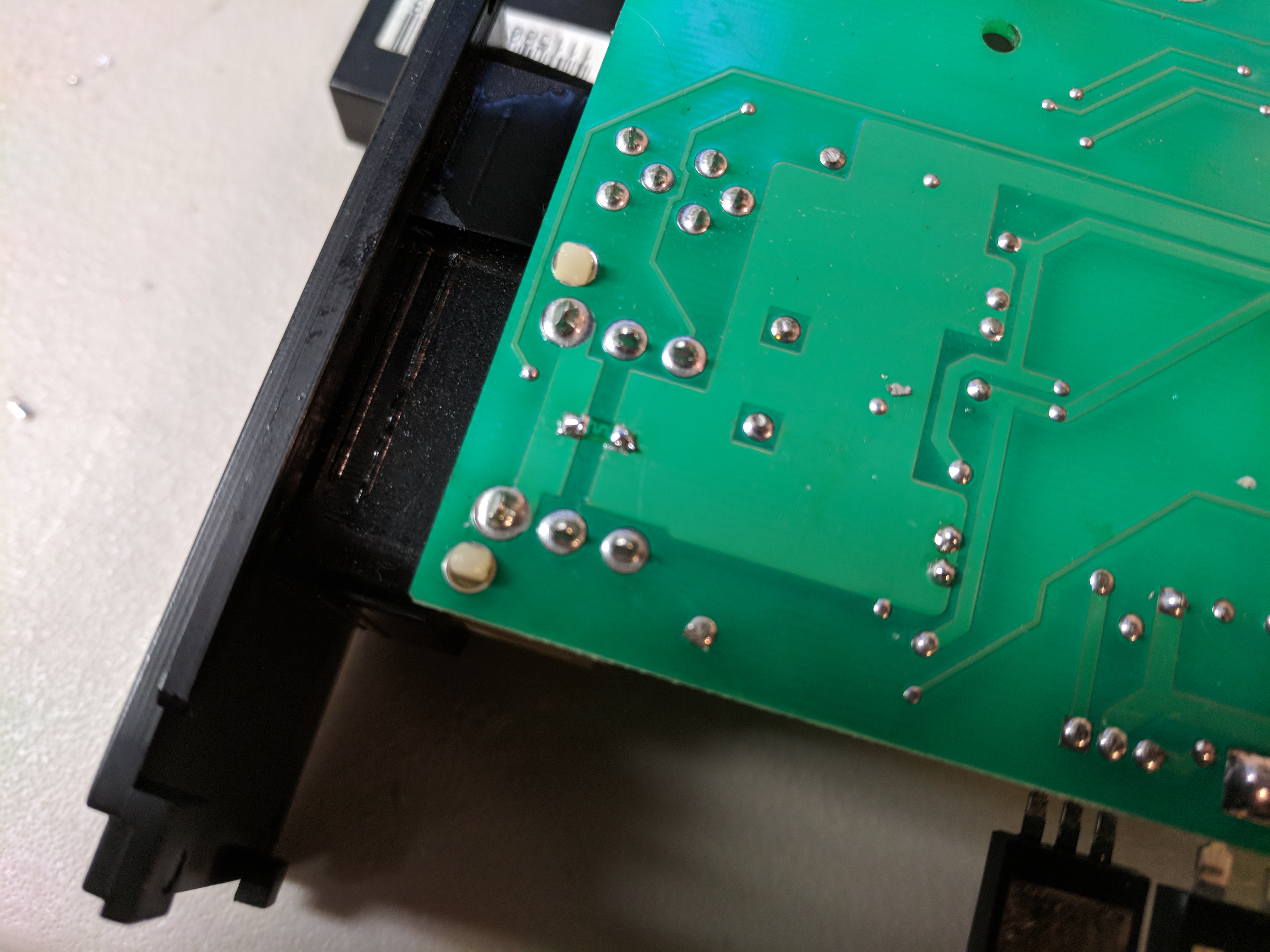

When I opened it up I was greeted with some pretty gnarly work around the RCAs, I've since cleaned it up and revealed a few pads that that I think once held a fuse.

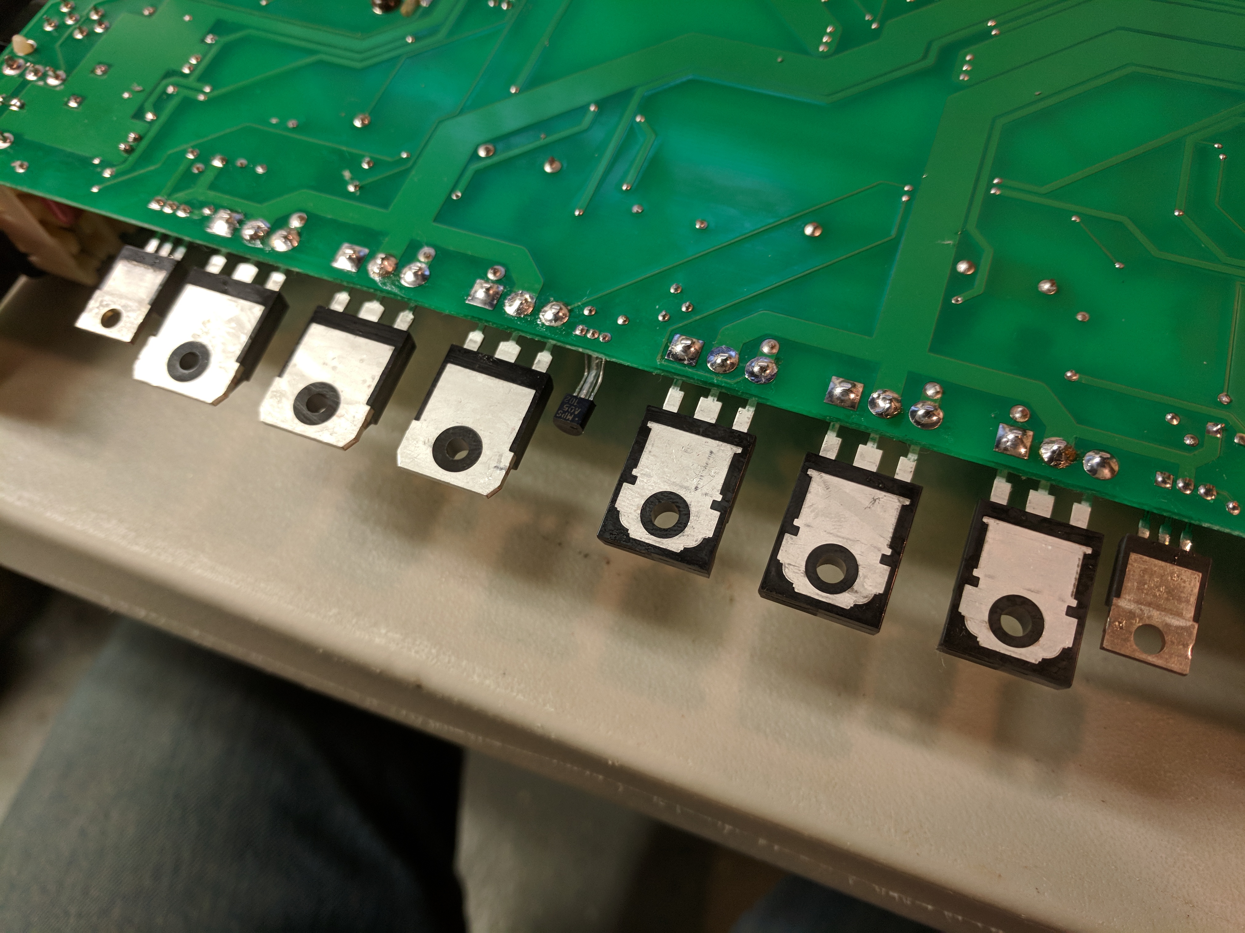

I pulled a few of the suspect TIP35Cs to confirm that the one was shorted

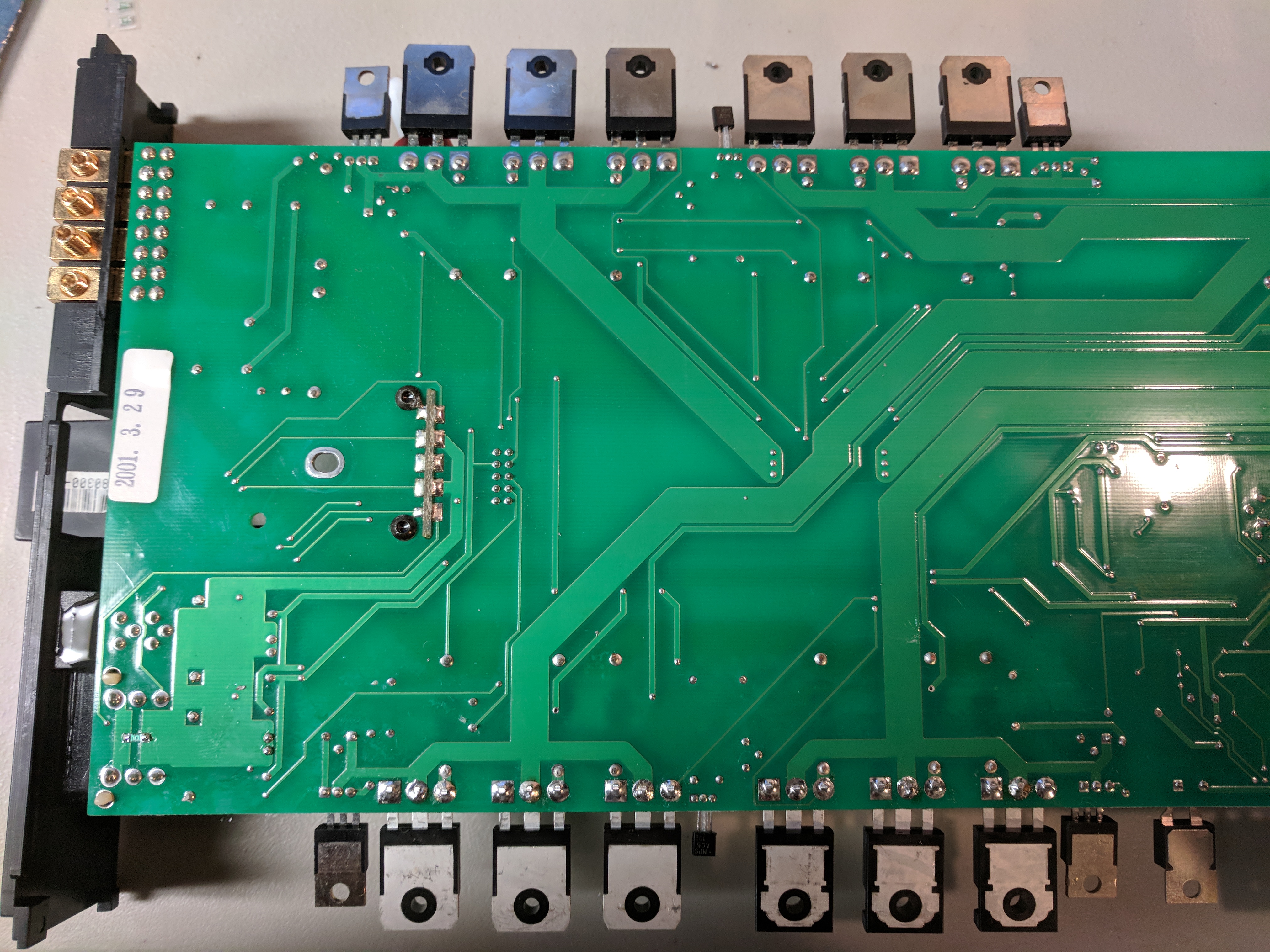

Ok Finally got my webspace sorted out and was able to upload again.

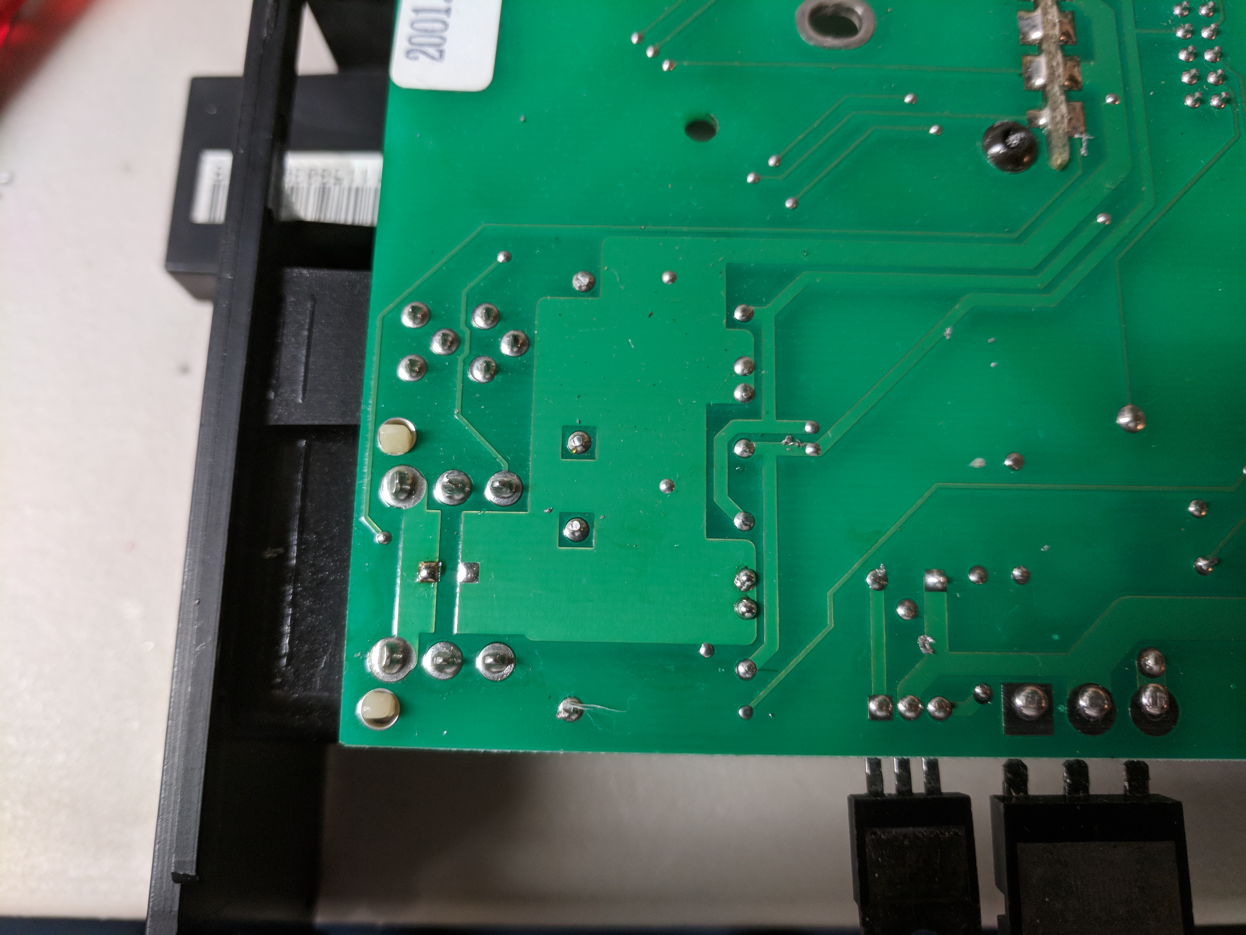

So this is what I was greeted to on the bottom side of the PCB
there was a glob of solder connecting a couple points on the capacitors above. You can see the wire globbed in to replace what I think was a fuse

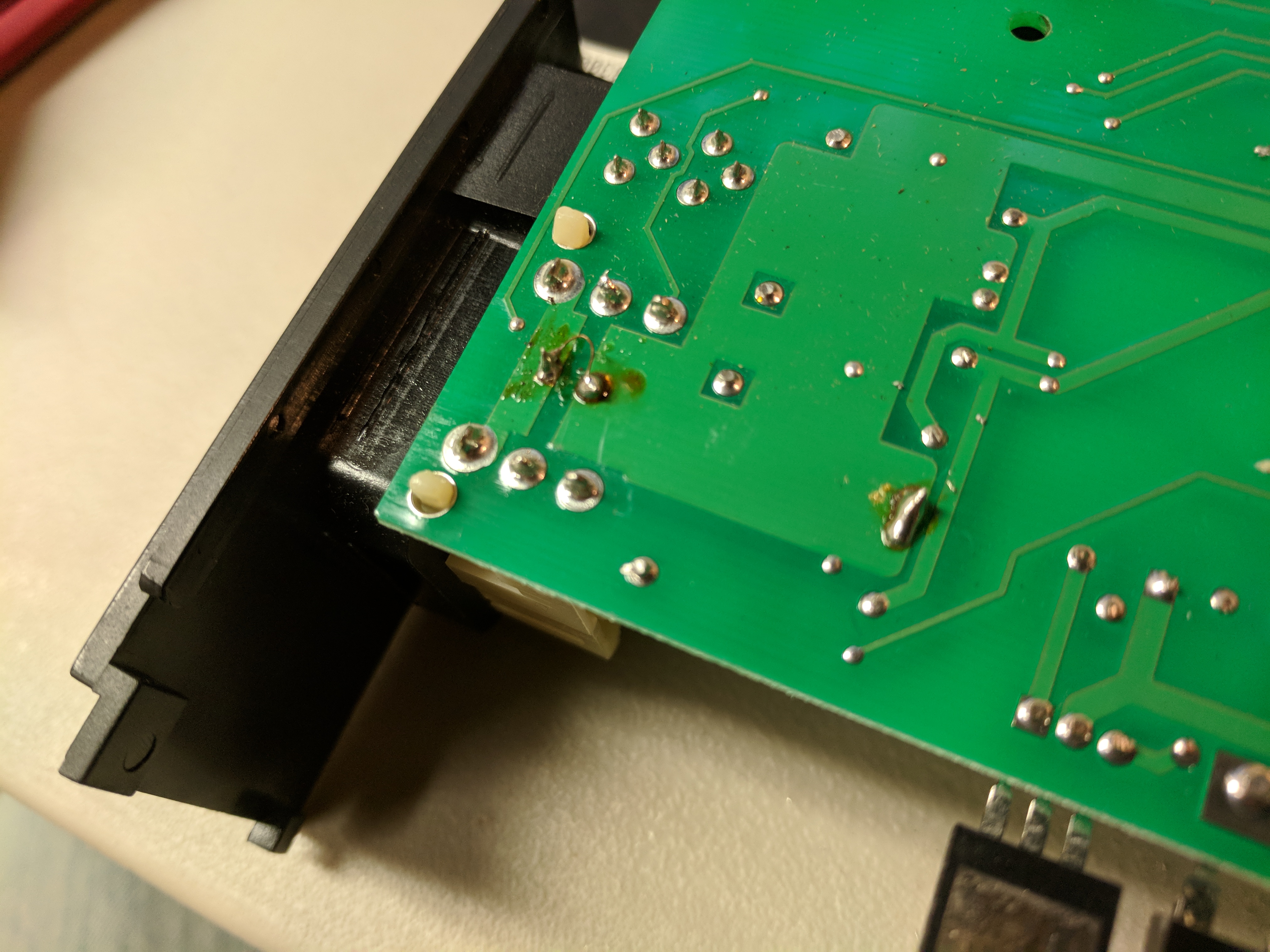

Cleaned up the mess, the solder glob was messy but harmless since they were on the same trace
This is where I think a fuse is supposed to go, on those pads

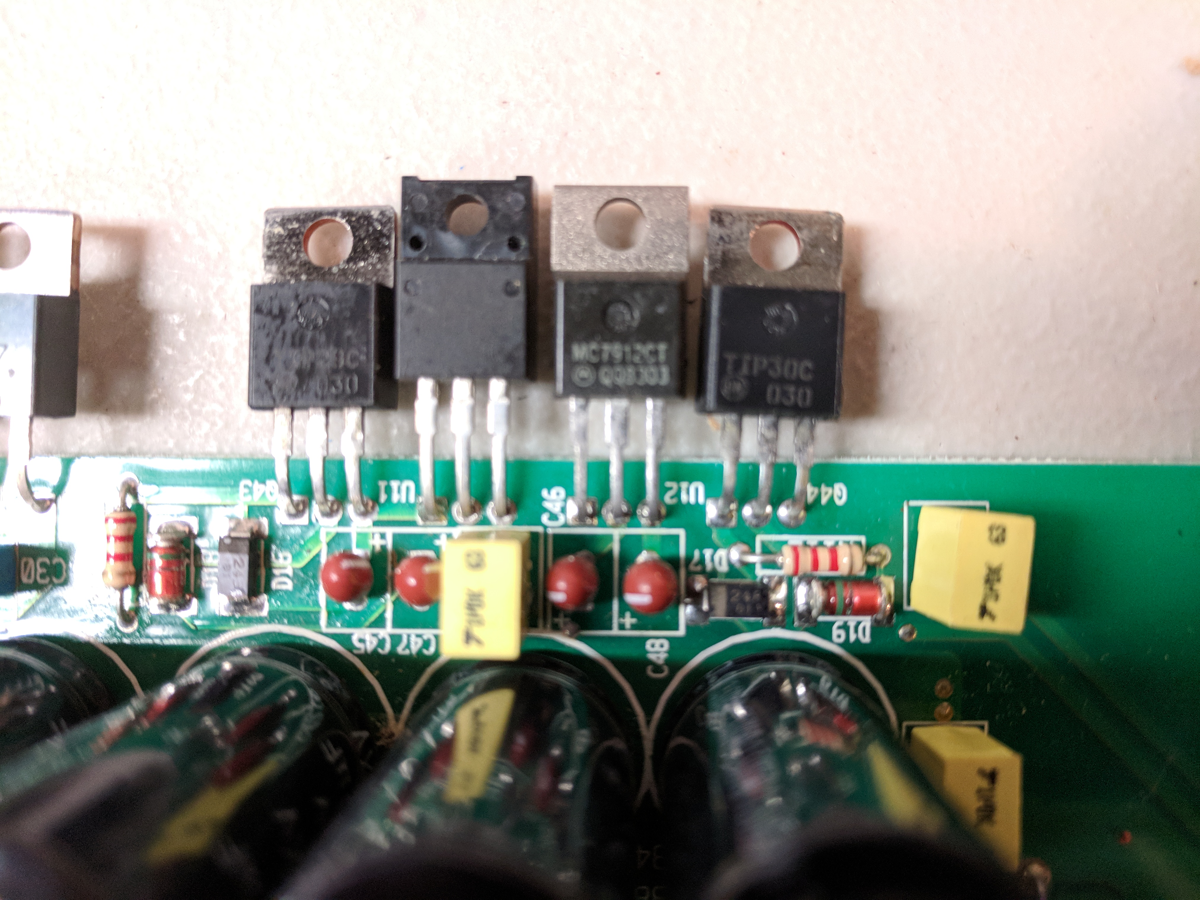

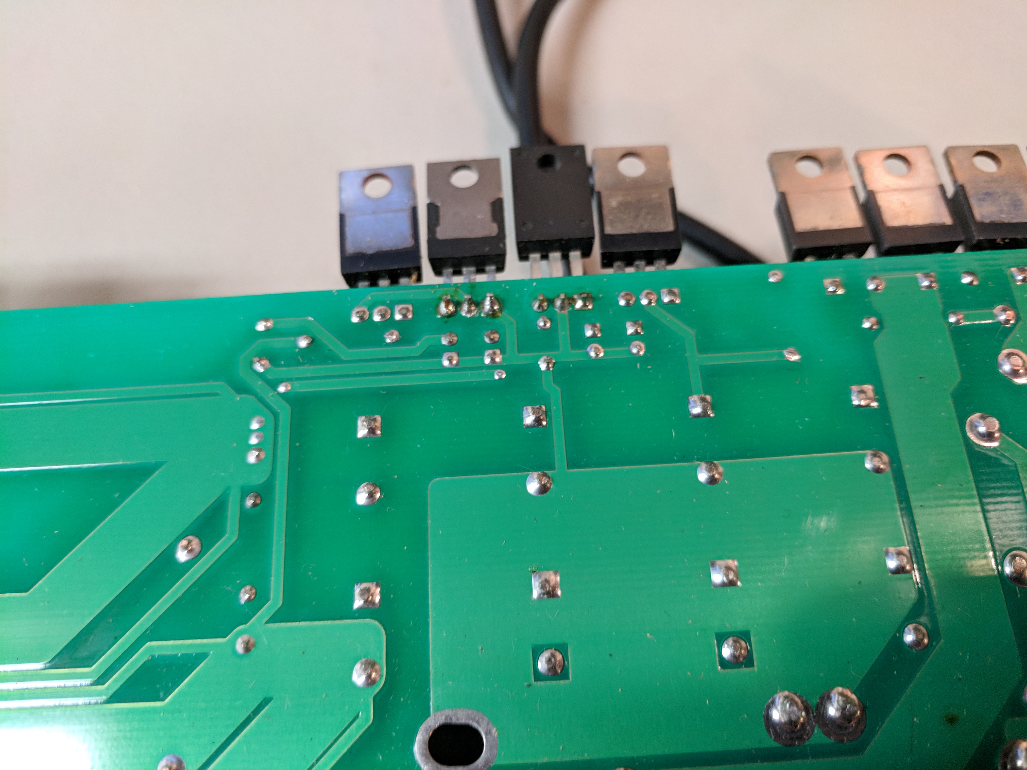

It appears as someone did work here, no idea if these are the original or even correct components

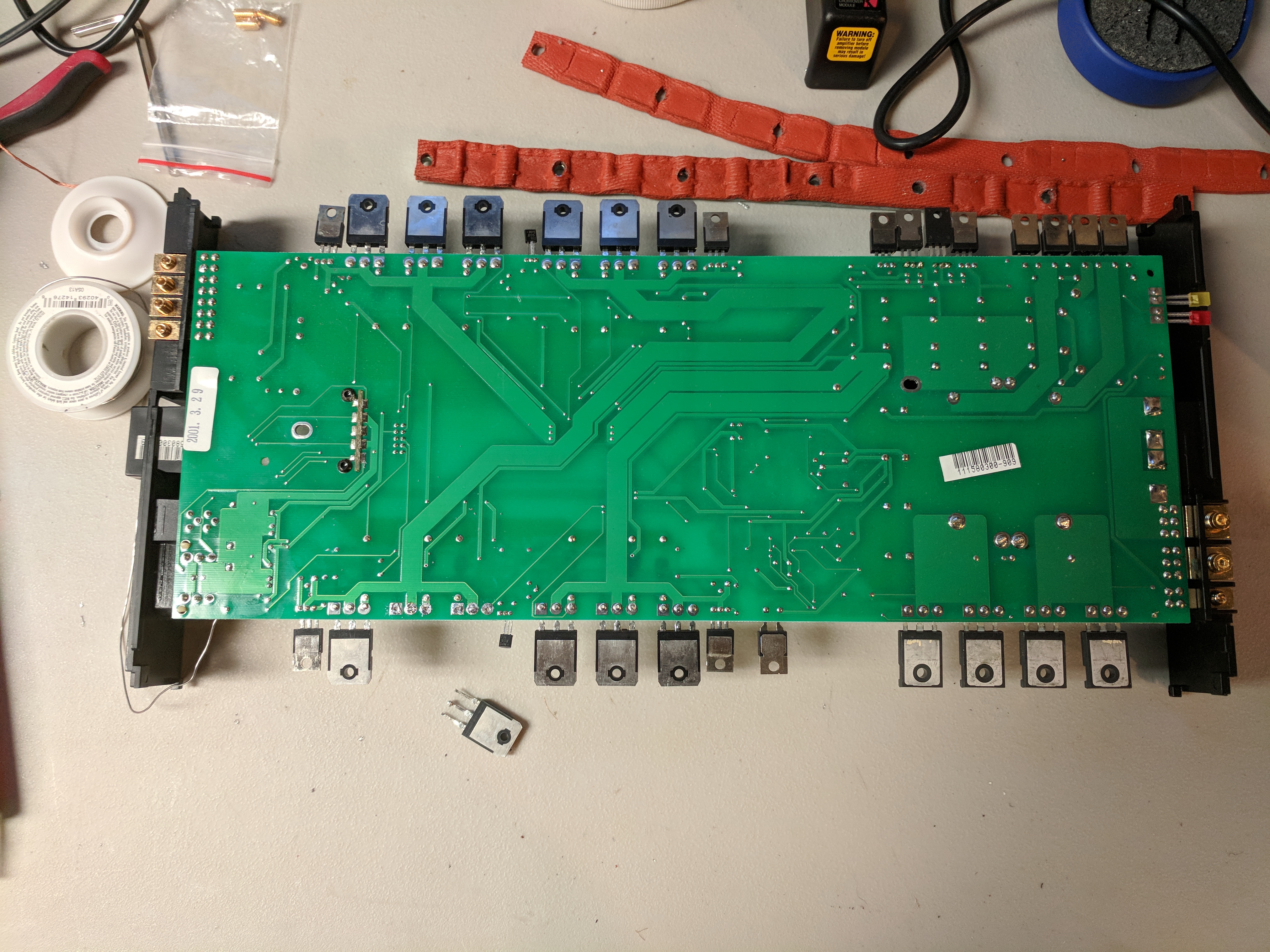

And just a overview of the board with 2 of the TIP35Cs removed. One is dead shorted.
I assume that it did in fact have one, otherwise it was a different type of component that someone fried and bypassed with that wire.
I was thinking it would be something in the 1 amp ballpark. Thank you

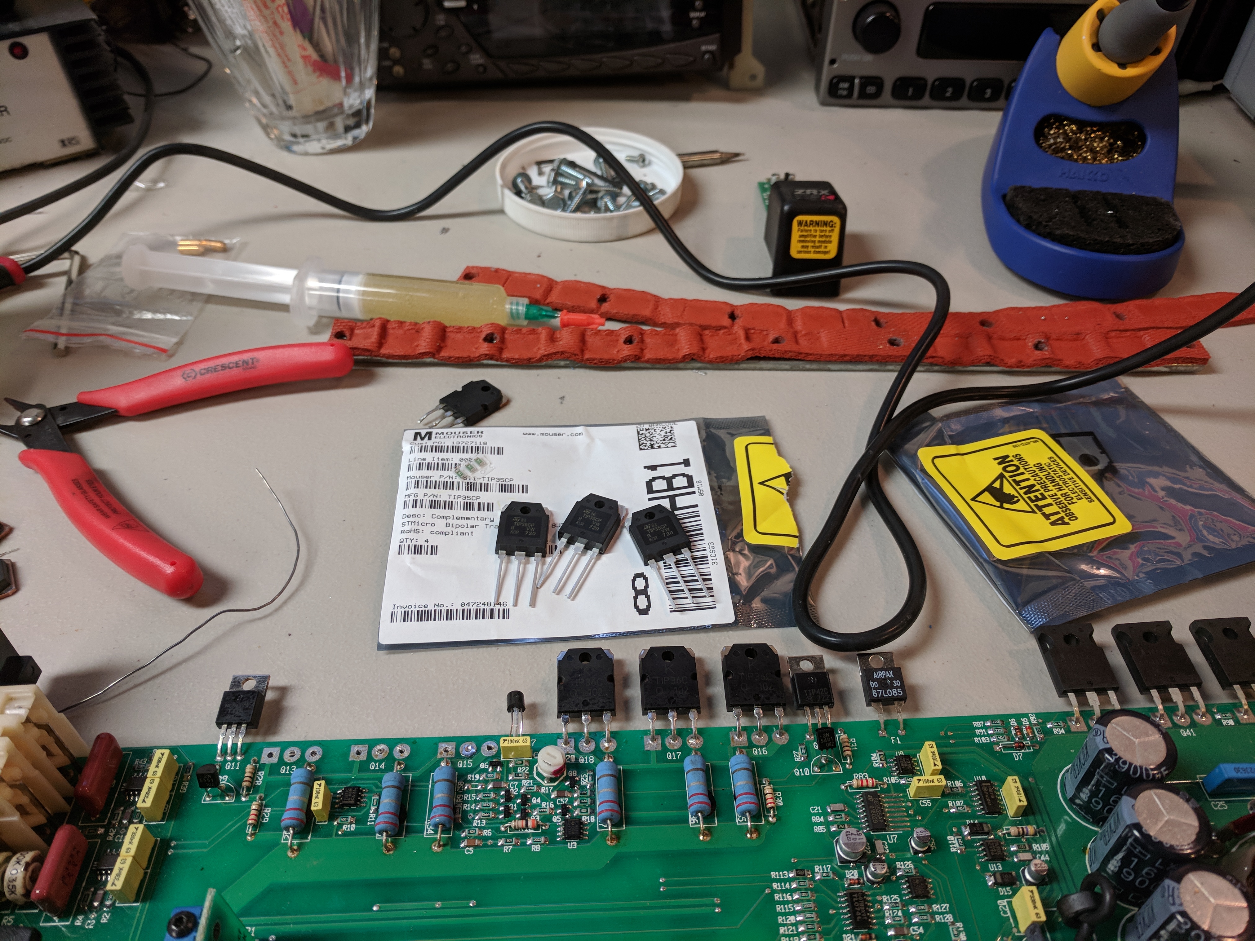

Getting ready to order up components.
Do I need to change the TIP36s tranisitors on the other rail or just the bank of TIP35s?

In this amp, three of the TIP35s and three of the TIP36s make up one channel. I'd replace all outputs (six total) in the channel that failed.
Got all the parts on order from Mouser last night, I'll report back once I get them installed and see what happens. Thank you for the help so far!

Ok, So I got all the parts in the mail today. Installed tonight.
I have to upload pictures soon. I'm pretty happy with how it turned out.
Happy to report that this amplifier is back alive.
