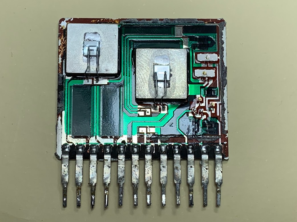

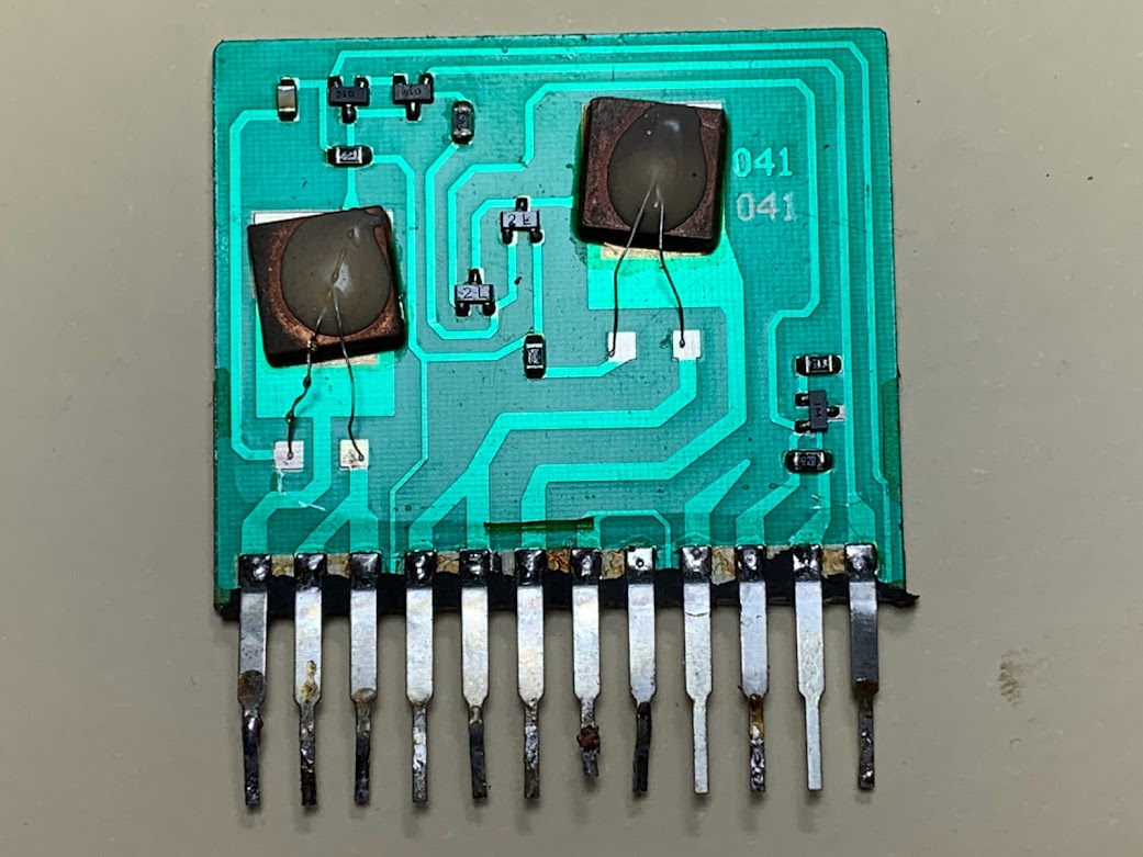

Pictures of the STK1080 II individual channel power amp modules are attached.
Left side original, right one is the new NOS. Broke open quite easy like an egg. The original was more like a walnut, hard to crack.
I can hardly see them supporting 85 watts at 8 ohms...

Those STK copies are pretty bad.

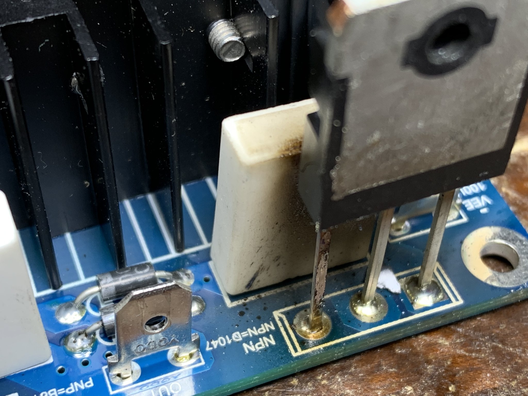

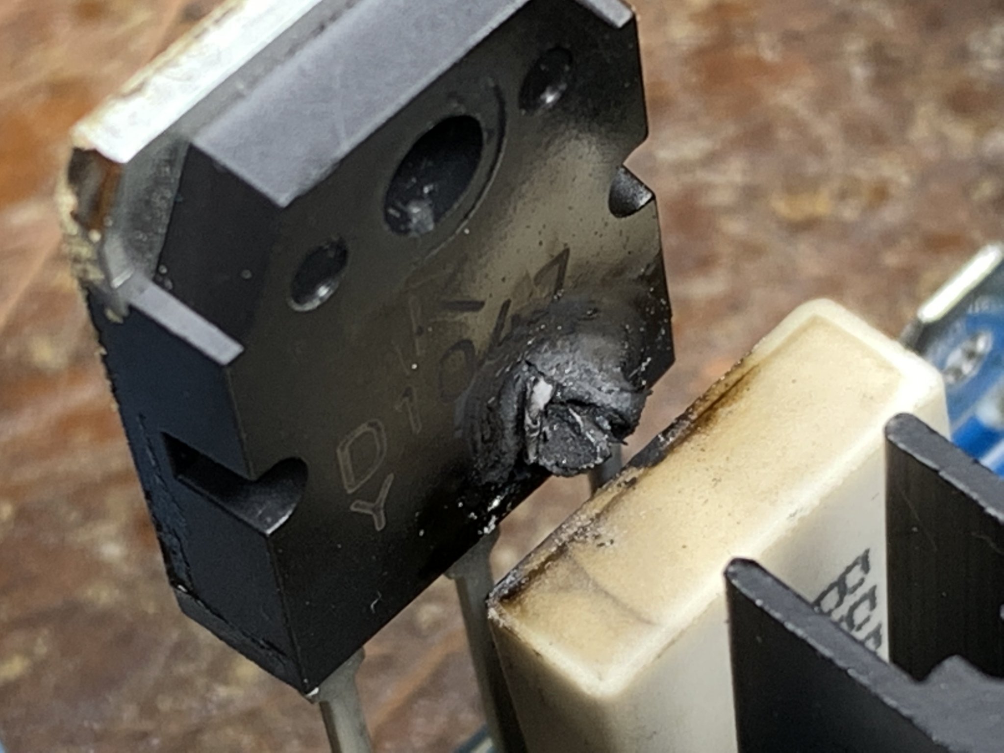

MX50 modules sound very nice. I have built a few, and they sound great for a while. Then they pop. I am using some inexpensive Chinese source. This is with medium effort, nothing crazy. Still think too much voltage for them as they go up to 45 VDC.
Here is my last fail. I have a bunch of extra transistors, so I may replace this one.

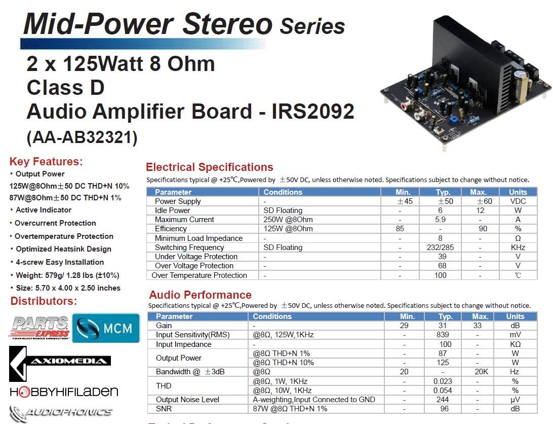

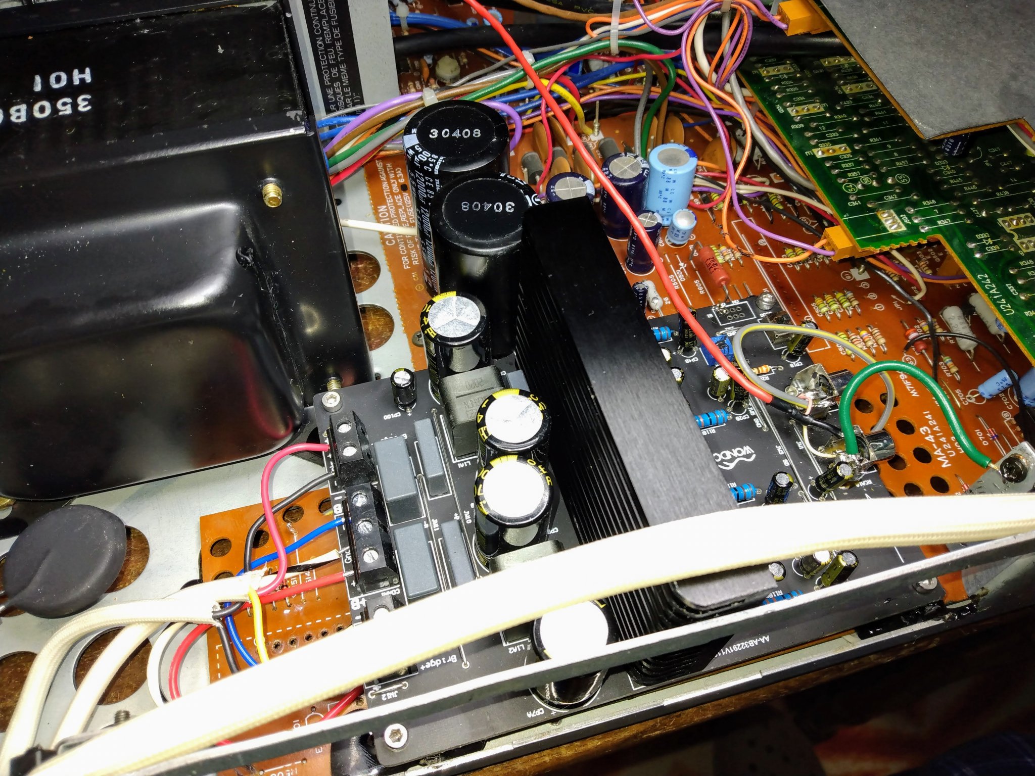

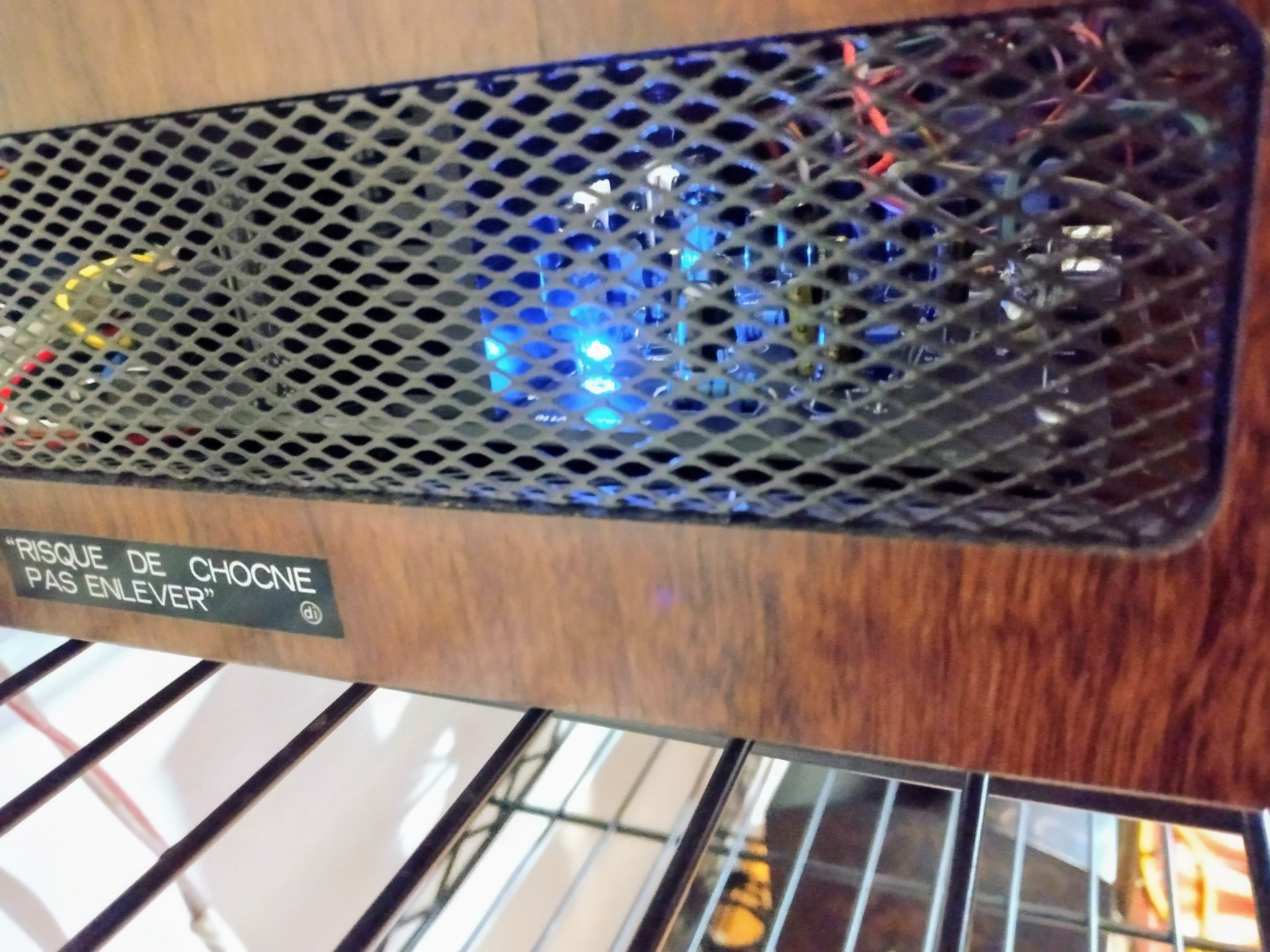

I decided to go with the Wondom amp board 2x125 watts at 8 ohms, just finished early this morning. Had a nasty ground loop to sort out. The amp board is super quiet. Very rich and barely gets warm. It just barely fit, and I had to shave a couple MM on one side of the PCB to clear the large power cap. Except for the ground loop, it was an easy drop in and glue placement after removing all the components that were in the way (in the baggie pic). I did have to add an inrush current limiter, and the speaker protection seemed to like that. It was rushing up to over 100 VDC at power on, triggering the Wondom protection for a second. There are some evident cost-cutting measures on this unit, it could benefit from bleeder resistors and the additional capacitance made the current limiting necessary. These are nice big-box receiver sleeper units worth restoring, specially since they do not fetch in the Sansui 9090DB price, but give you just as good sound. I was able to restore the other 35 to original with spare parts from this one and a new genuine voltage amplifier IC. I will post pics of that later if anyone is interested. Here are pics of this project, and I hope someone finds this info of use in the future. As you will note in the PCB picture, some past repair tech had worn the traces down with heat and I finished them off. No chance it could have remained original.
