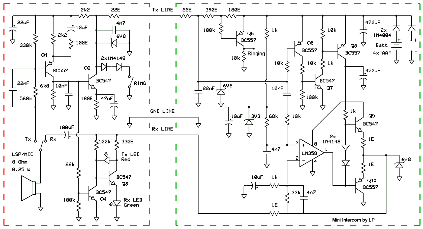

I would like to build a 4 or 5 station in-house intercom. I've searched for a "not too complex and yet promising" circuit, but nothing really miraculous popped out.
So far only two designs seem to match my criteria:
I'm still open to any other suggestions of some better designs, if you would be willing to share them.

There probably have been some similar discussions, but still...

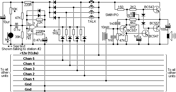

- The one from here. A good thing would be the absence of microphones, so no parasitic feedbacks or ringing could occur (maybe); it uses just one power supply; it uses just three wires for each station. But it "talks" to all stations simultaneously, which is not desirable.
- The one from here (the middle of the page). A good thing is the common power supply and the fact, that the stations are independent. But it uses many wires for each station (number of stations + two), and it may be problematic to get rid of microphone ringing at some specific situations.

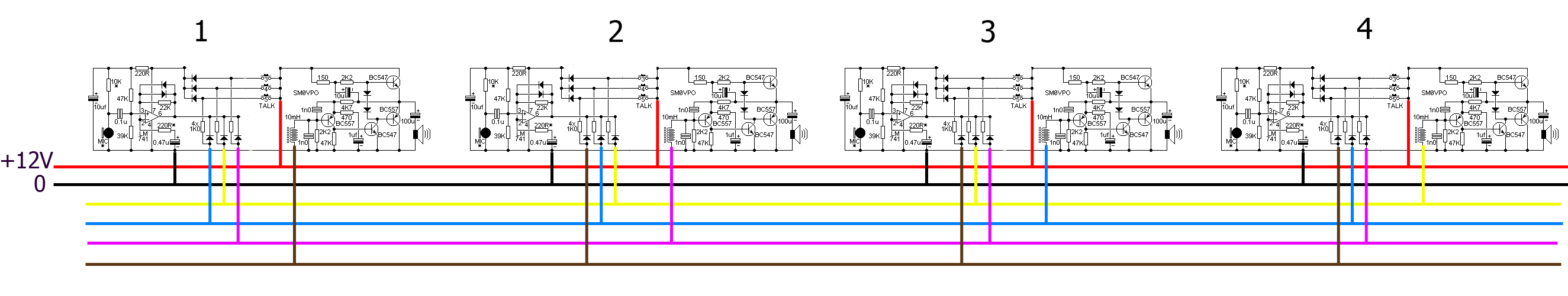

Hello again!
There just had to be some problem in all this, because it worked so well at the testing stage
So, after a successful two-station testing, I made all four of them and connected together as seen in Intercom_.gif. But all I got was nothing, except some clicking sound, when pressing corresponding buttons.
Can you, please, take a look at all this and try to find a cause for this problem? I really would like to make it work as it should.
Thank you.
Hello again!
Thank you.
