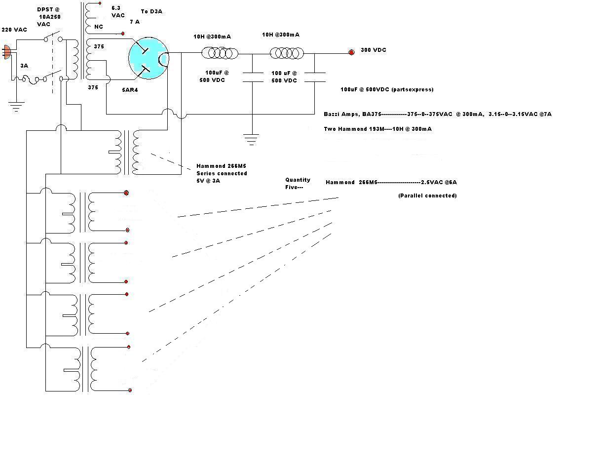

Ok...Heres' the rub,getting everything situated but my only MFG of transformers "in country" is not responding to my E-mails...& there is no Telephone#.
Perhaps if all that read this & you ask the simple question. "how much is your BA-375 power Transformer?" If everyone who reads this shoots an E-mail to this guy...you know a dozen different languages...he might respond when he sees the are fifty E-mails & oddly they all appear to say the same thing....but differing languages? HERE....:: Bazzi Amplifiers ::.
Heres' the finalized version...derived from the JE Labs schematics.
