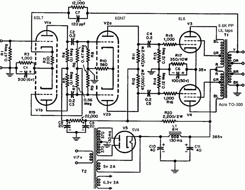

Hello,
I just bought a Heathkit IP-17 power supply, its output is 0-400VDC at 100mA, 125mA max. The schematic is here: http://www.mcmlv.org/Archive/TestEquipment/IP17.pdf
Can anyone suggest a good tube amplifier to go with this power supply?
I was thinking about the amp below, is it OK?
This schematic will be drawing about 80mA per channel, a bit much for your power supply. Assuming you are building a stereo amp, I wouldn't go above 110mA total...
However have you considered a stereo SET amp, say a 6B4G or 2A3?
